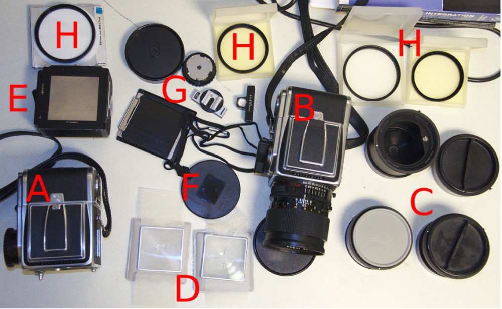

Here is a picture of the whole package:
500 C/M + back
B
2000FCW + Carl Zeiss Planar 110mm 2.8+ back
C
"Extension tube" 56, 32, 16, 8
Focusing Screens
E
Extra Back (serial RP 3228649) with a label saying AB, not sure if that means anything.
F
X606 Color 4x5 View Fitler
G
Flash mount
Level mount
Metal plate
and other things I cannot name
Hasselblad filters (left to right):
HZ 70mm
UV-SKY (1A) 60mm
70 to 77mm adapter
UV-SKY (1A) 60mm
I can take close up picture of the lens and camera upon your needs.
