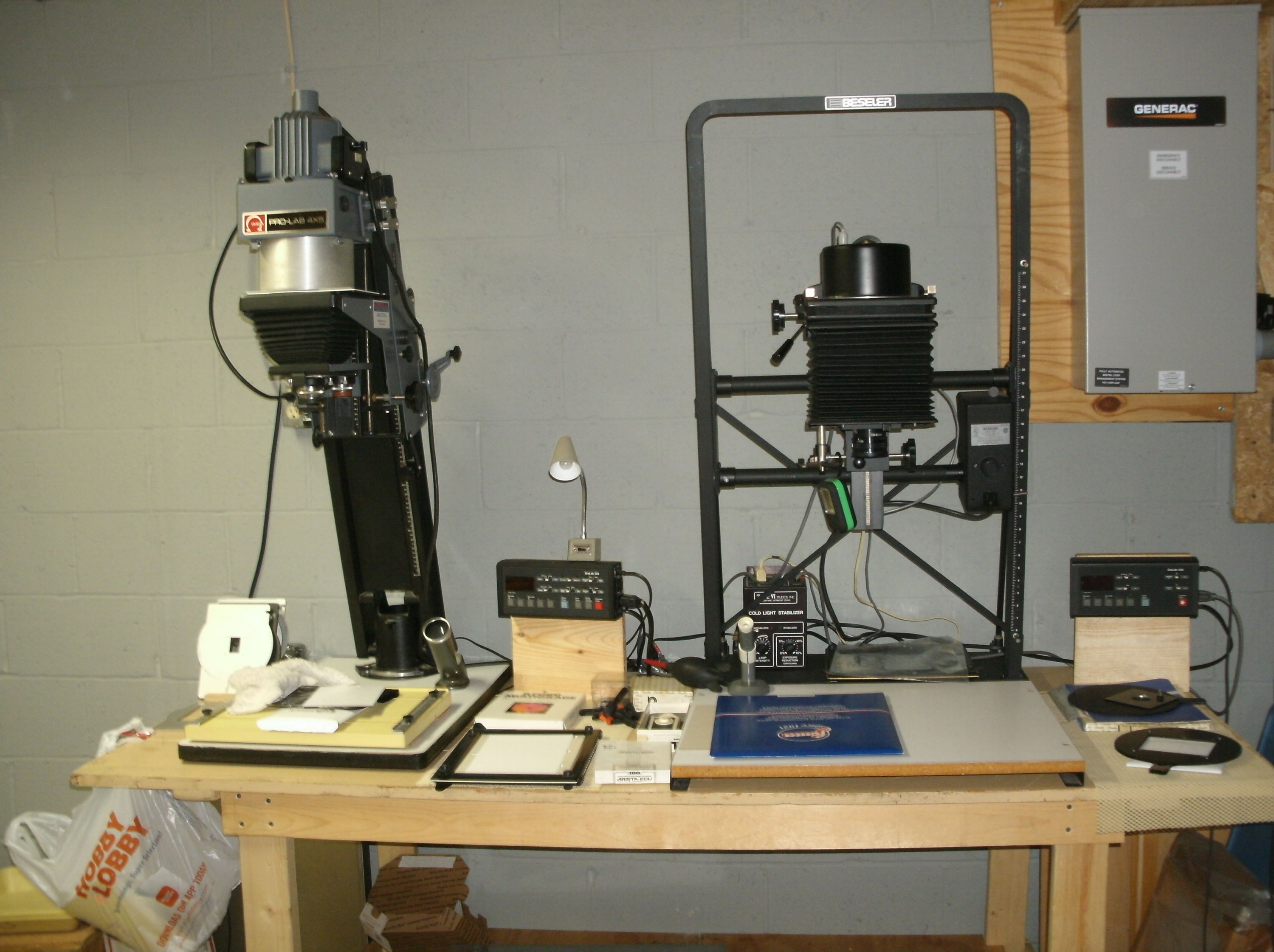

Since my enlargers are sitting on a wood base and the columns are not supported at the top (like maybe the should), there can be some vibration when touching the counter top, so I like to use a foot pedal to activate the timer.
I never attached the support brackets at the top of the column because I like to move the enlargers around as needed.
Anyway, I just got a second foot pedal assembly, so each enlarger workstation has its own pedal.
These are hard to find because the prongs are different than the commonly available Omega pedals. The FOCUS and EXPOSE pedals are also reversed from the more commonly available one.

In the time before I had foot pedals I kept my timers away from the enlarger, either on the wall or mounted on a shelf beside them so I didn't disturb my enlarger. I still wait a few seconds after setting up a print before I expose to let any vibrations die down.

I was always curious why Omega made the baseboards on the top-of-the line enlargers like the Pro-Lab and D5500 so small. I think the D5500 baseboard is a little bigger, but as you can see my 16x20 easel still overlaps quite a few inches on both sides. These Omega XL enlargers will project to 20x24 on the baseboard.
I think it varied. My older version of the D6 had a massive baseboard - 36 inches long, 20 inches (IIRC) wide and 2.5 inches thick.

Well, and I thought I was just saving the limited space near my enlarger (it sits on a kitchen cart with a top barely as big as the D2 baseboard) when I mounted my timer on the wall. Hadn't even thought about vibration in the enlarger and cart. I'd still like to get a foot pedal; it'd be a lot easier to turn the lamp on and off for burning if I don't need to free a hand (and turn my head to see the timer) to operate the switches.

My Philips does not have a foot pedal option. Using the grain magnifier and tapping on the table, I could clearly see that one vibrated more than the Omegas, so I did construct a brace for the top of the column. That worked wonders.
Most Omega enlargers I've worked with were mounted straight to the countertop, often with a drop-bed recess for making larger prints. I think Omega kind of expected the pros to ditch the small baseboards and come up with other mounting solutions.
I'm a footswitch addict as well. I use simple GraLab digital timers (450s I think) with just a simple on/off footswitch for exposing. I have the timers wall-mounted so I can hit the "focus" controls by hand. Timers are set to 99 seconds and I use the metronome function to time prints. "Off" is either with a card under the lens or, for longer exposures, with the footswitch. The footswitch is really handy for burning when both hands are needed; couldn't live without it.
Yes, the thickness really helps. One of my Omegas came with a home made baseboard and it was horrible. I did find a new, correct baseboard on ebay about ten years ago, and there was a real improvement in stability.
I found big prints can still be an issue. Omega widened D5500 baseboard from 20" to 22" but my 16x20 easel is 27" across and my 20x24 easel is 30" across.
By comparison the Devere 4x5 enlarger (504) came standard with a 24" baseboard and had an optional massive 42" baseboard!
And, of course the Beseler is right up there with its 25" baseboard as Rick A showed above.
