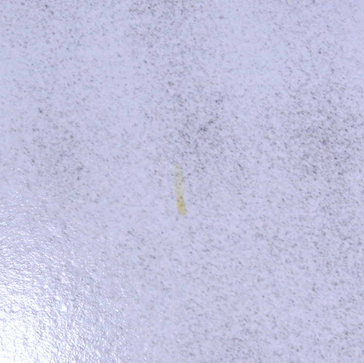

Hi,
need help.
I made a print send it to the US (I am in Germany) now there a yellow spot on the print.
Does anybody know what it could be. Or is there a way to get rid of it?

This is Ilford FB paper, wet mounted on aluminium. I suppose it is about 3-5 mm long.
I was thinking about trying to remove it with alcohol or distilled water.

I've seen similar when a print is dried, face down, on a contaminated screen. Usually, though, it will be a cross-hatch stain. Sorry I can't be more helpful.

Try refixing it for longer and washing it for longer.

Was the package opened by customs? It looks slightly like the mark from one of the "pens" containing a detector solution for some sort of contraband. There have been many instances of all sorts of innocent materials being soaked in solutions of a drug, dried out, shipped and then washed again to retrieve the illicit material.
Unfortunately, if that's the case, time to make another print I think.

It's colloidal silver/sulphur issue and an artefact from inadequate fixing/washing. Books say treat with a Permanganate blech, but I think it's better to just reprint.

Thanks all, I can't reprint it.
It is in Georgia, USA and I am in Berlin. The print is 220x120cm large so nothing can be done quickly.
I am sure it was fixed well and washed well.
The restorers in the museum are checking into it.
For me it looks like a drop of coffee, like someone told me maybe the customs guy inspecting it was drinking coffee at the time.
That would actually be rather funny.

1,103
