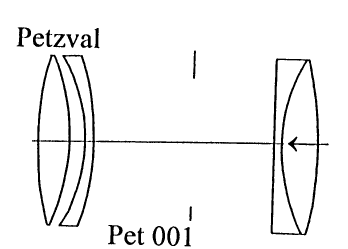

Vitax Portrait f3.8 10-13.5in, then 16, 20in. This was a Petzval type lens. It had softness
adjustment and the field was rather curved. It was listed in 1914. There were conversion lenses for 20in lens to
16in, about 4.125in dia.
Vesta Portrait f5.0 6.0, 7.0, 10, 11.5, 14in This was another Petzval, rather like Vitax, but
slower and without the softness adjustment. It could be used as a long lens for big heads by removing the rear
cell and fitting the front meniscus lens reversed at the back- this was not an uncommon feature, but not all
makes had the threads the same to allow it.
