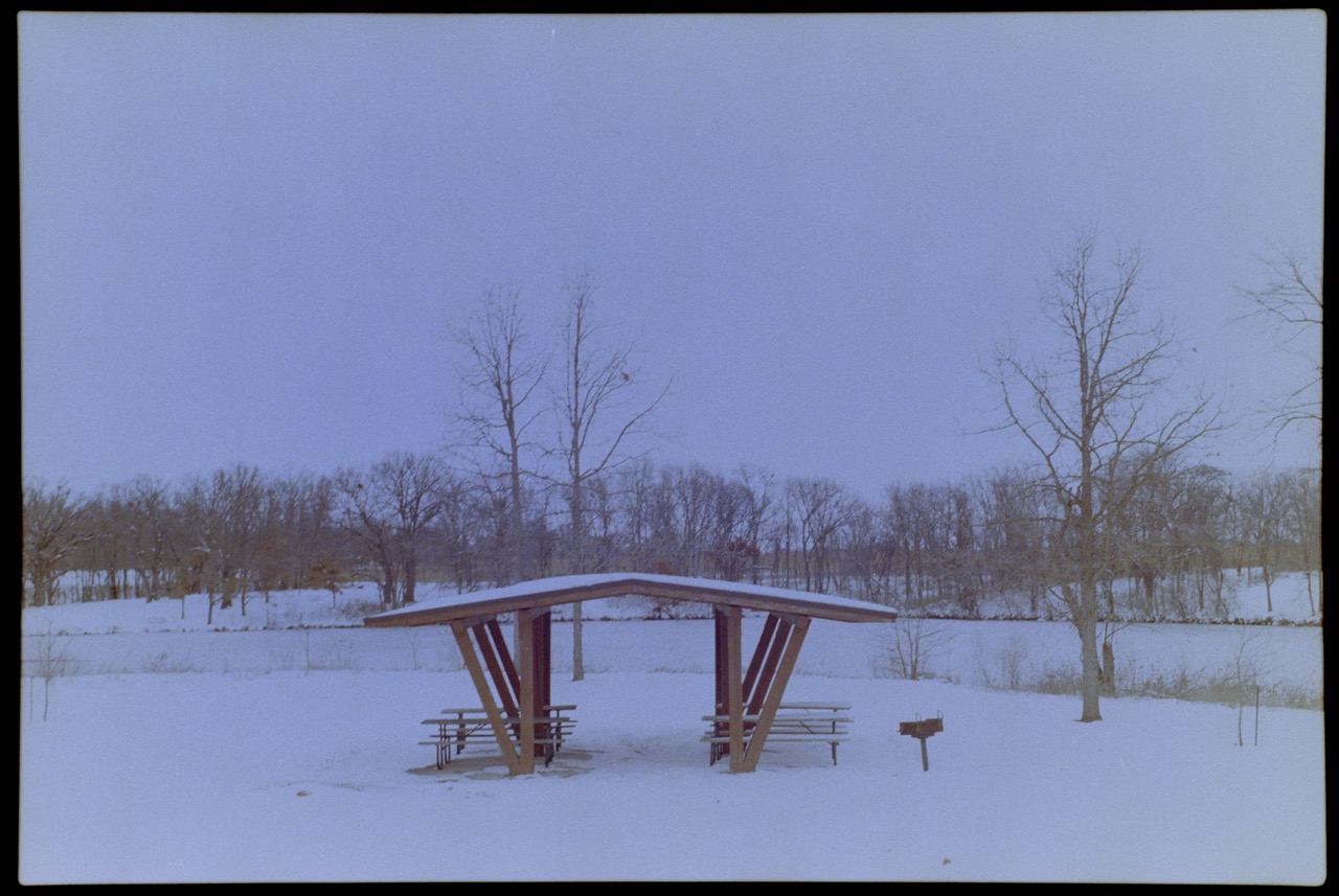

Greetings, I am new here to Photrio. I am also new to developing my own 35mm film at home. I have so far processed about 10 rolls.
I've often come across a problem where-- after digitizing the pictures-- I can see the edges (particularly the left and right edges) are more washed out than the center of the image. Here's an example picture (Kodak Gold 200).
I could certainly fix it in my photo editor but I'd like to know if this is normal or if it's a timing issue with the chemistry. Or if my scanning process has a light bleed at the edge. The edge washout is present is nearly every photo.

The problem is in the scanning/digitization process.
Keep in mind that the frames on 35mm full frame 24x36mm are sitting side by side with the short ends adjacent to each other. The development process can never, ever create density differences consistently along those frame edges. The only two things that 'know' about the frame edges are the original taking camera and the digitization/scanning process. The original camera is pretty much off the hook on this one since there's no typical light leak scenario that will produce this kind of defect; note that it's also present at the top edge of the frame shown. On the other hand, light falloff on the setup used in 'camera scanning' is a sure-fire way to get exactly this result, making that the plausible cause.

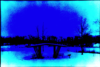

At first glace I thought the shape would be too complex, but on closer scrutiny, a simple vignette should indeed work just fine:
@IMoL thanks for confirming the issue with this particular light source and offering a workaround!
One thing I have noticed with the Valoi Easy 35 in particular is that the needed vignette is not exactly centered. Your image "enhancement" shows it quite well. Easy enough to do in Photoshop.

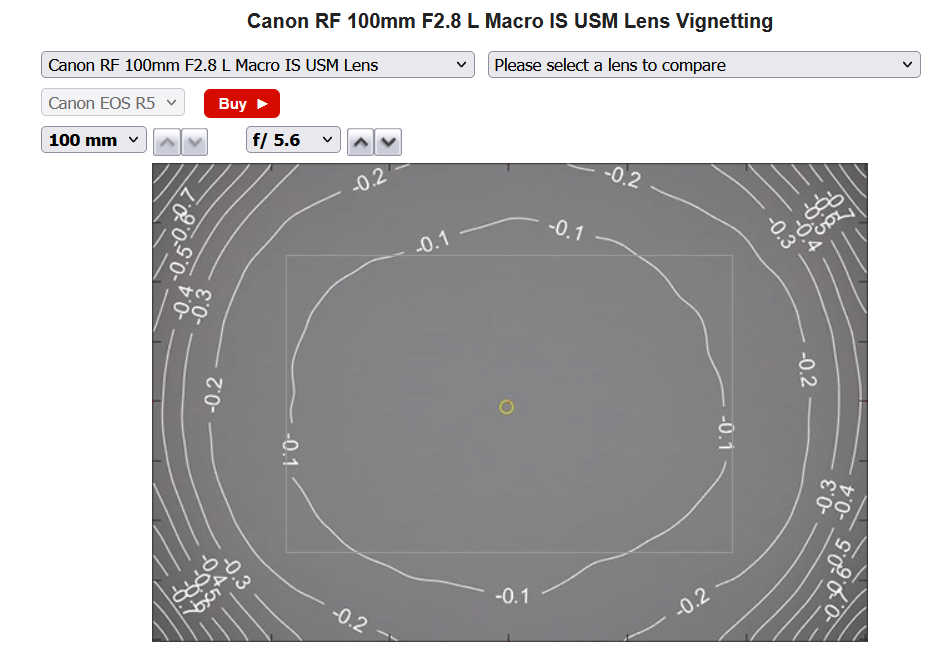

That does look similar to this:
Maybe it is just (or also) vignetting from the lens.
That's a thought, too.
