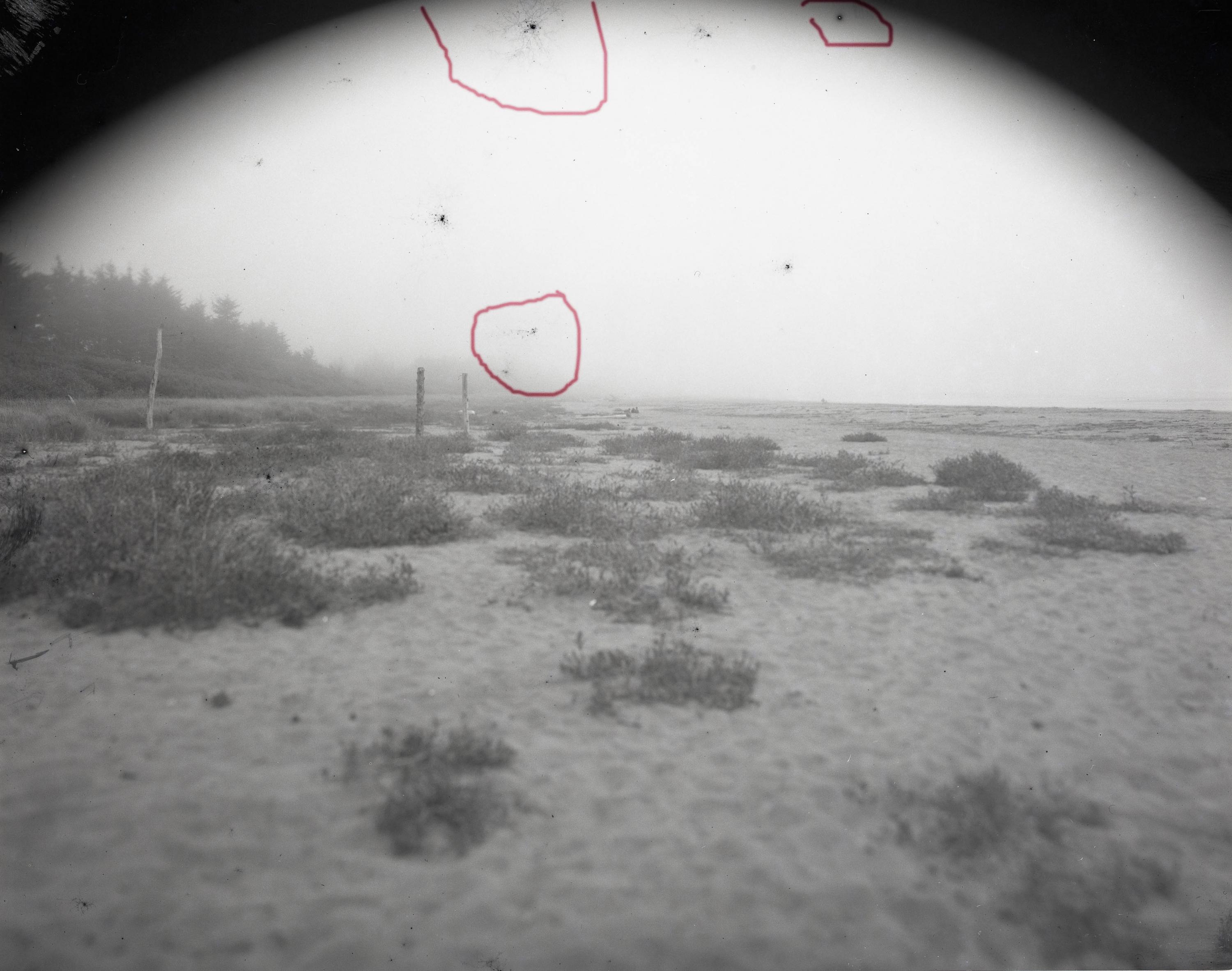

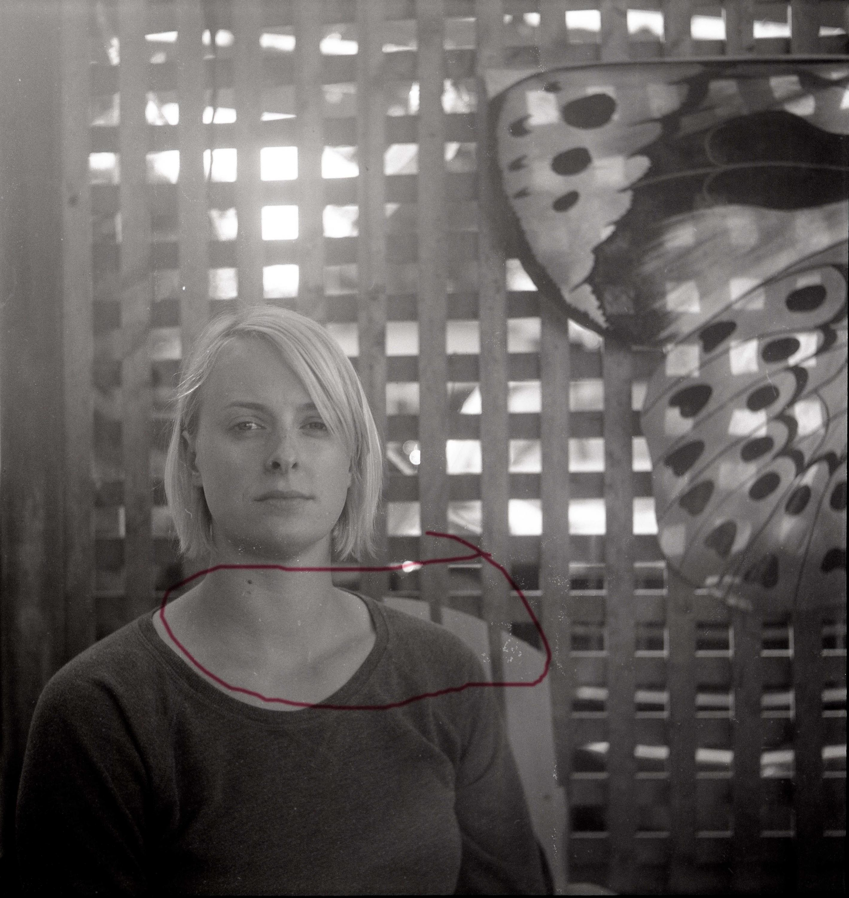

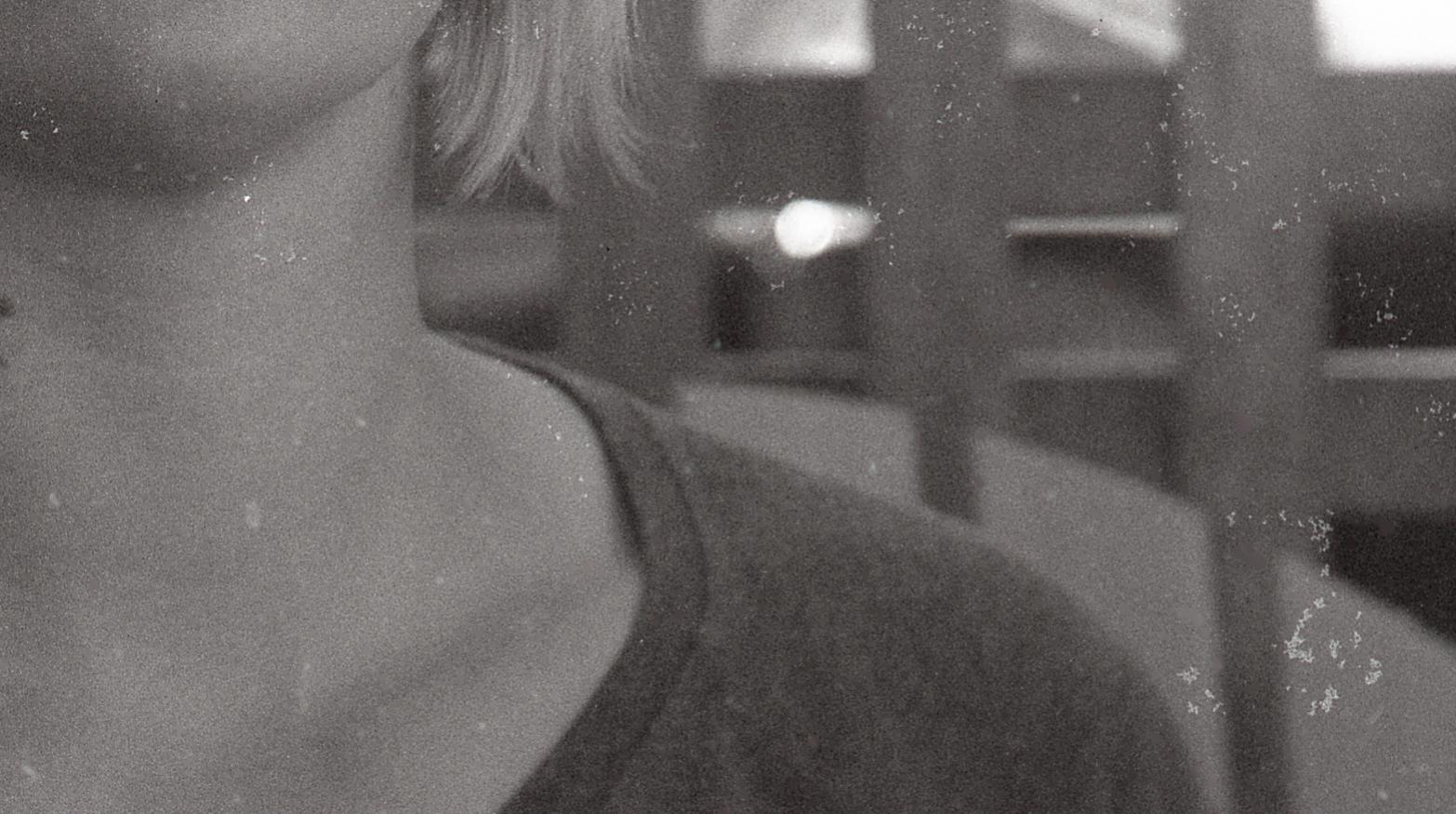

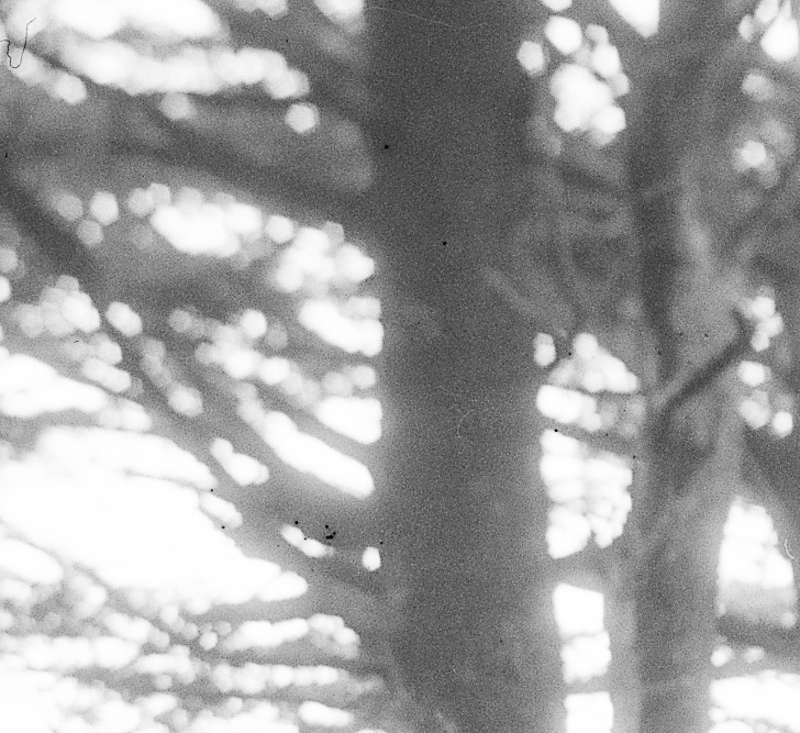

The first is with some dark speckling (light in the print/scan) that appeared on a number of frames (I believe from different rolls, though I'd have to dig into the archives to check because this was actually a little while ago). PanF in Rodinal, fixed with eco-Pro
Development Problems-6.jpg Development Problems-7.jpg Development Problems-10.jpg Development Problems-11.jpg

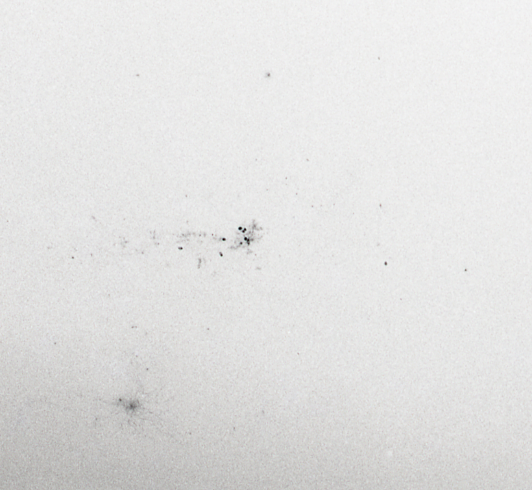

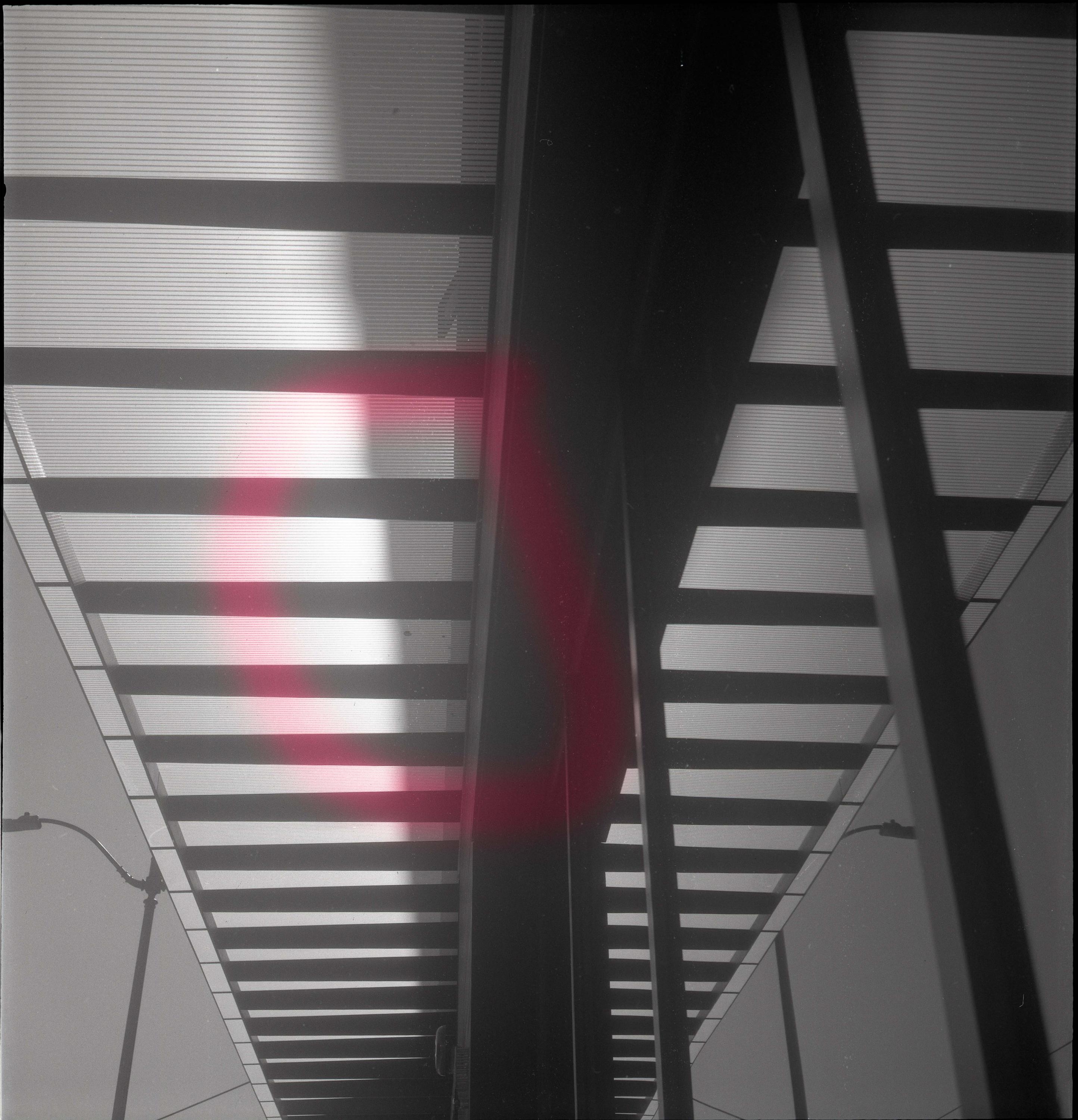

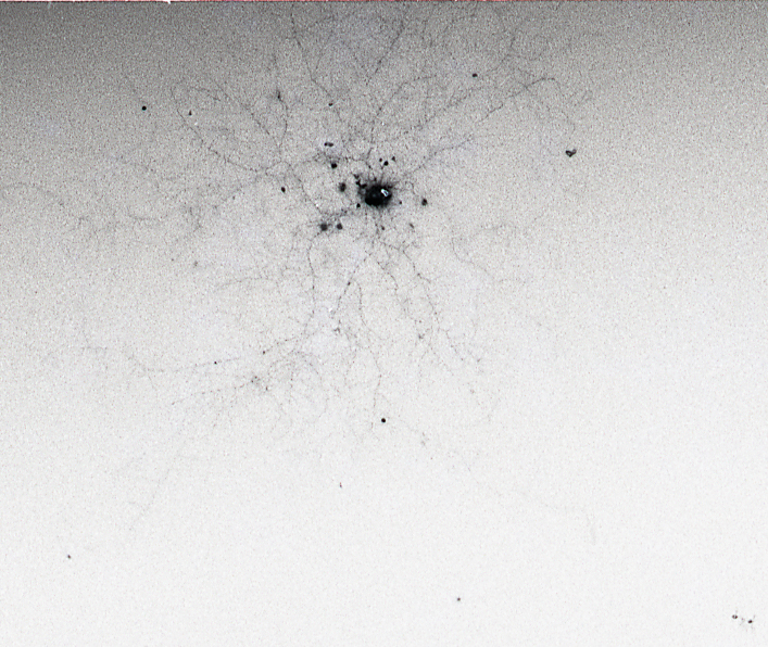

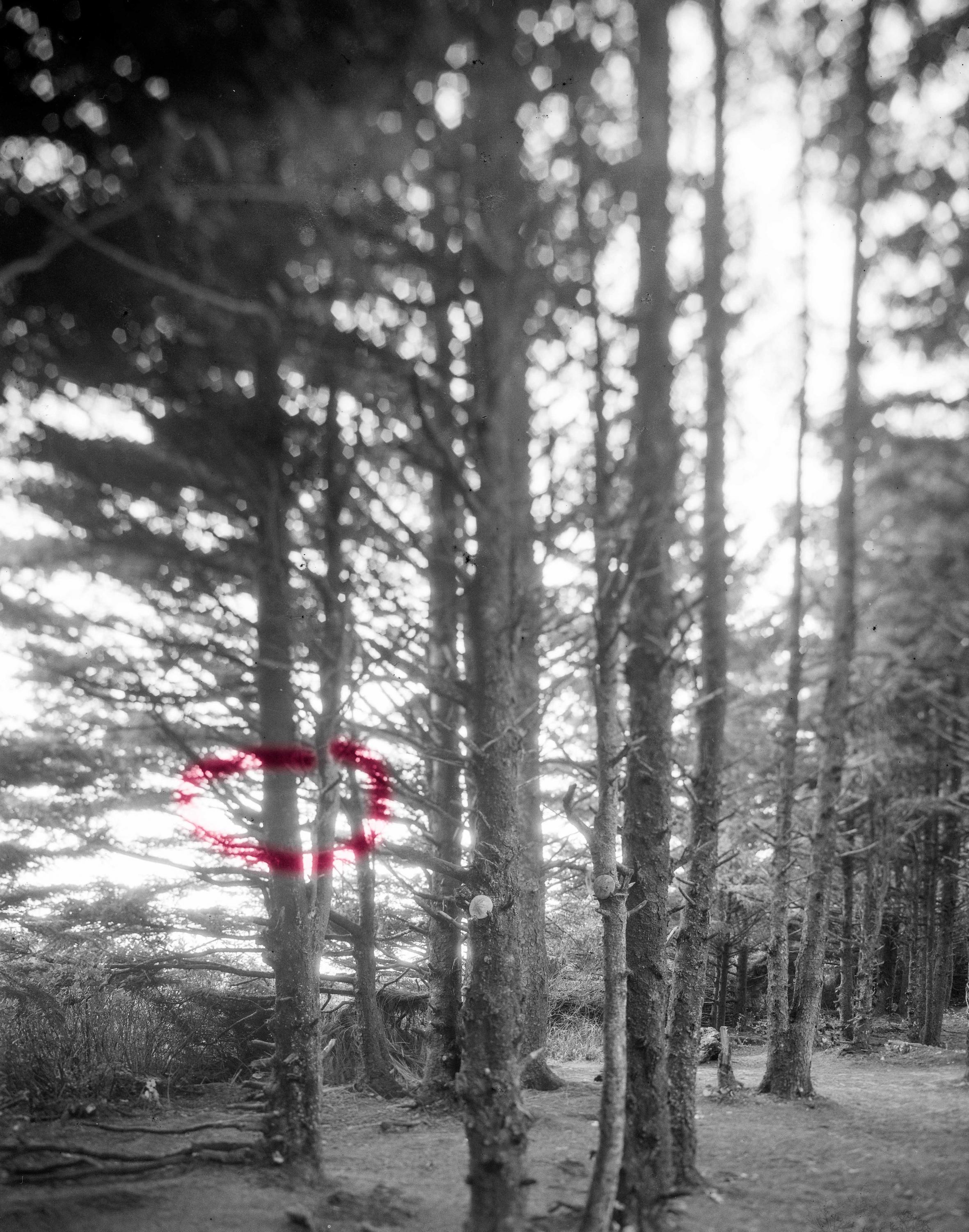

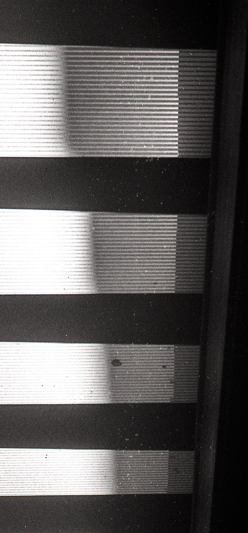

The other set of issues all occurred last night and are a bit more troubling. There are scattered regions of light speckling (dark on the print), some forming focal points with what I can only describe as fungal-like tendrils emanating outwards, as well as some pinhole-like phenomena consisting of dark circles with specular highlights in the center (on the print/scan). These images were processed in the same batch and during the wash I noticed/removed an unsettling amount of some weird, mucousy/stringy substance from the tank. FP4 in Rodinal, fixed with eco-Pro.
Development Problems-13.jpg Development Problems-2.jpg Development Problems-5.jpg Development Problems-4.jpg

Weird, no matter how I resize it, APUG isn't letting me upload the uncropped image for the last three insets...which, of course, is the one with the most blatant issues.
EDIT: There we go

Clean your scanner glass. That will solve the first set of problems.

sadly, it won't. the speckling is on the negatives and required a fair amount of spotting when I printed them.

I've run into a few issues lately with some of my negatives and was hoping to get some advice on how to avoid the same problems in the future.
Could be dust or even too much Photo-Flo. I was getting marks that looked like little bits of soap scum until I reduced my Photo-Flo dilution by half and moved to distilled/deionized water. Can't say for sure but it does remind me of what I encountered and how I solved it.

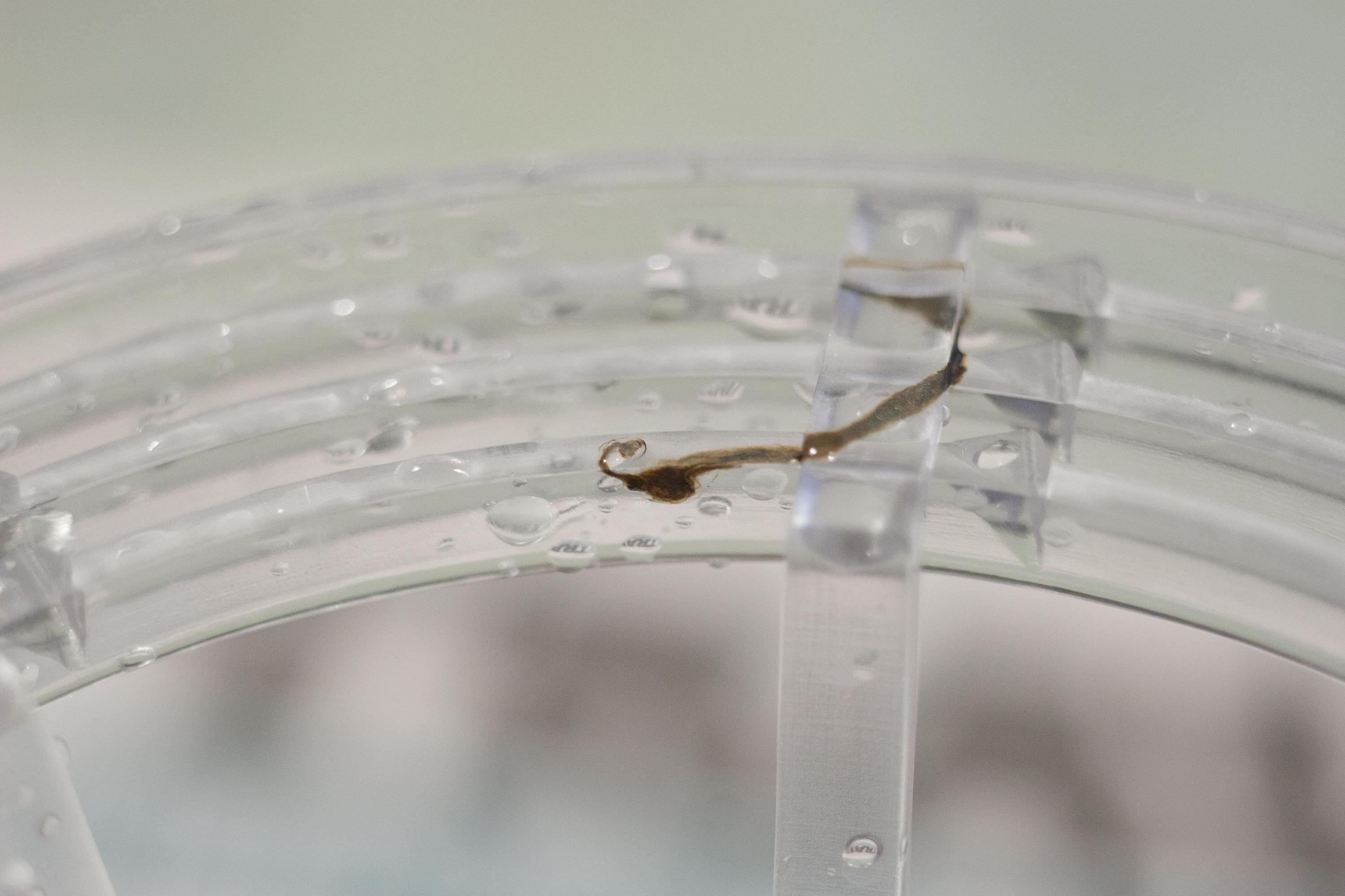

I started getting weird tendril looking things on my negs after reusing my fix many times without filtering it before returning it to the holding container. When I filtered it the first time I was surprised by how much lint and hairs has been in the fix. I'm scrupulously clean but smutz accumulated never the less.
What film, developer, fix you are using? Some of the marks look like concentrated powdered chemical stuck to the emulsion and over worked. This leads me to ask whether you used powdered chems and if they were allowed to stand overnight to fully go into solution.

The "black" spots are missing emulsion. Check damaged films, static damage, or stop bath issues.
The "white" spots are crap on your film. If all your negs are glean and your chemistry is clean, I would suspect contaminants in the water at processing time.

On the first batch of examples of white defect, I would echo the other's comments about wetting agent algae formation.
To me, these last 4 where it is black defect appear to be mostly to static electricity driven due to the spiderweb/lightning effect result, one looks like air bell from lack of development.
I have seen this if frozen film wasn't given enough time to warm up in cold climate.
You didn't say if this was 120 or 35mm, Is the film old by chance?

In cold dry weather I have had static discharge across the film. It looked like lightning bolts. It came from advance the film too quickly.

The first set is 120 the second set is 4x5, so if it's static in the second it's not from advancing/winding. The film was a bit old, yes, but I took it out of the fridge a good 48 hours or so before development.

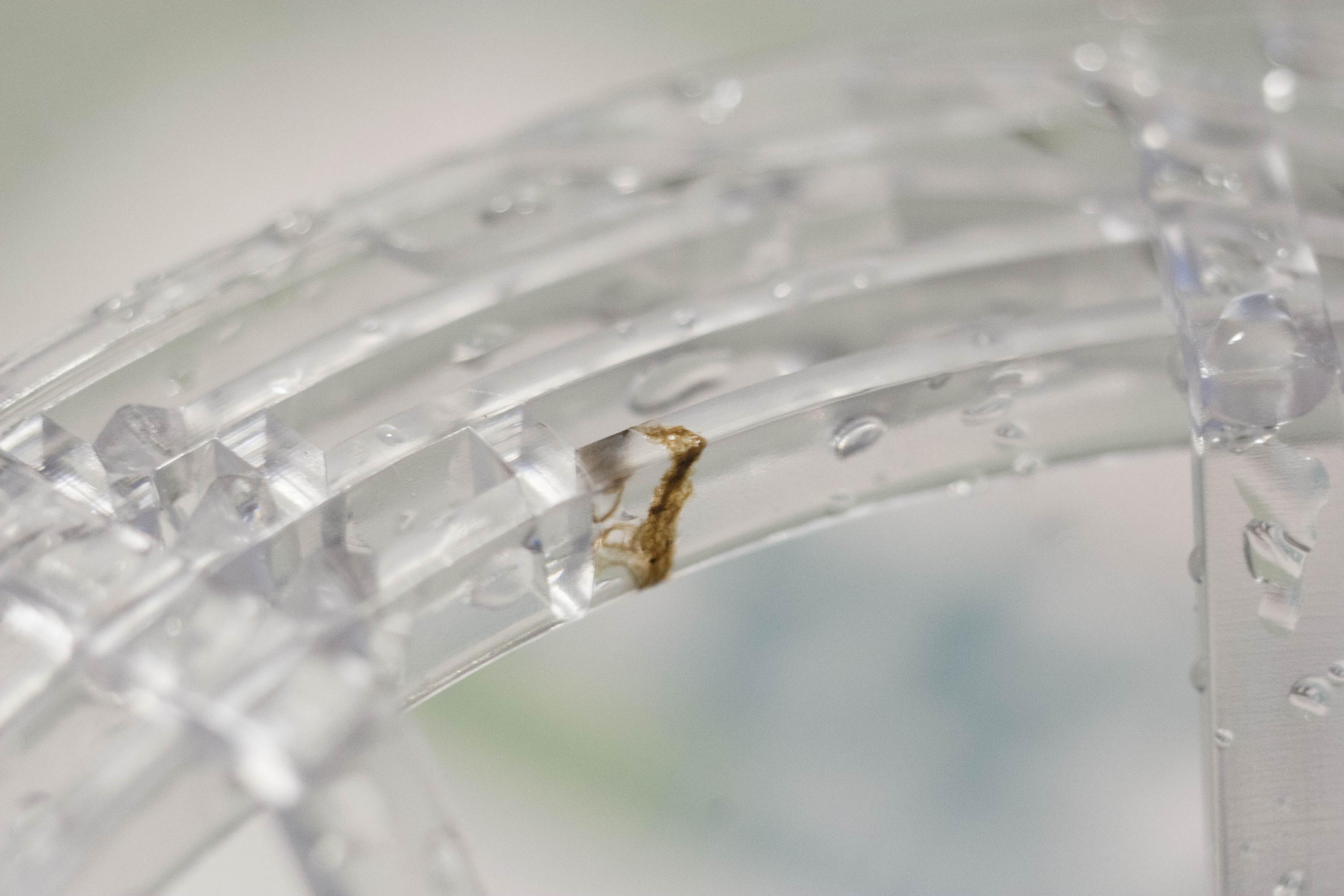

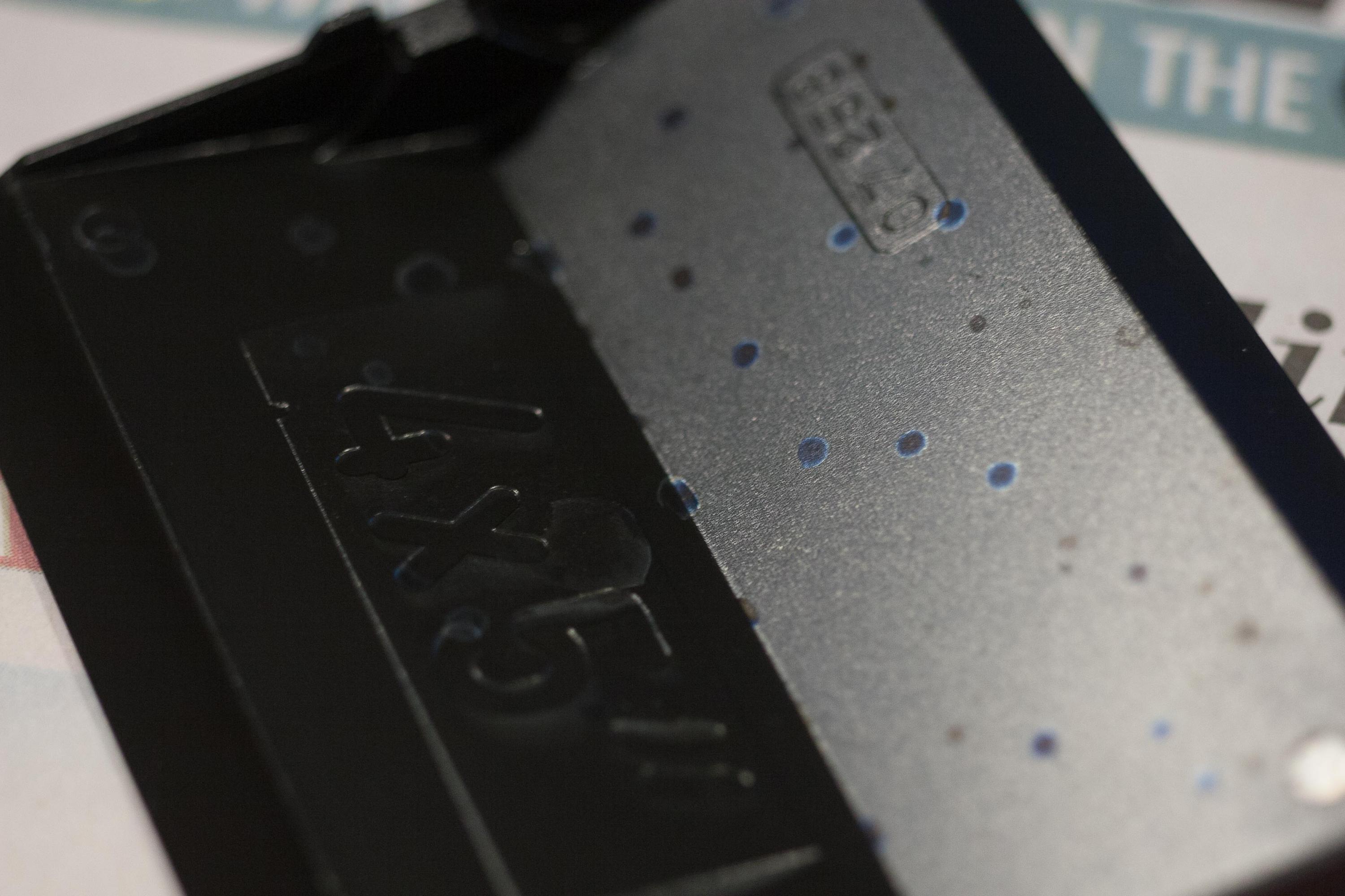

On another note, I just went to clean/dry everything to give it another go with some of the suggestions from here (I know, I know...shoulda cleaned them sooner but, well, things have been hectic), and found a couple things that might be pertinent to the discussion.

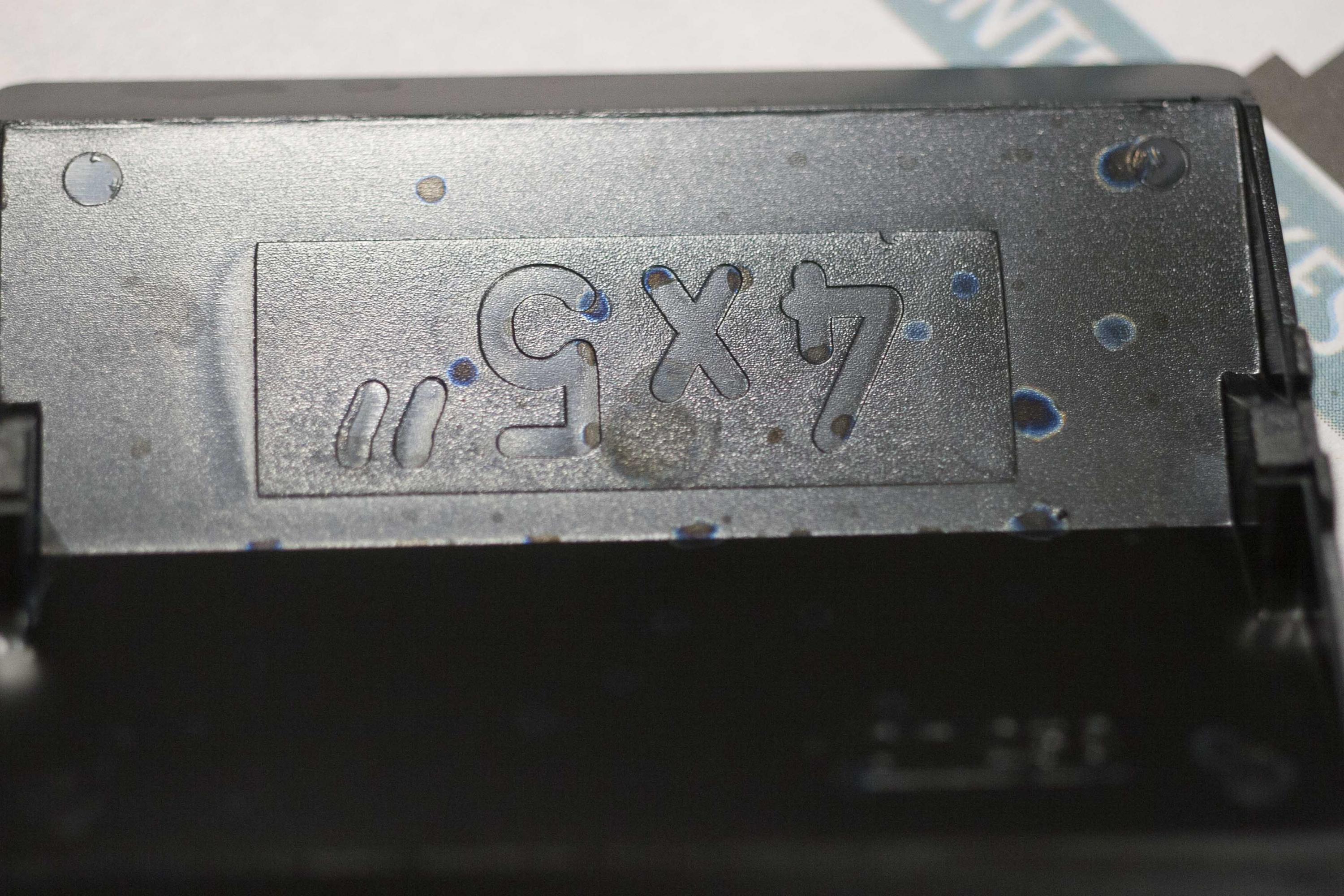

I was using a JOBO 2509n reel inside a 2501 tank for the 4x5 processing. For those who haven't used it, the reel comes with two "wings" that are ostensibly used to keep the film in place during development. When I went to clean them, I found that the wings were splattered with residue spots that shone an iridescent blue when the light caught them right.
I also found a few examples of the stringy/mucousy substance I referenced in the OP dried on part of the reel.
Perhaps these new bits of evidence might shine some more light on the issues? Pictures below.
Residue Spots: Development Problems-14.jpg Development Problems-15.jpg Development Problems-16.jpg
Slime Monster: Development Problems-17.jpg Development Problems-18.jpg

Cleaning everything is a good start. I clean my reels and tanks after every use. I use the Jobo 3010 Expert Drum so I cannot give 2509n and 2501 advice.

What camera (and format) are these from?
Once I had curious spots on prints from a dirty camera bellows. Camera was a Zeiss 6 x 9 folder. When folded the dirty bellows would leave dust on the unexposed film. The dust would block light hitting the film and leave pin holes on the emulsion leaving dark spots on the resulting prints.
