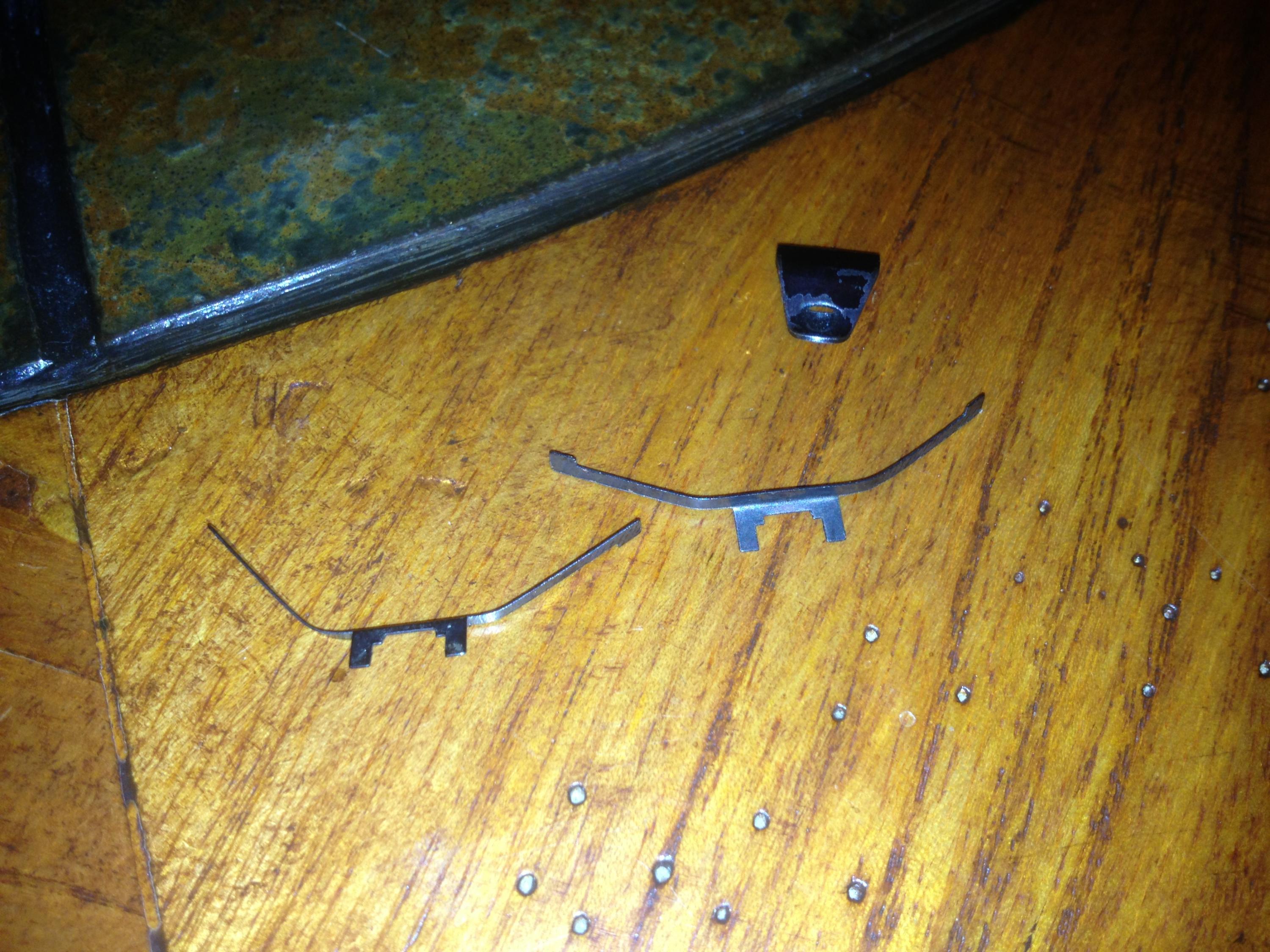

I have a mostly complete Rolleicord 1a type 3 here and need some help determining how the focusing screen mounts in place. Anybody have a nice exploded view diagram for the focusing screen area of this model Cord? The camera came to me with a small parts envelope containing three pieces that look like they culd be used for retaining the screen. Picture below... Anyone know how this goes together? I don't have the screen but can get one, but first want to know if I have everything else I need to put this back together.
Google search- Rolleicord service manual= http://www.kyphoto.com/classics/repairmanuals.html
at the bottom of the list is a Rolleiflex Service manual that covers the vast majority of Rolleiflex TLR's. The first two cameras covered in the manual are the Rolleicord VA and Rolleicord VB. If they are not an exact match they will be very similar as all models are a variation on a theme with most differences on the internal working of the camera. The pieces you pictured are a viewscreen/ground glass retaining springs. They look over curved for the application. Use needle nose pliers and reform the arms at the center frame bend. The bend should be about half of what it currently is but wait until you have the replacement screen and are installing it to reform the springs.
Thank you Shutterfinger. I have that repair manual but didn't see what I wanted. Looking again I do see that the model 3.5 has spring clips. I'll pull the hood and see if I can figure where these go...
Are you able to say if I'm missing anything for mounting the screen or is it just the two clips? How bout that third part in the picture, any idea about where it would go? It was in the parts envelope with the spring clips so I'm thinking perhaps it has to do with screen mounting.
Got it figured out. All I need is the new screen. Figured out the forward clips mounting pretty quickly, but it took a bit of looking to see that the unknown part in my picture is the hood opening latch, which is held in place by the other screen retaining clip. The spring clip holds the hood latch in place, and supplies the tension to keep the latch locked. The latch in turn retains the spring clip so it will retain the focusing screen. Lovely, simple design.

Yep, you getting me to look at that manual again got me going. Seeing where the 3.5's clips mount led to me seeing how they fit my 1a. Simple and clean once I figured it out.

This C3 is sort of a Rat Rod of the camera world. Bare metal, torn leather, dented sides pounded out to where things work. It was one of those that I just couldn't toss out. It had lived a tough life I guess and just had to be fixed. The frustrating thing was I got it all together and working fine and then while adjusting the screen I dropped it. Shattered like the ground glass it was...
