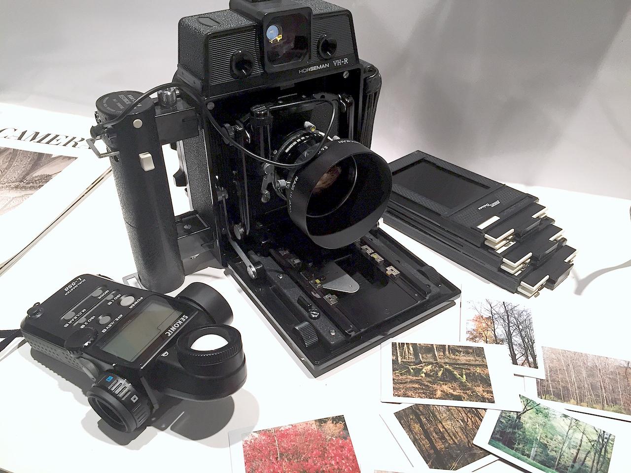

There were "Single Shot" loads available for these cameras, but they were expensive and are no longer availabe from what I can tell. I tried to make the same with Instax film as you saw in the thread. It was very tedious, probably would need IR goggles to line up the film for each single-shot load.
I gave up on the idea and currently use Instax in my Horseman, rather than my Polaroid 250. I have to take the exposed film out of the holders and put it in an Instax camera to process them, but that is very easy to do in the dark.
