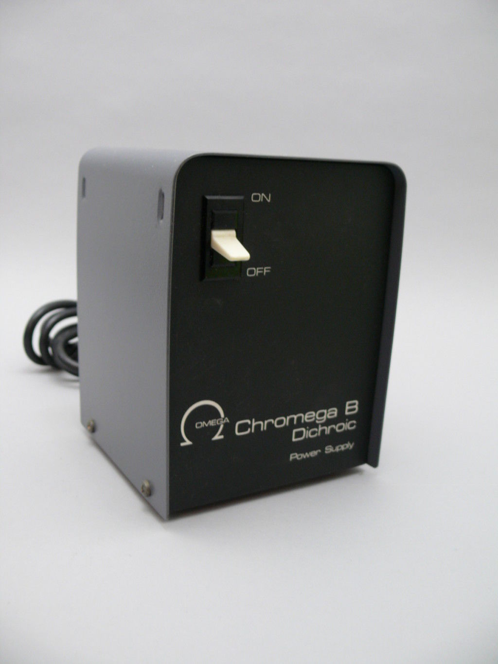

A variable Xformer?? That doesn't sound right. Doesn't sound like he brought the correct power supply with him.
Well I just searched google images for that model and all I saw was a box wit one rocker-switch and nothing else. Further, the power supply on my Beseler is like that too. Sounds like he gave you a variac of some kind and not the right power supply.

Mine has a black box with a single switch on the front which is the power supply.
The lamp is an odd voltage; you'll have to take the lid off as if changing the bulb and see what voltage the lamp is. I think it says in there. That's why there's a variac. If you swapped bulbs to something of a different voltage it could run on any appropriate power source.
EBAY is littered with power supplies for this model, cheap enough. Knowing that, there's no sense in tinkering with this oddball stuff.

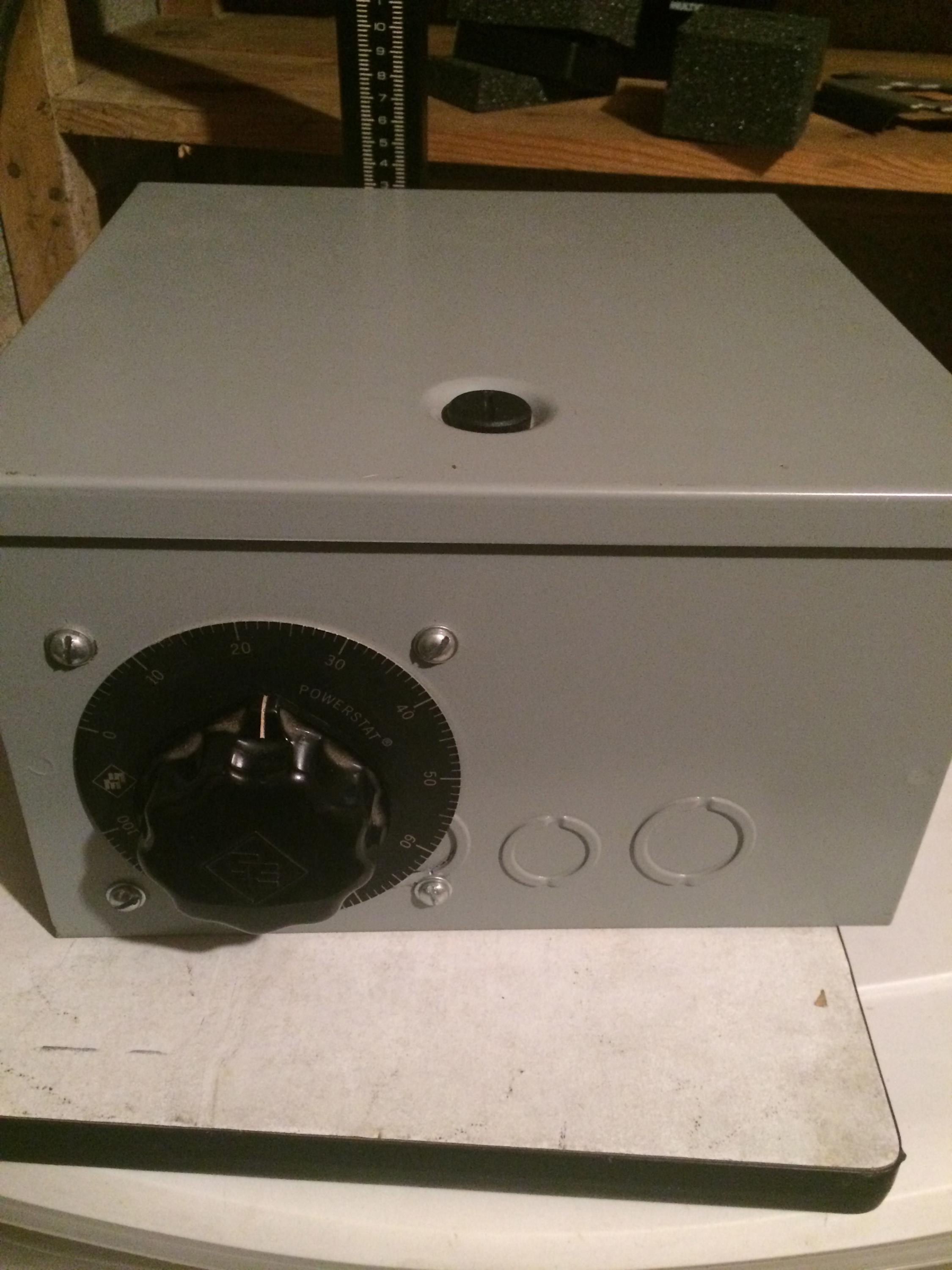

Here's a picture of the transformer I received. I don't think my friend has the other power supply, so I'll have to get one on ebay. They're pretty cheap so that's not a problem.
That is a Variac or similar, possibly a well-done home made. Very nice--Wish I had it. They're used in radio/TV repair and other industrial applications. But it's not what you need for the enlarger. I'm not familiar with that particular one. It could also possibly have circuitry that makes it a voltage regulator. You should have somebody take a look at it and see exactly what it is. If it is a voltage regulator, and IF it has an equal or higher power rating than the enlarger's power supply, you might be looking at something that would be perfect for color and high-accuracy black and white work.
At any rate, it's a nice box, especially for a compulsive tinkerer like me.
Looks like it is set right about 24v. Don't accidentally bump the knob :smile:
Actually, if you are a fanatic, you can hook this up to a AC voltmeter and tweak it to exactly 24V for each printing session. Kind of a semi-automatic regulated power supply.
Actually it would work on the enlarger I feel sure. I never really doubted that. But I'm the kind who likes the right part. Besides, you could bump the knob accidentally and burn out your bulb, or make it too dim and yellow.
