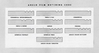

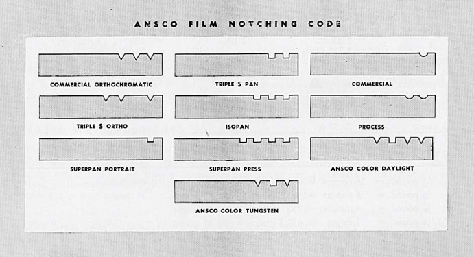

It's hard to know for sure because Dupont/Defender and Agfa/Ansco used some of the same notch codes, but according to the attached chart your film is most likely Ansco Superpan Press and/or Superpan Portrait.
Jonathan

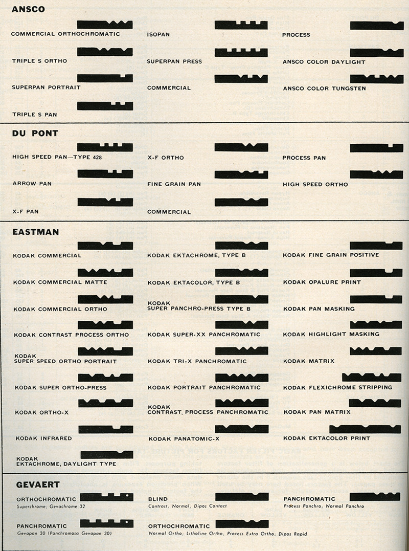

Thanks. I've also found this, so the 4 notches is probably ansco and the single notch might also be ansco if the photog used the same brand of film. I've got 4 sheets of the superpan press and 2 sheets of the single notch film. No idea if they have been exposed or not. Any idea what to do with them? I don't really have any prior experience with large format b&w film as I have always been a casual 35mm shooter that did my own c41 and scanned them.
