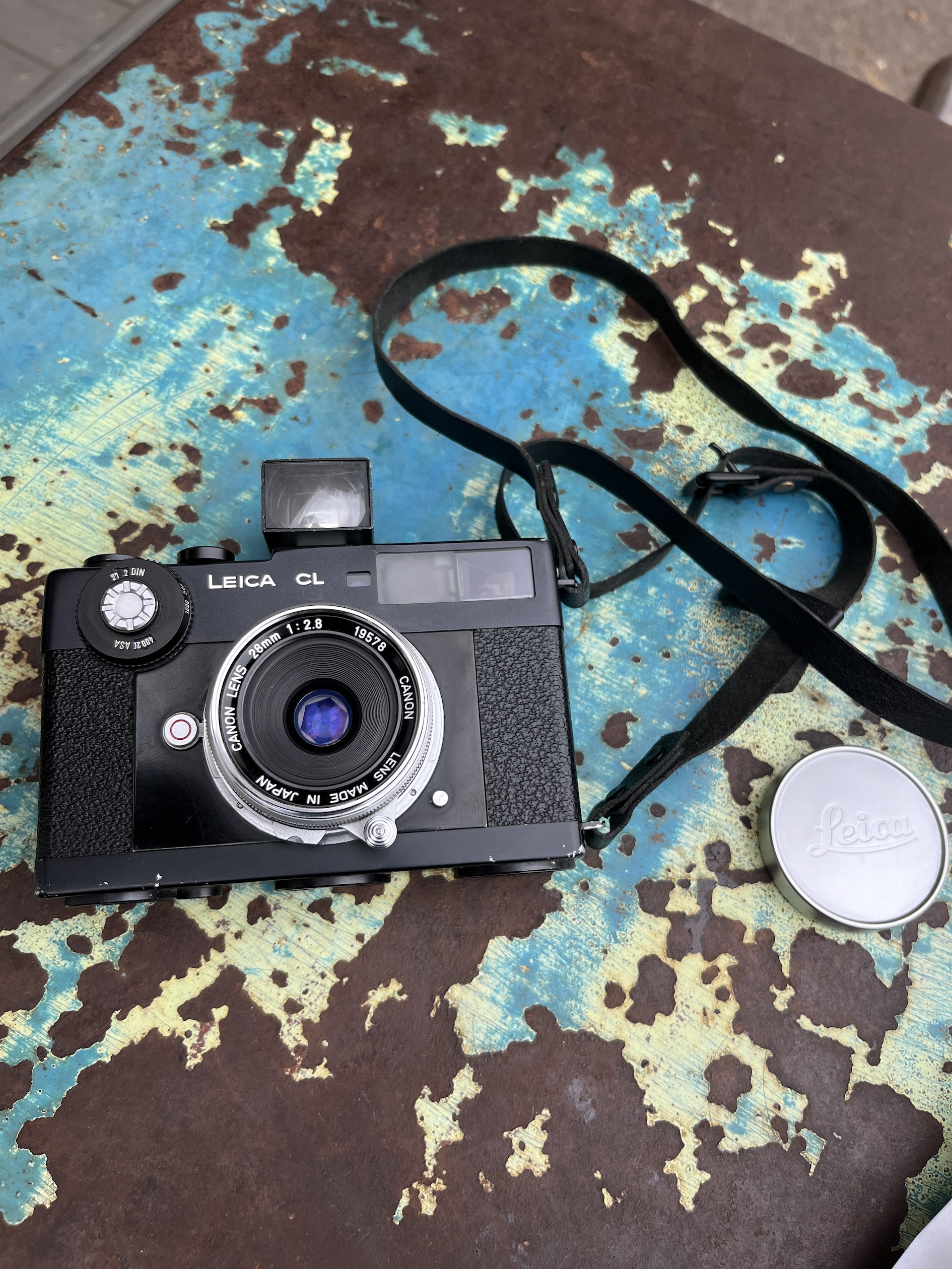

Another good option is the Leica CL.... here's mine w my Canon 28mm f2.8 LTM
Zone focus & it's a great point & shoot.
