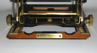

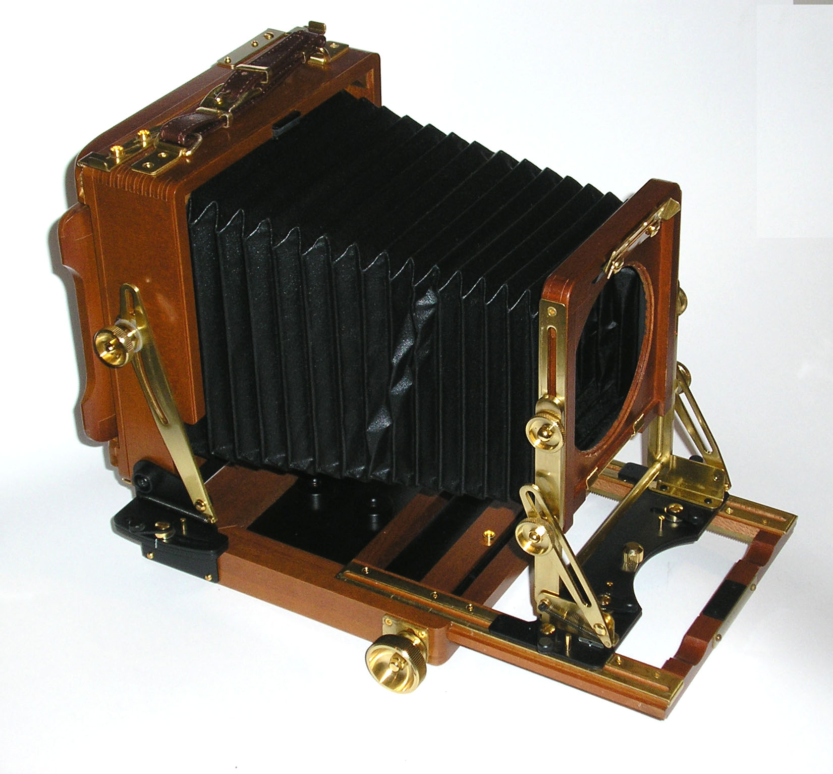

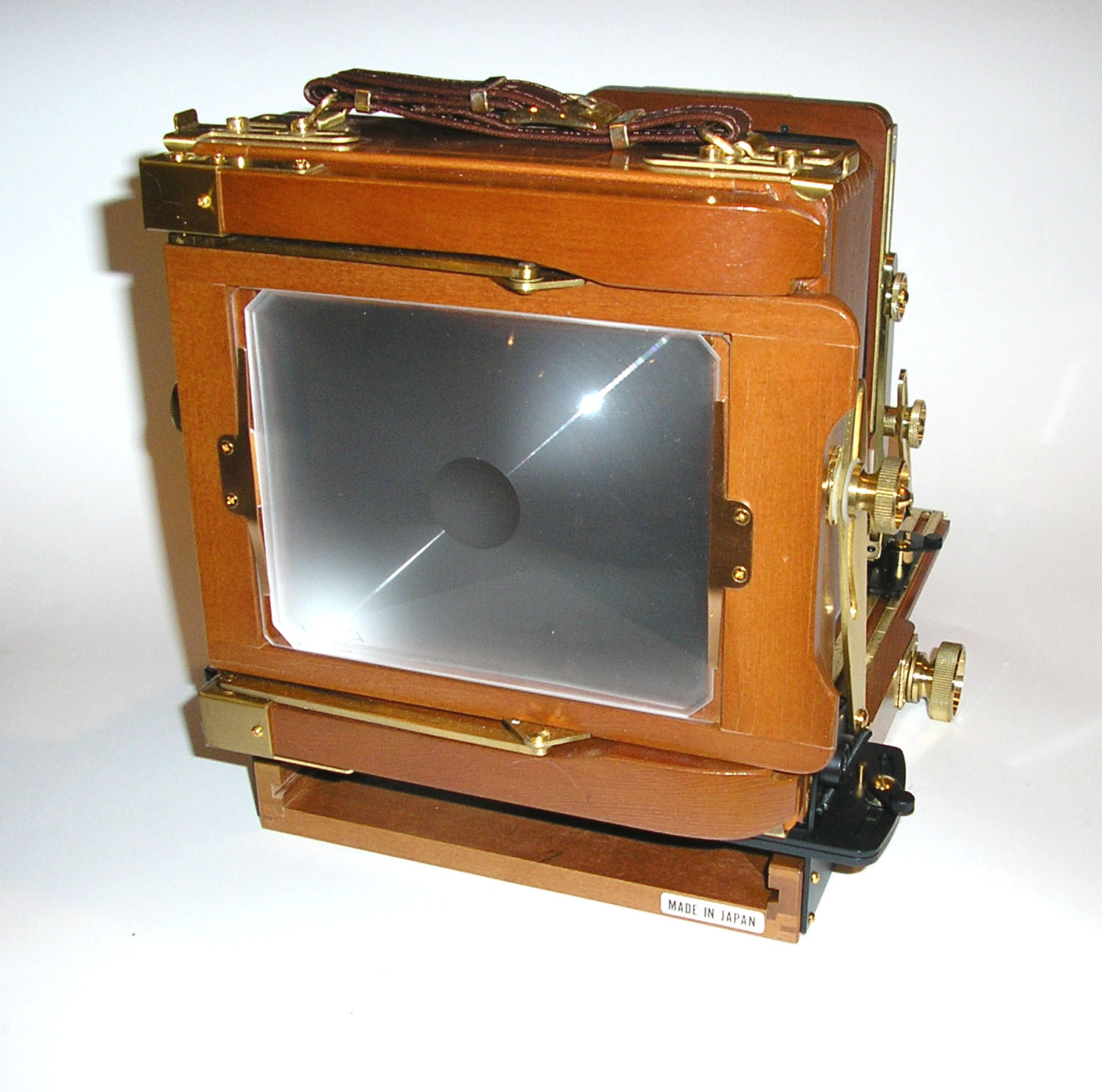

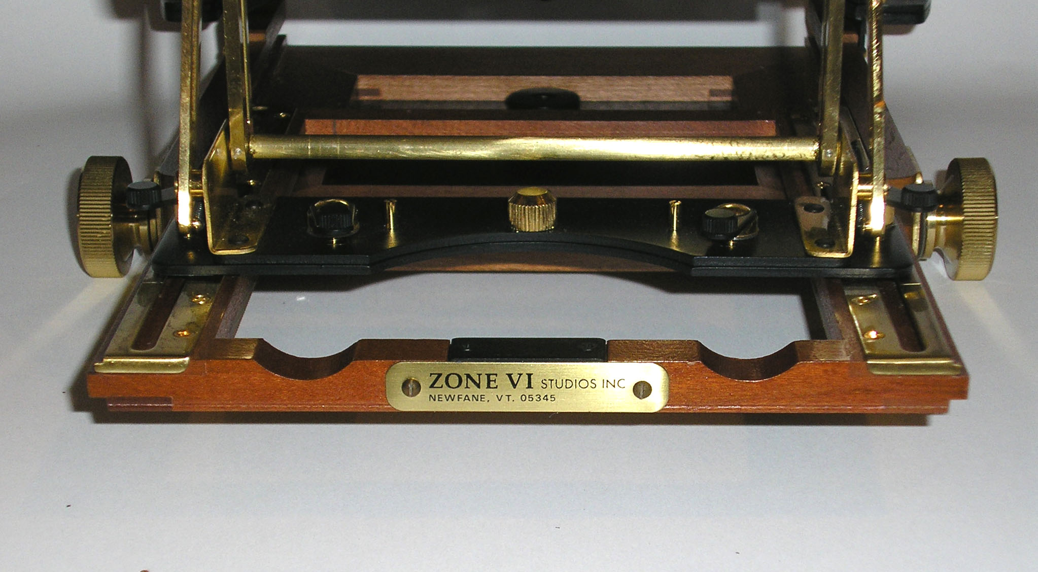

My Wista Zone VI uses Linhof Technika compatible lensboards. I don't have a photo of it with lensboard, but here's a few to compare with your camera. Somewhere (I can't remember where) the wood is marked Wista. I use metal boards like this.

That is the same Zone VI camera model. Thanks for the Linhof Technika tip. I hate to continue to modify the board that I have. I'd like to be sure that I have a correctly fitting board for my initial tests.

My Zone VI Wista from 1979 uses Wista lensboards or Zone VI boards. The Wista boards looks exactly like the Technika boards mgb74 linked to above.
