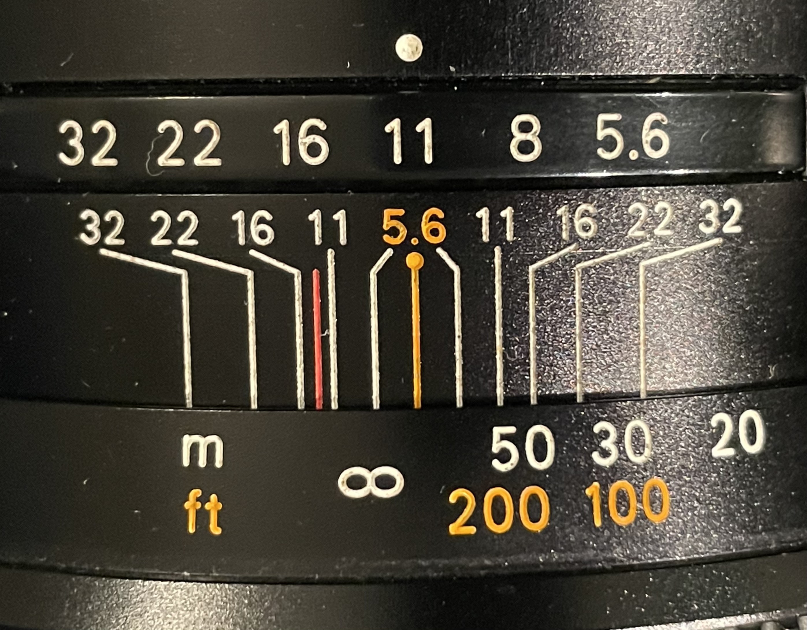

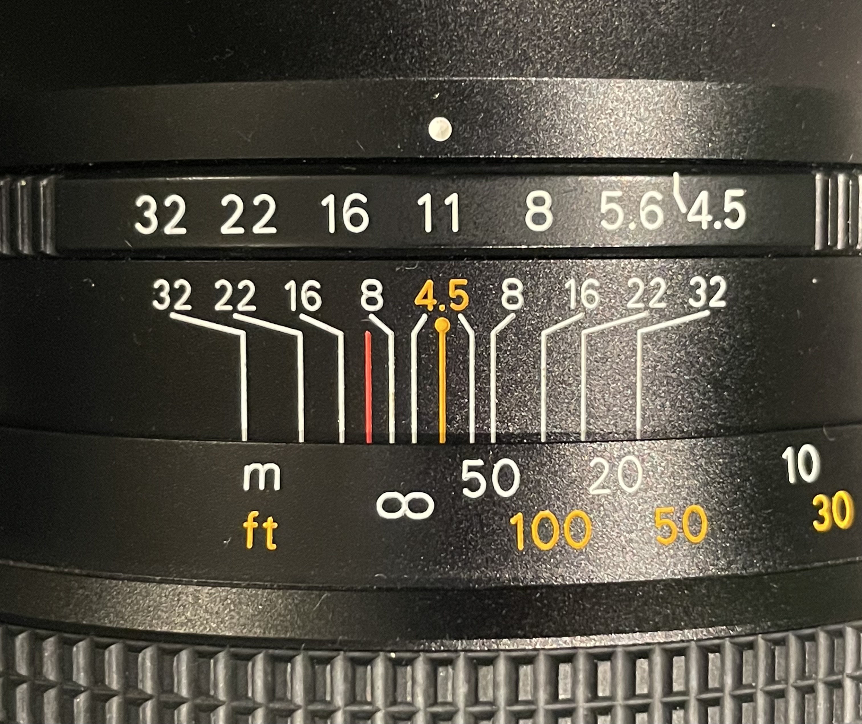

If it is of interest, let me take a look, the lenses are upstairs...
This is the correction for critical infinity-focus on the 4.5/200 mm Bronica PG. Filter 89B, Film Ilford SFX.
And this is the same for the Bronica PG 5.6/250 mm
As you can see, correction lands halfway between visual infinity and the indicated correction for Kodak HIE with R72 filter. But it's hard to tell any actual distance as we are in a small region of the scale where values increase exponential and are hard to estimate.
Trying to answer the question in numbers for the 200 mm, where the correction lands in the middle between the markings for infinity and 50 m, I estimated quick and dirty on a x^2 graphic-plot: If I assume infinity as 1000 times the focal length i.e. 200.000 mm or 2000 m, plot an f(x)=x^2 function and look for the y=2000 - 50 mark, cut the resulting y in half, go to that value and read the x from there I am at about y=850 m for the 200 mm Bronica lens. One could argue this is irrelevant but its just a bold estimation and may not even follow the assumed f(x) = x^2 on this helicoid and you can see the difference with a loupe on the negative and in the shaprness of the print.
