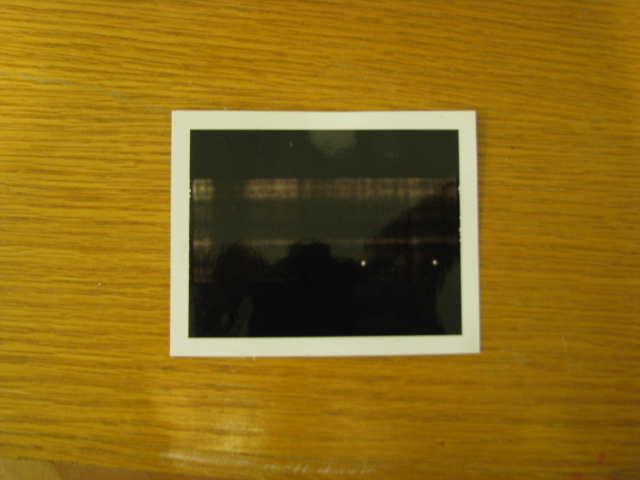

I just got a Polaroid back for my RB67 and am having a terrible time:sad:. First I thought I got it loaded correctly, only for the first black leader to rip down the middle. I popped it back open and pulled enough leader through to get it through the rollers again, but i figured i ruined the first piece of film. as I pulled the leader through, and grabbed the first white tab to pull that piece of film through, I was not expecting there to be so much developer goo. It was everywhere. Is that correct? there was so much goo on the 2nd white tab that i was hardly able to get a grip to pull on it and it eventually ripped. popped it open again and fiddled for about an hour trying to get what was left of the 2nd white leader through without damaging the rest of the film. Now I finally thought I had it put together right (after 5 sheets) and I get a picture that looks like the attached.
I hope someone has some advice for what I am doing wrong (other than everything)

You've probably loaded the film incorrectly. The white tabs do not go through the rollers. All You need to do to load the back is place the film pack into the holder and make sure the white tabs are neatly separated and not folded under anything. Then you simply close the back and pull the black leader, which should come straight out with no resistance. While not specific to the Mamiya back, these instructions might be helpful as all Polaroid Type 100 backs load in the same way: http://www.araxfoto.com/manuals/polaroid.pdf

Damn it! Thanks E76. That was what I did wrong. I mistakenly thought i had to feed the first black leader through the rollers myself.

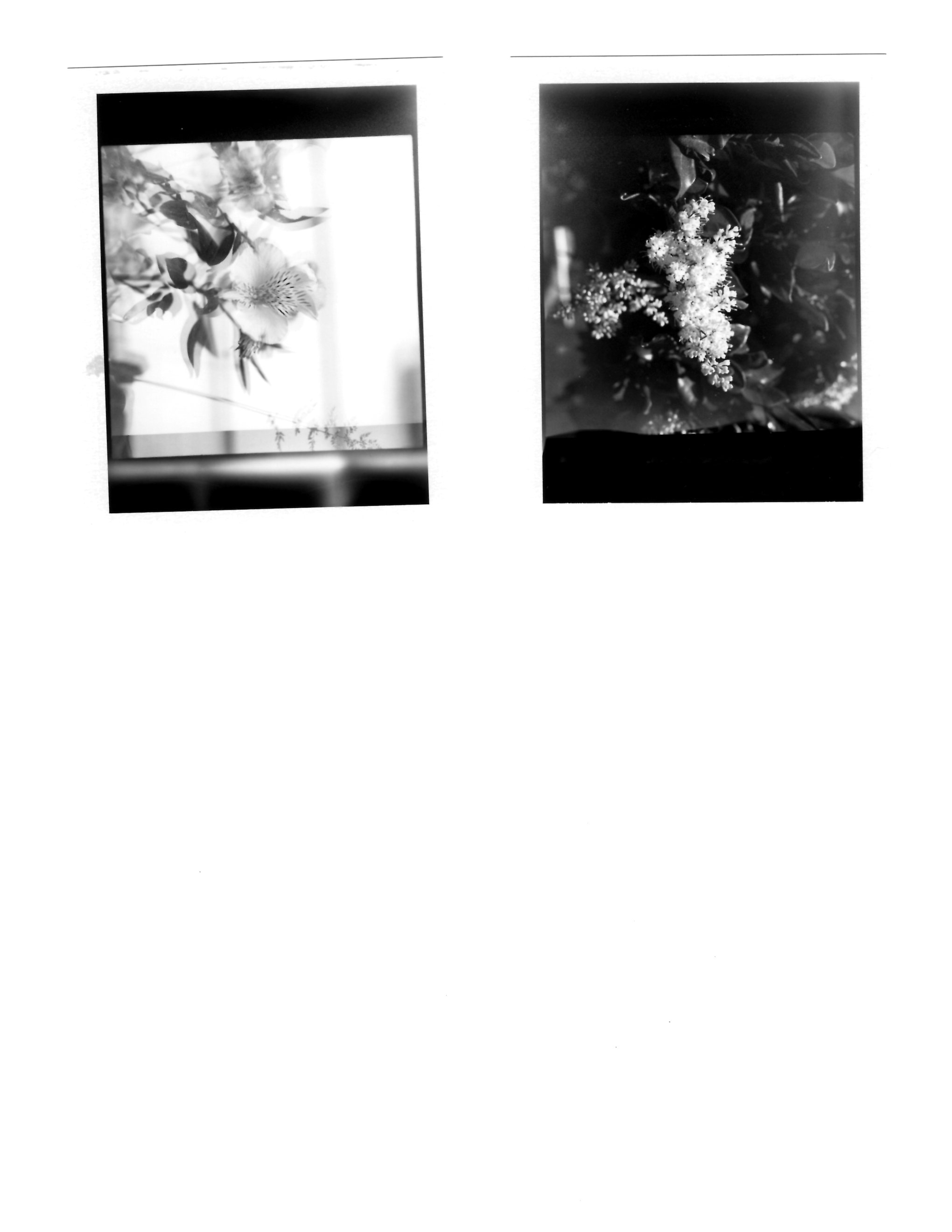

So, I've got a few pictures this time and I've attached 2. Both were taken in my yard @ 1/250 and 5.6. As you can see, something is going on here, At least I hope so:sad:
Your Thoughts?
tjaded
Oct 15, 2006
1,020
San Francisc
Either the back was not attached properly or there are some light leaks in the back itself...at least that is what I see. I've never shot with a Mamiya, so there could be other things going on.
