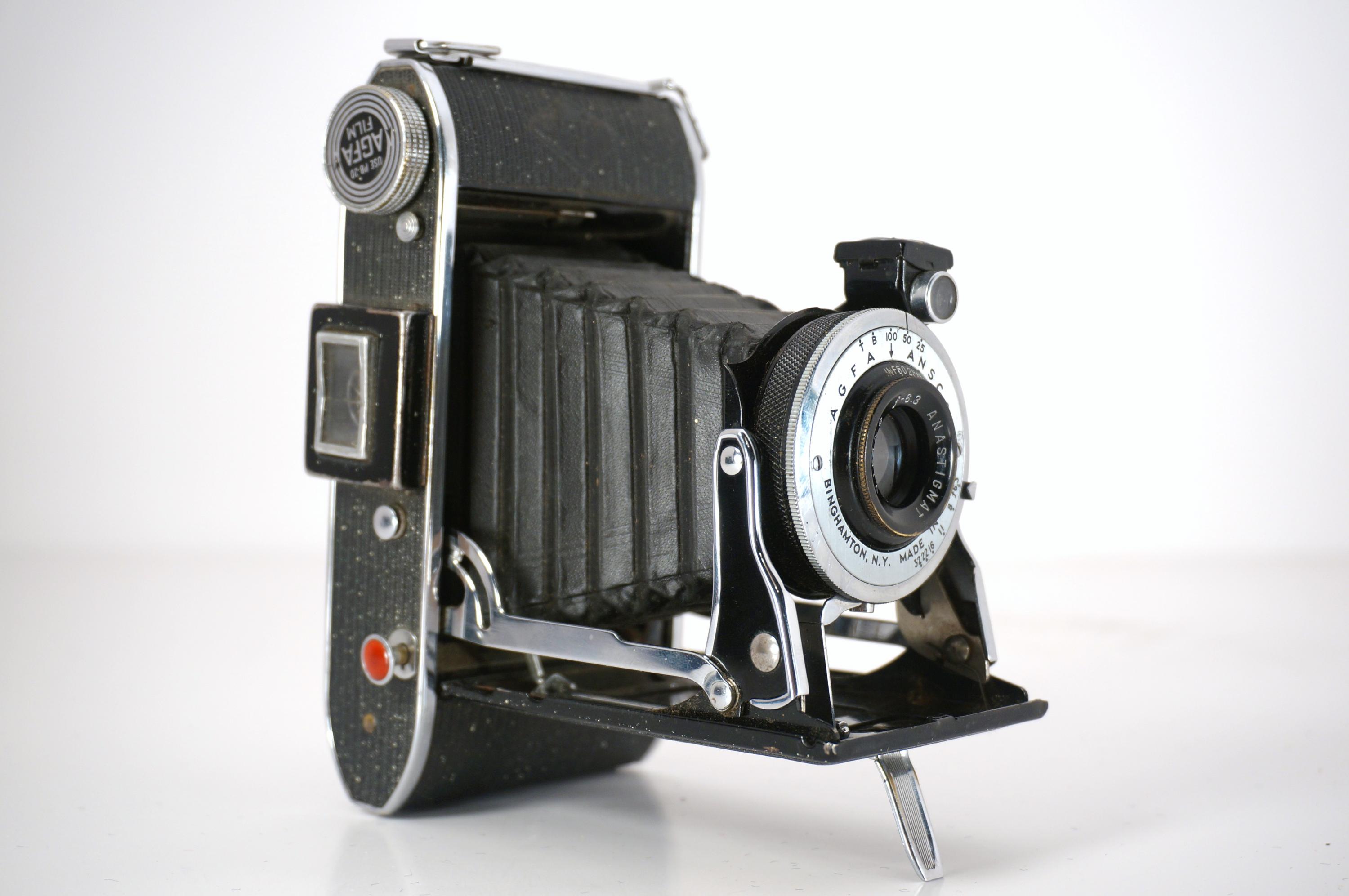

Can you post photos of the arms? There are so many different arrangements it's hard to offer advice without seeing the specific cameras in question.

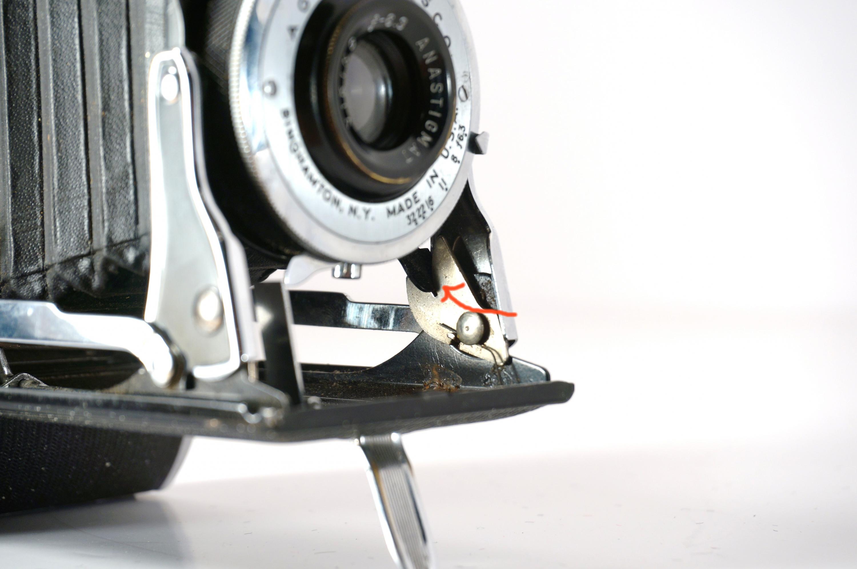

I'm working on the Agfa first, here's a couple of pictures.
Looking at it some more I'm wondering if I need to tweak the tabs that index into a fitting on the front of the platform? The arrow in the detail shot is pointing to one of the tabs in question.
Thanks for the help!

Before tweaking anything, make sure all the pivots and lock points are perfectly clean. If they are, then yes, I'd first be looking at the tabs you indicate. It's a pretty simple mechanism, which makes it easier to see what effect any changes you make are having overall.
The measurement point is a good one. The way I've done it is to remove the lens and shutter assembly, then use a plunge micrometer from the shutter flange to the pressure plate (back closed, obviously - you may want a single layer of tape on the pressure plate to prevent scratches). Measure at four cardinal points around the flange so you have a clear indication of what's going on. It's not as precise as a bench setup, but you should be able to get within 0.10mm pretty easily.
