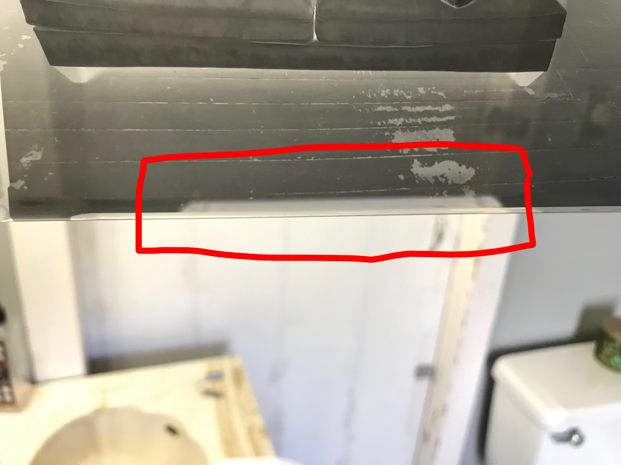

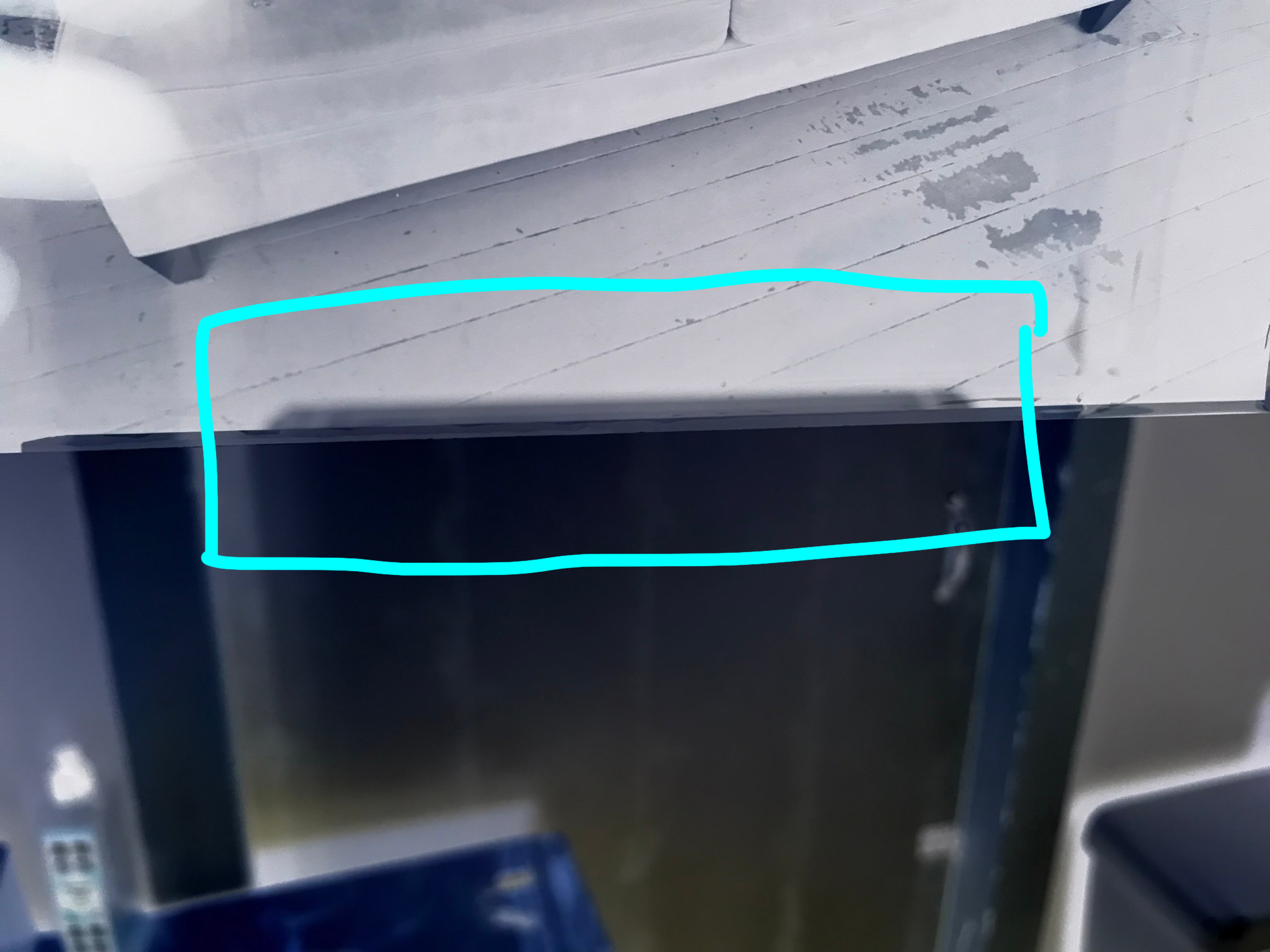

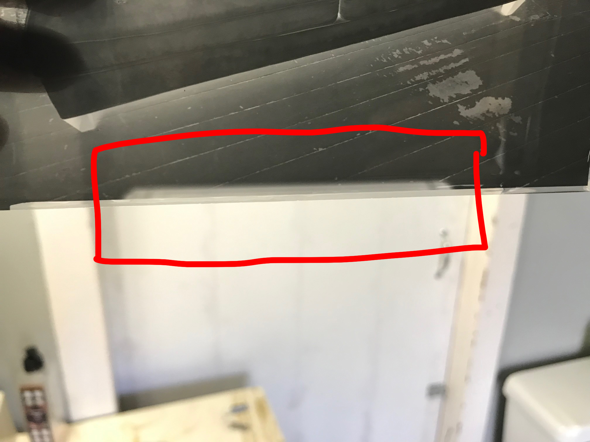

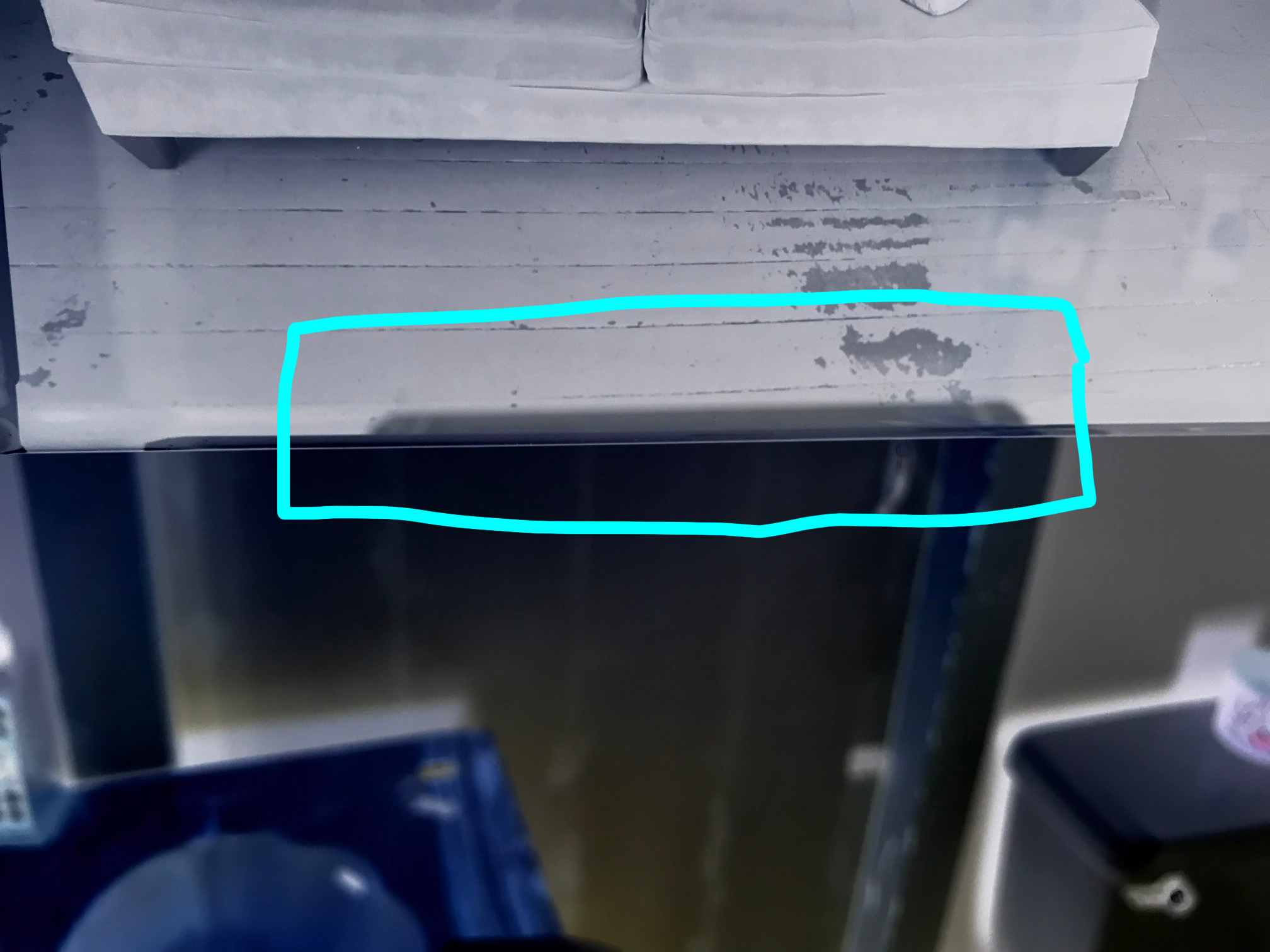

Hello,
I just tray developed two sheets of 5x7. Both sheets loaded in the same film holder (one on each side) and photographed with the same lens. At first I thought this leak must have been a shadow because of it's shape, until I realized the exact same shape, in the exact same location was on both sheets. Any ideas before I start trouble shooting with more film? I posted the negative and an inverse photo of each, in case it helps.
Thanks!

Ah, yes. Good point! I didn't even put that together, but you're right. I just checked my film back and there's nothing that looks like it's obstructing the light from getting to the negative. Where the heck did it come from :blink:
It's been figured out.. It was my front bed fully extended getting in the way of the shot, while using a wide lens. Doh!
