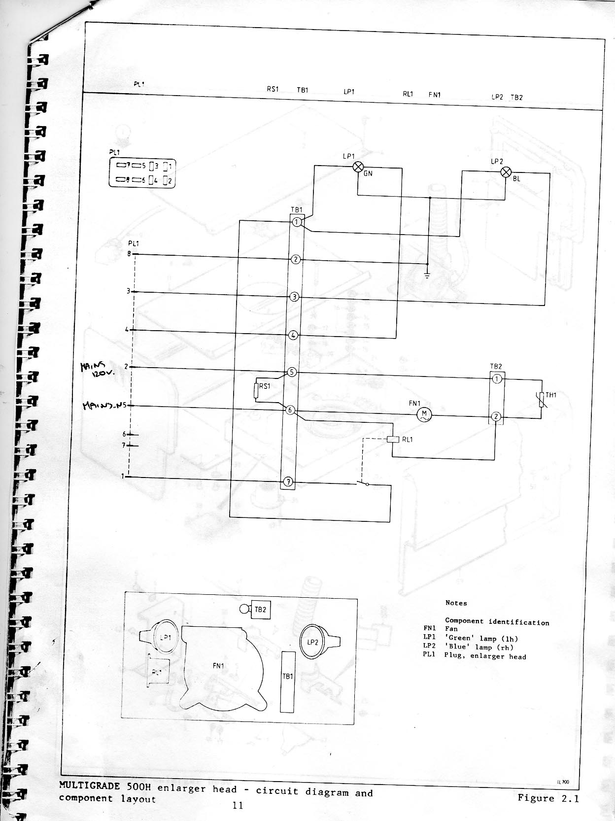

i need someone who can read the electrical diagrams for the two ilford 500 heads i have one is older and has a differen plug setup. i want to know if it would be possible to change the plug on tje older head and use it. i do have the wireing diagrams and it looks like the difference is the plug connects.
if anyone could look at the diagrams and tell me if it possible .
thanks
mitch

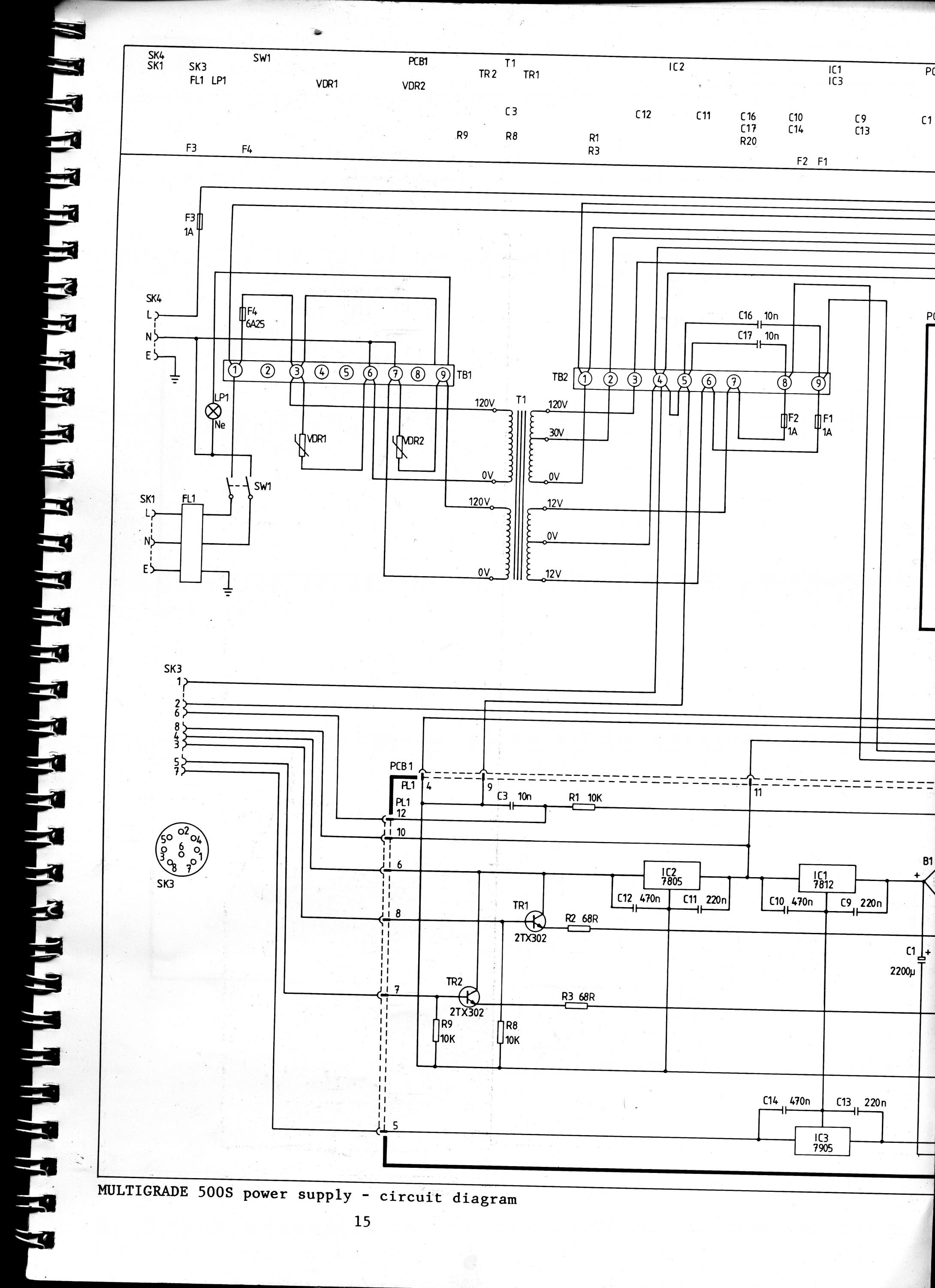

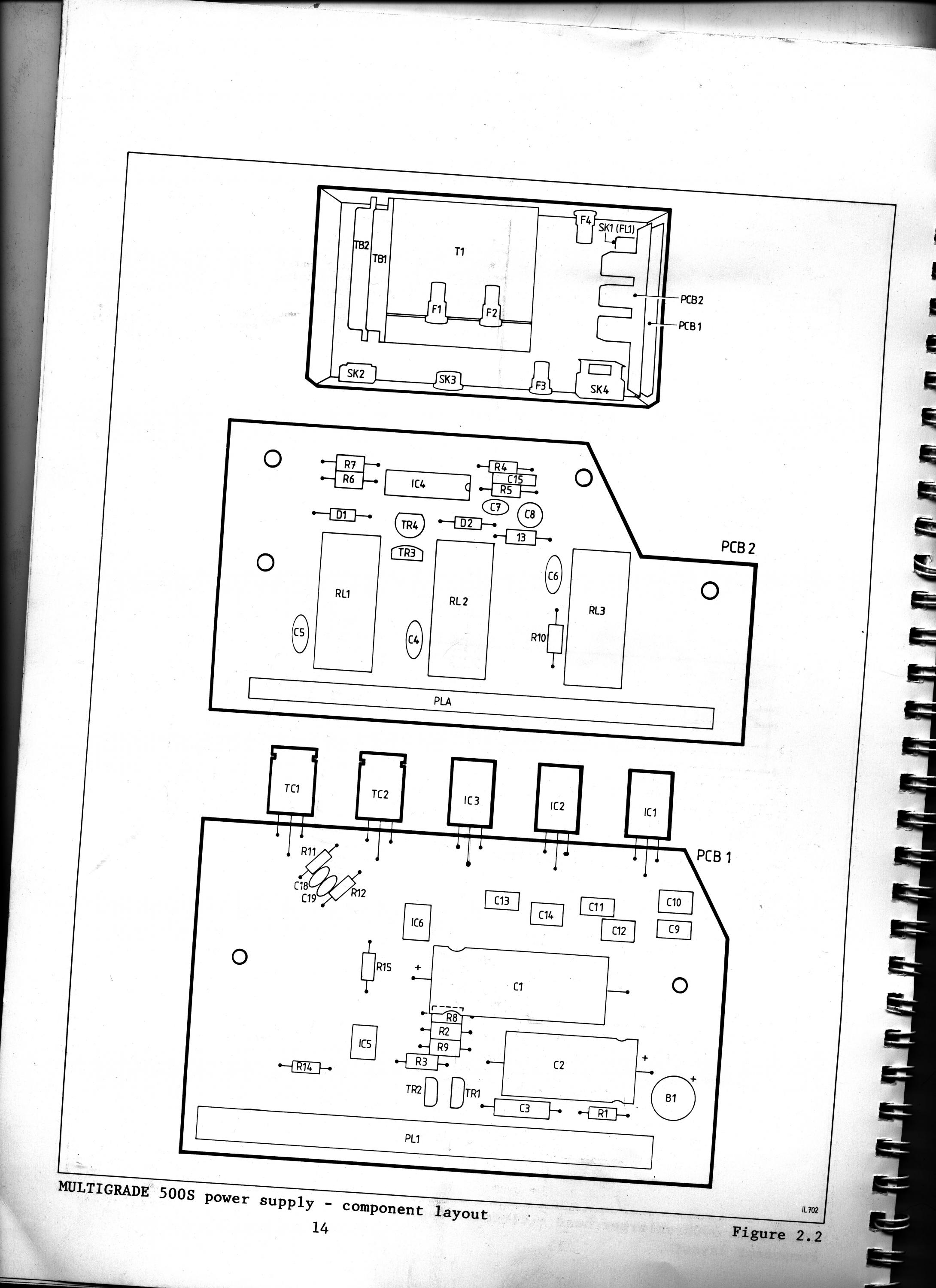

here are both diagrams .
thanks

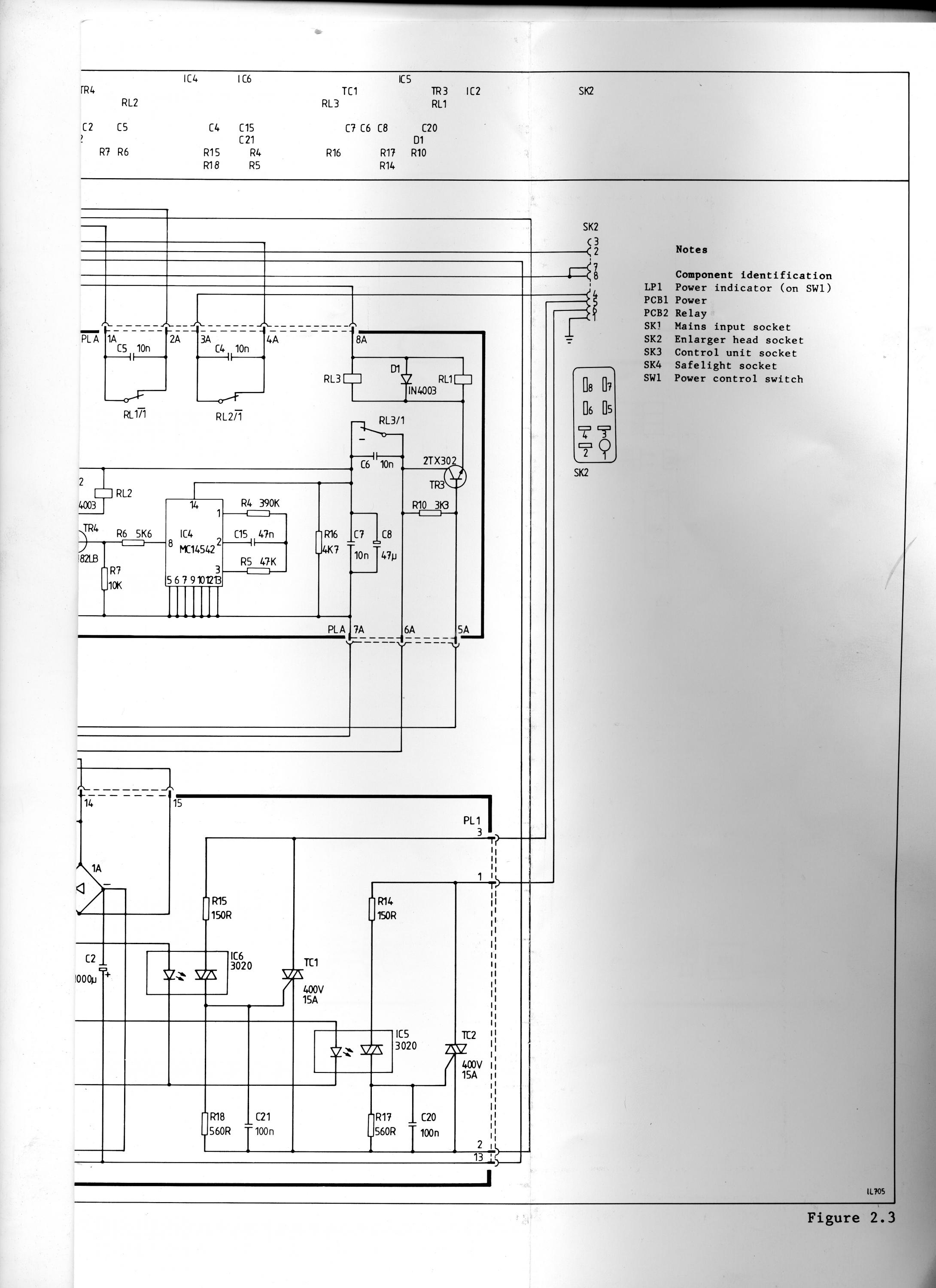

You've done a great job. It was about time someone uncovered these Ilford MG500 exposure system circuit diagrams for the units with the older 500C controller...
I asked Ilford Photo/ Harman directly, and they had nothing except the circuit diagrams for the units with the newer 500CPM controller.
Good job! And thanks for posting them here.
LAST THING: If you have scans of the circuit diagrams of the actual 500C controller too, please post them here in this thread!!!
You only posted the circuit diagrams of the older 500S power supply and the actual head as relevant for your question, but not the 500C controller.
Please post them for future reference and repairs, they are to hard to find!

In addition:
Please post the component layouts of the 500S power supply and 500C controller too!
Thanks,
Marco
Marco B
Jan 13, 2005
2,736
The Netherla
Actually it seems you did post the older 500S power supplies component layout, as I now noticed there are some small changes compared to the documentation of the newer version I already had, although I still need to verify it with my unit, I have the slight feeling the component layout doesn't completely match the either one, but it is probably insignificant.
Than only the component layout and circuit diagram of the 500C controller are missing!
Post them if you have them.
Marco B
Jan 13, 2005
2,736
The Netherla

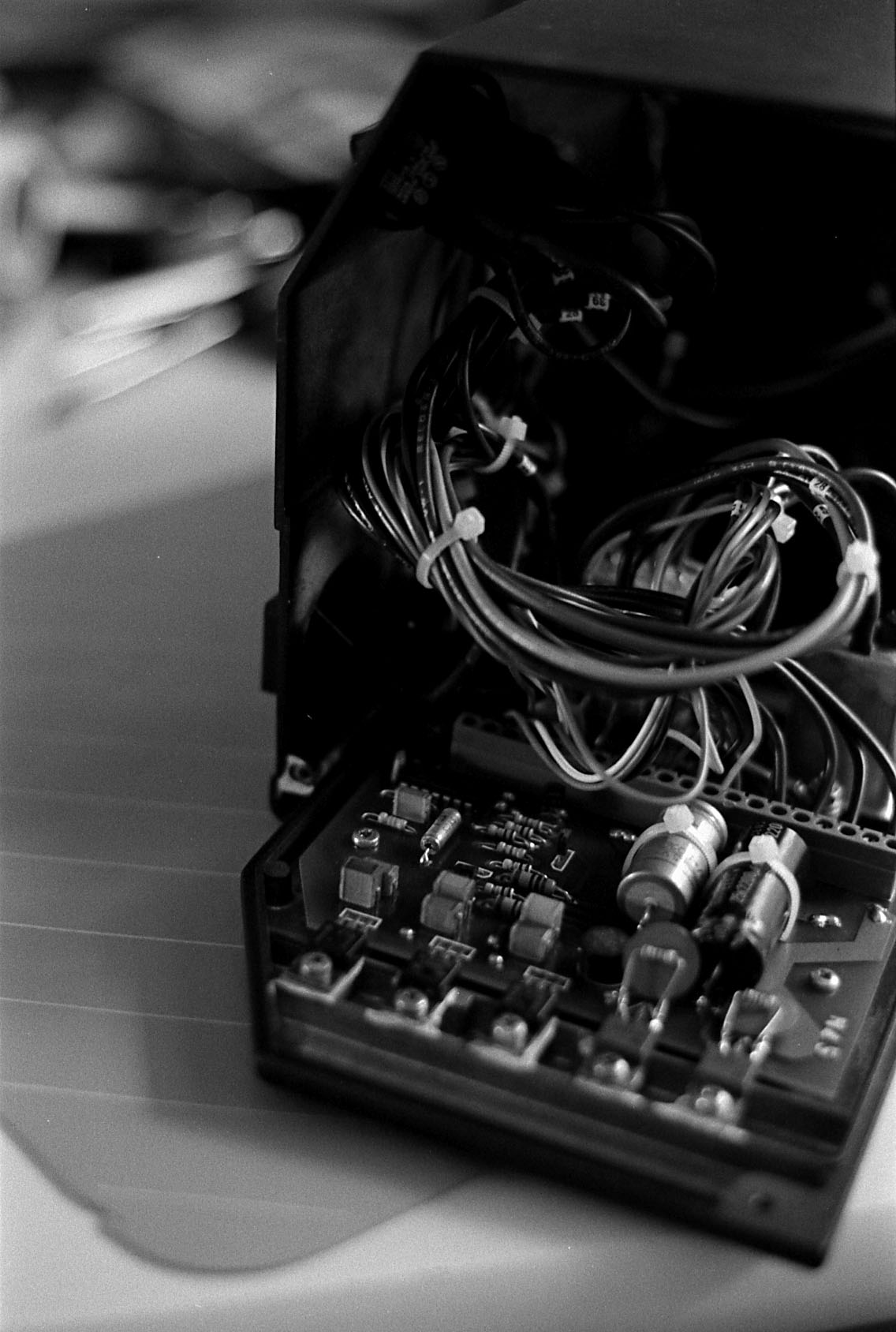

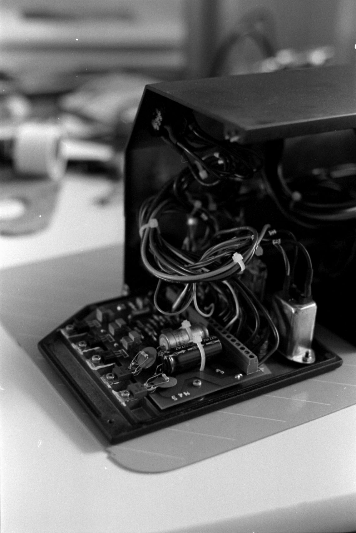

I now noticed the "round pin 2.jpg" file that Mitch attached in this thread, that shows the component layout of the 500S power supply, and that differs slightly from the documentation that I have for the power supply that comes with the 500CPM controller, according to the file name given by Mitch, also uses the 7 flat pin and 1 rounded pin connector.
Also, I have now dug up two photos of the inside of my older version 500S power supply, and it isn't consistent with Mitches posted component layout of the 500S power supply, and neither as I already knew, with the Ilford documentation for the 500CPM controlled units...
Just look at the position of the two large capacitors (the "beer cans", wrapped down with a plastic strip on the printed circuit boards), they are orientated at 90 degrees from what is visible in the both component layouts as described above (denoted as C1 and C2 in the component layouts).
This actually means there have been THREE different versions of the 500S power supply for the Ilford MG500 exposure system, two versions using the 7 flat pins and 1 "rounded pin" in the plug connecting the head, and one version like mine, using 8 flat pins...
The 8 flat pin versions are probably all controlled by the 500C controller, whereas the MG500 units with 7 flat pin and 1 rounded pin connectors for the heads are 500CPM controlled, but maybe also some units by the 500C controller.
Well, I hope I haven't lost to many people by now, my own head is spinning :wink:
So we still need the component layout for the "8 flat pin" variant of the 500S power supply, like mine, too... we do have the circuit diagram luckily now :wink:
Attached images below are from the inside of a 500C controlled 500S power supply with an 8 flat pin connector socket to connect to the enlargers head.

George, you are right they significantly changed the wiring in the cable from the power supply to the enlarger head.
In the 7 flat pin, 1 round pin connector the connections are:
- Pin 1 is the ground
- Pin 2 30V AC
- Pin 3 seems unused...
- Pin 4 is connected to the 0V and switches the cooling fan in the head by means of relay RL2/1. Relay RL1/1 switches the safe light.
- Pins 5 & 6 120V DC enlarger head lamps
- Pin 7 & 8 should be 120V AC for fan
According to the notes written on the scans Mitch posted, and that seem to be OK after a quick verification:
In the 8 flat pin connector the connections are:
- Pin 1 120V AC for "Lamps common"
- Pin 2 120V AC for fan
- Pin 3 120V DC for the blue light in the head
- Pin 4 120V DC for the green light in the head
- Pin 5 0V or "Mains neutral" as written on the schema
- Pin 6 seems unused
- Pin 7 30V AC
- Pin 8 is the ground
Correct me if I am wrong George! (or anyone else seeing something wrong)

It looks like the pins on the new connector should connect to these wires on the old head:
1 to 8
6 to 3
5 to 4
7 to 2
4 to 5
8 to 1
1 to 8
6 to 3
5 to 4
7 to 2
4 to 5
8 to 1
Is it possible that one diagram shows the connector from the front and the other from the rear? These figures show a complete reversal of the connections. Rewritten in numerical order, it is more obvious:
1 to 8
2 to 7
3 to 6
4 to 5
and therefore:
5 to 4
6 to 3
7 to 2
8 to 1
Steve.

idon't have the diagram for the 500c controler. they where sent to me by someone else. i will ask if they have it. they where worried about posting the diagrams due to copywrite issues, i emaild simon at ilford for premission but haven't heard back yet but still posted it hope they don't mind. so are you guys saying just change the wire pin places and it should work?
