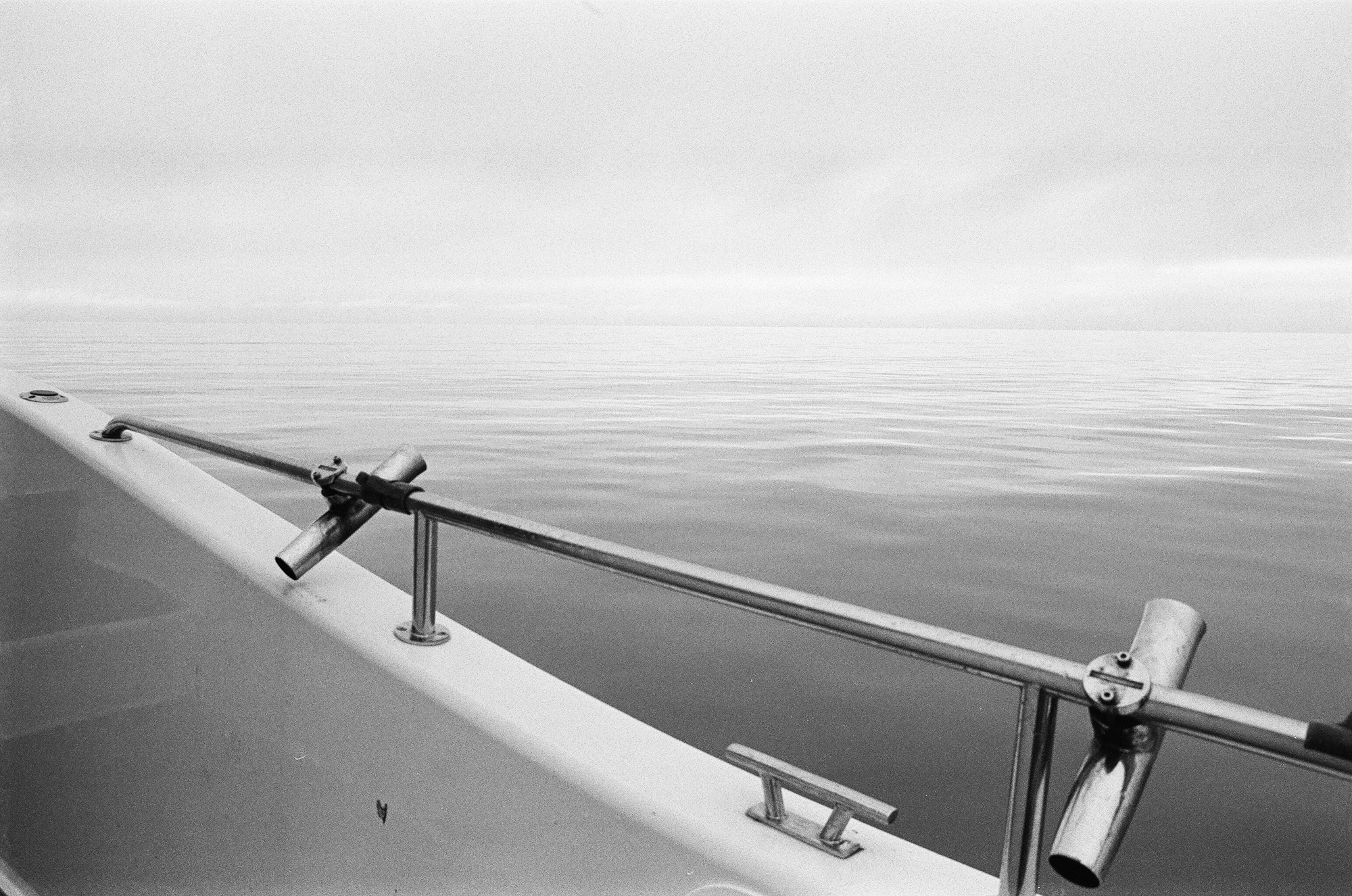

For comprising, this is also expired film but super 8. To my eye a lot better.
Adox pan f, negative developed with xtil a few weeks ago.

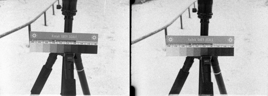

Assuming you metered for middle grey and not the whole scene, which would bring your highlights down, your shadow detail looks okay considering the tripod is probably black and seems to match the 1.25/1.55 square. If you want the 0.0 square to be pure white you may want to develop for longer, though you will start to loose detail in the snow. Consider the contrast of the lighting in this scene before you apply that as a rule across all your rolls.
Check your negatives too, as if its expired film (as 10 years in the fridge suggests) you might be getting fogging which can affect density all around. The lighter edges koraks mentioned could also be symptom of fogged film (uneven density).

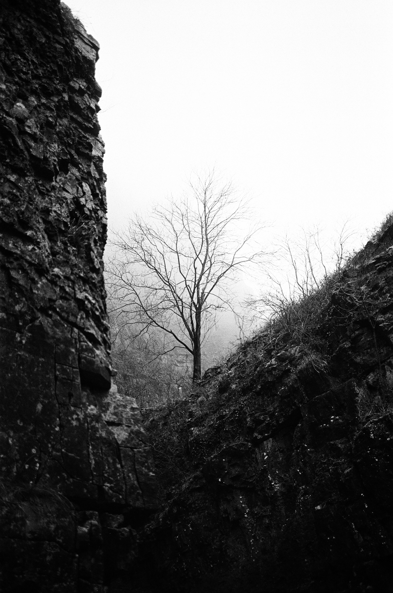

These two shots are straight from the scanner, 135 format (5222), shot at ISO 400, developed in 1+19 dilution at 20C for 6mins using a paterson tank. One shows the shadow details and the other the highlight details I got with this roll.

It looks very good to my tast. My film have always been in refrigerator. I might just use it for test of new cameras if I don't get better results.

I really couldn't say. Here's the first image you posted together with the 10-minute example (top frame):
What's better in the 10-minute frame is that the hot edges are gone. So that's good.
What I did with the 7-minute frame is simply adjust contrast to match the 10-minute frame. There are some subtle differences in rendering. Overall, the result is pretty similar.
What I hope to have shown above is that trying to figure out the best development time while ignoring what happens in the scanning and digital contrast adjustment part of the process isn't a particularly useful endeavor.
