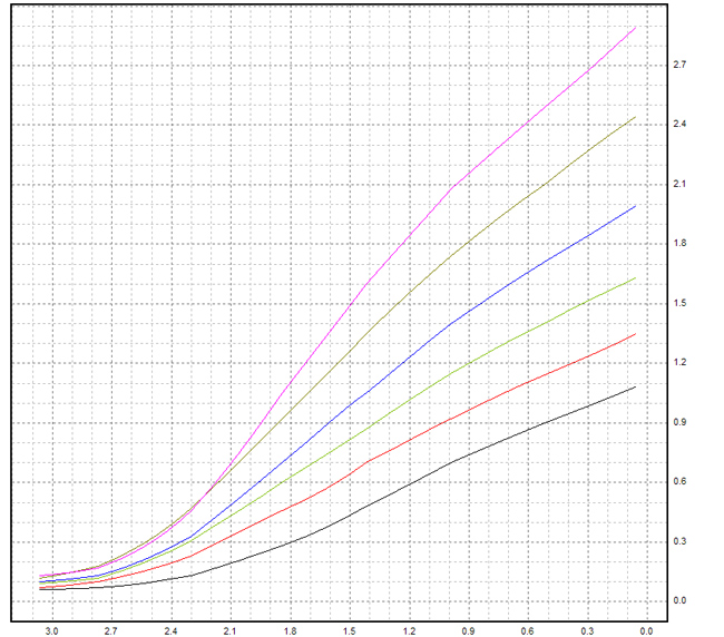

I just finished my first BTZS film test and was wondering if someone could tell me if it looks OK, since I don't really know much about this.
Ilford Delta-100 developed in Xtol 1:1
Thanks!!!

Hi Jim,
Looks like very good work from here.
Just remember to keep the variables constant if you want to make meanginful comparisons of different films or film/developer combinations.
Sandy

Thanks Sandy.....
Jim
