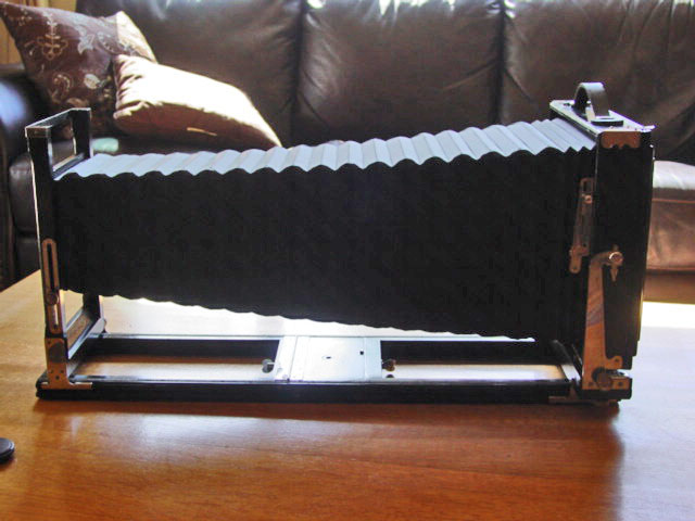

I have the same Seneca camera. You made a good find. The bellows on my camera were shot as well and I had them replaced by Western Bellows. I'm not sure if Western Bellows is still around. However you can also get replacement bellows at Custom Bellows in the UK.
For bellows replacement you would need to send in the bellows and wooden frames not the whole camera. You will need to unscrew the bellows frame from the front standard, and unscrew the rear frame from the rear standard and send the bellows with frames in for replacement.
My 6 1/2 x 8 1/2 Seneca is the Improved Seneca View - Maximum length with rail extension 26 inches - Weight 7 1/2 lbs. The camera is not that much larger than the 5 x 7 Seneca version and only one pound heavier. The camera is reasonably rigid at full extension.
I would also recommend that you disengage the bellows support arms that are on each side of the bellows, and simply wire them out of the way.

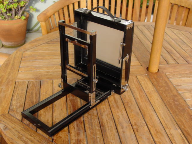

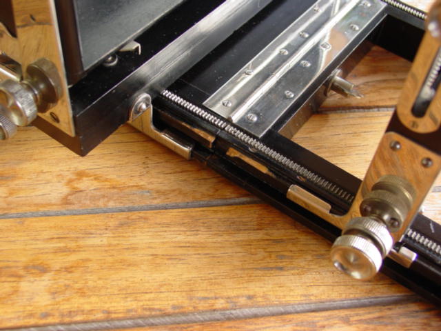

See photos bellow of my Seneca before and after the bellows replacement.
Let us know how you make out....

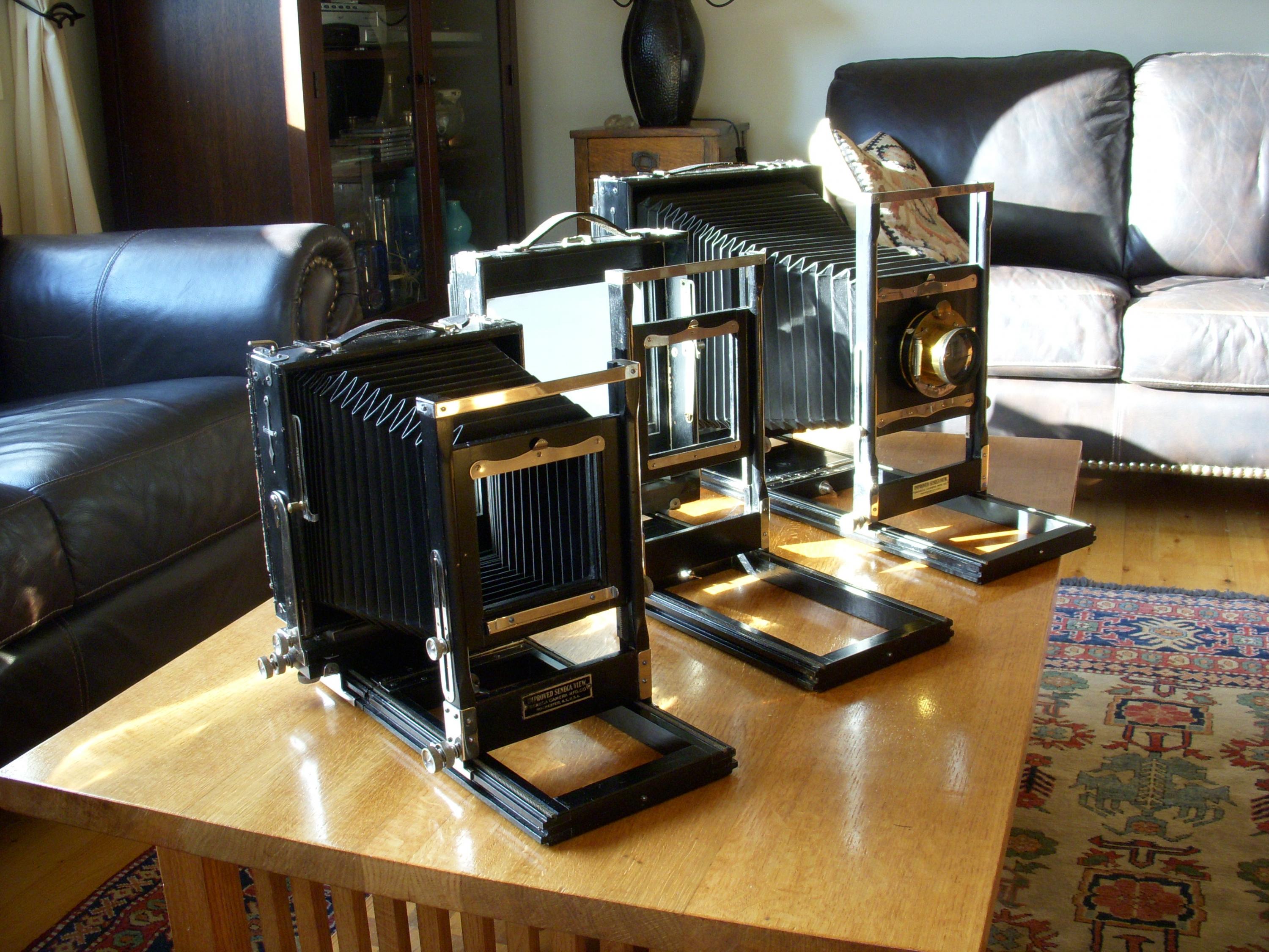

To inspire Seneca owners with old cameras languishing in the closet to get out and restore and use them, here are the specs from the 1918 Seneca Catalog for four sizes offered for the Improved Seneca View Camera. The long bellows draw and the light weight are perfect for field use.
Size: 5 x 7 Length of draw: 23 1/2 inches Weight: 6 1/2 lbs.
Size: 6 1/2 x 8 1/2 Length of draw: 26 inches Weight: 7 1/2 lbs.
Size: 8 x 10 Length of draw: 30 inches Weight: 10 1/2 lbs.
Size: 11 x 14 Length of draw: 39 1/2 inches Weight: 18 1/2 lbs.
Pictured are three Senecas, 5 x 7, Whole plate and 8 x 10. Notice that the whole plate body is not that much larger than the 5 x 7.
The whole plate and the 5 x 7 Senecas share the same width rails. There is a jump in rail size to the 8 x 10 body. Still a very manageable weight at 10 1/2 lbs.
Also check out the Kolb Brothers online and visit their studio and museum at the Grand Canyon. They used an Improved Seneca View to photograph the Grand Canyon in the early teens and twenties. A Seneca View is on display at that museum.
