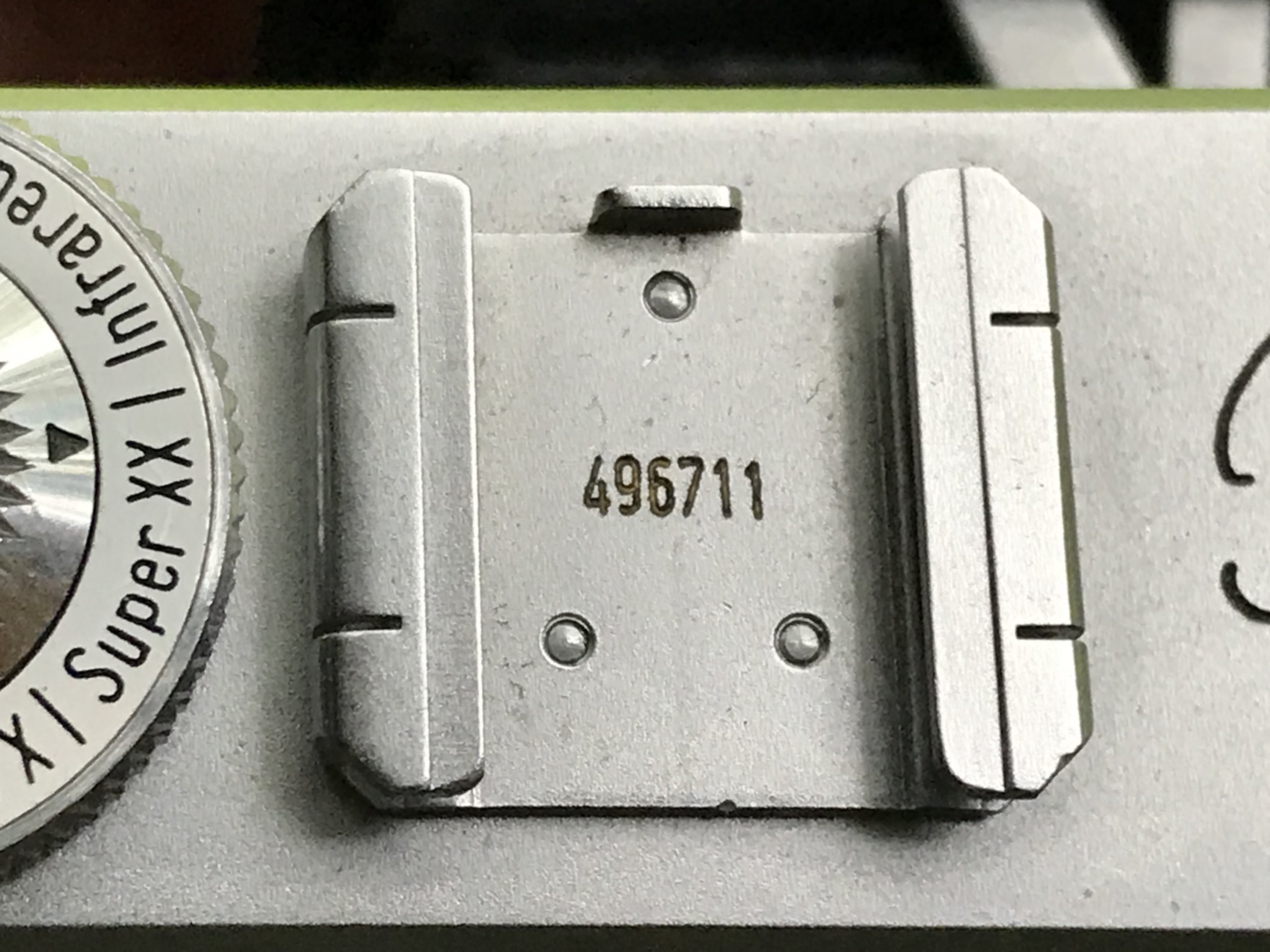

Regarding preventative measures to avoid problems with the film advance/winding mechanism - question about the mounting of the accessory shoe: are the three screws mounted from the top/exterior of the camera housing, or from inside the top cover? See the photo, which shows the screws mounted from inside the top cover.
If the accessory shoe is mounted in this configuration, be sure all three screw tips are visible as shown in the photo I attached. If there is an empty hole in one or more of the accessory shoe screw holes, then the screw has backed out and is floating inside the top cover somewhere. If that is the case, then at the very least the camera needs the top cover take off, find the misbehaving screw and put it back where it belongs. Now, taking the top cover off is fairly straightforward, but it requires the removal of the winding lever, and that has to be done in a very particular way. But I am getting ahead of myself - first determine if the screw are all present, and if not, then ask me for further assistance. If the crews are mounted from the exterior of the camera, then you don't need to worry about the "loose screws" issue.

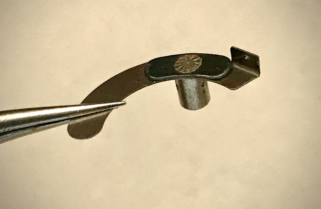

By the way, do you know if the frame counter works? Does it count up with every winding and firing of the shutter? There is a tiny "spring" inside the film advance lever assembly that has to flex with every counting of a frame, and it inevitably weakens with use and the tip breaks off. What that means is that the camera no longer counts frames as you go through the roll, but otherwise it doesn't adversely affect the functionality of the camera. Replacement springs are available from Micro Tools USA but they are extremely expensive (undoubtedly more than you paid for the camera!), so most times, people opt to live without a functioning frame counter.

The potential problem is the one I somewhat vaguely alluded to: if sand or loose screws get into the gearing that is underneath the advance lever (which drives the cocking rack, which drives a shaft that connects to the second rack that cocks the shutter) then you can damage the cocking rack in the top housing. However, that problem is far less common than the popular mythology would suggest. The most typical problem arises if the user reaches the end of the film, and attempts to force the lever to cock the shutter, which will only result in damage to the teeth of the cocking rack and/or twisting the shaft that runs through the film takeup spool. If the user understands the camera and how it works, then there is very little risk of "user-induced" damage.
If the camera is clean and appears to function well, then the odds are you can use it freely for years without much concern. But should you find one day that the shutter sticks open at 1/2 or 1 second, you know its time to have it properly serviced. A sticking shutter is the canary in the coalmine: there will be more in the camera that needs attention. Usually its just a matter of cleaning off old grease and putting it back together correctly, but it does require a full tear-down of the components and a thorough degreasing of parts.
This, by the way, is what a broken frame counter spring looks like. At the upper right end of the component is supposed to be another piece of metal, protruding at an angle. In this instance, it is broken off, from metal fatigue. frame.counter.spring.jpg

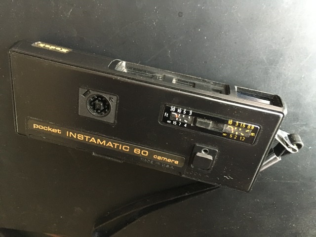

Would love to see what a Kodak Instamatic 60 could do with Ektar 100 (the current stuff) or T-Max 100 or even the new Ektachrome.
Donald Qualls
Jan 19, 2005
12,545
North Carolina
Those had a good lens, adequate rangefinder focusing, two-value film speed detection (based on notches in the cassette). But no way to override exposure.
They worked very okay, and still do if you have a cassette you can reload. They also don't depend on the numbered backing or the little "finger" -- so you can try them with Ektar if you want. It's about a quarter of a 35mm frame.
