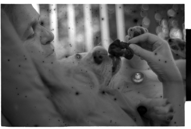

What happened here? I've been developing my own B&W film for about a decade, and have used several bulk rolls of ORWO UN54 in the past w/ various developers w/o issues. Suddenly then, midway through a 400' bulk roll, I start getting these wrecked negatives full of dots, ect. Eight rolls ruined; doesn't matter if it was Rodinal (both stand and full), Clayton F76 or HC110. I ruled out water, chemicals, contaminated tanks, and it doesn't look like lights leaks during the loading process. Are these air bubbles? With a new pup sleeping in the house I was possibly tapping the tanks less hard, but then my wife says she never taps the tanks during development, albeit with Foma. Thinking it's defective film, I started de-rolling and chucking the film out, but maybe it's me. Any advice would be appreciated. Thanks in advance.

No problem with other films using the same chemicals, water, equipment and technique. The intensity of the spotting is random throughout the roll of film but similar with all the developers used. Strangely, some rolls film from this very same 400' bulk roll have developed fine. Which made me think I'm doing something wrong in developing or I loaded cassettes wrong, or maybe just part of the bulk roll is bad. The cassettes themselves have been used with other film w/o problems. True enigma.

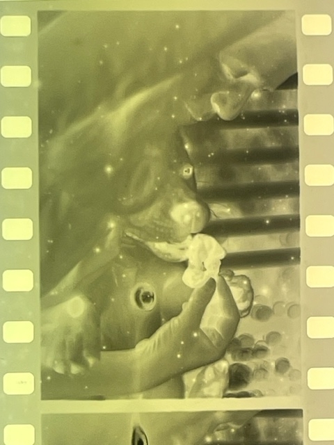

Could you post a clear photo of an affected negative on a light table that shows the defect as it appears on the film itself? Perhaps that gives a clue.
That helps.

The image on the light table does indeed show the defect clearly, but other than that it's indeed a minus density anomaly, it doesn't give away much else.

EDIT: looking closer at the negative in post 6, in the top left I see a blob that crosses the frame edge and it looks like an area of lesser density in both the exposed and non exposed sprocket hole area. I'm suspecting that the cause is chemical, rather than mechanical like dust, just because it affects both the image and non-image areas.
I think that dust on the film before exposure would be sharply defined on the developed neg. These spots are fuzzy and dissipate towards the edges of each spot.

On your pics of the negs the spots have even lower density than the film rebate. Almost as if there was no emulsion in the spots to be developed.

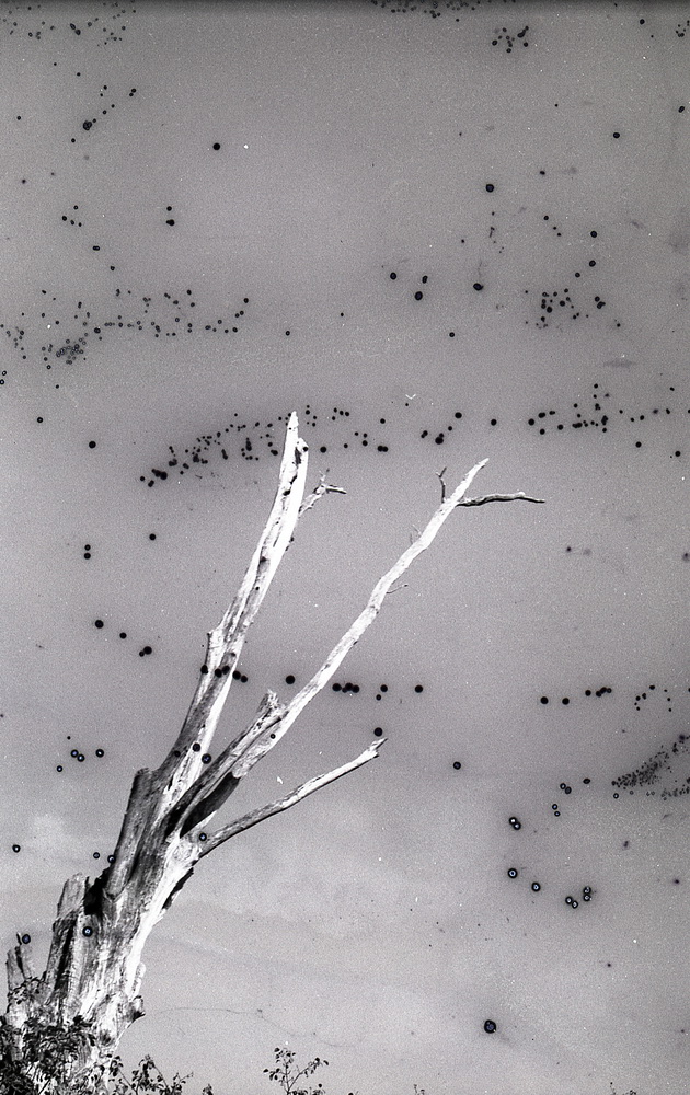

I posted on it, so it's 5-6 places down on the normal threads of this subform. It's from April, 2018; not sure how to link it. Looks to be a similar problem, same film, though OP there thought it was developer specific.
That is mold. I have developed lots of moldy film. The last stuff was on rolls that I got from a guy - he'd bulk rolled them then put them in the door of his freezer (in the fridge). Every roll got moldy. Mold eats the emulsion - it likes the gelatin. I had mold that looked like that on tmax 100 that was in a bulk loader someone kept in a fridge. Things can go moldy in a fridge.
It's visible on undeveloped film. Look for areas that are discoloured.
