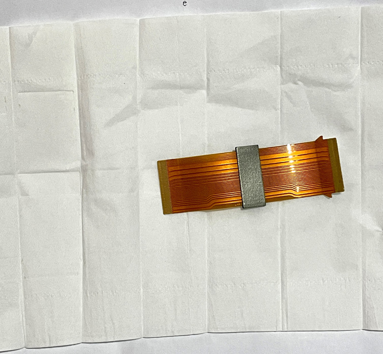

HELP!! The sky has just fallen (not really, but I just broke the ribbon flexible cable in Nikon Coolscan 9000ED!!!)

Any competent person with EagleCAD or KiCad could make you a replacement flex cable and have it manufactured by PCBWay.
If your halfway savvy with computers you could learn KiCad or EagleCAD (PCB Design Software) in a week or less enogh to and make your own just via youtube.
The hardest part would be that you want to measure your trace sizes (or) just scan the ribbon with a flatbed scanner, adjust the scale in illustrator or other free vector program and then you can trace the original traces and use that image in KiCAD to replicate it, etc.
Sounds way more complicated than it is but its just
1. Scan your ribbon
2. Make sure its to scale
3. Make a black / white vector mask of it.
4. Use that image mask or measurements to create your traces in PCB design software.
Hell you might even be able to find someone on Fivr or other freelance site to do it for you for a small fee if you provide them with a scanned image of the ribbon to scale (or include a ruler so they can scale themselves).
You're right, I missed that: https://www.pcbway.com/flexible.aspx
That's actually not so critical for the thin traces; only for the wider ones, and there it's perfectly OK to err on the wide side. Connector pitch is the critical parameter.
Good suggestion; this approach should work at relatively low cost.
That'll be flaky at best, but anything is worth a try.
Odds of the machine working with no intervention / repair: 0%
Any solution that increases this percentage is an improvement over what he's got.

Update: my Coolscan 9000 sad story has just ended, in the most unexpected but happy way!
Out of sheer kindness, someone made an exception and sent me an original replacement FPC for the Coolscan🙏 I carefully (but quite nervously) installed it and only after the second attempt, the Coolscan sprang to life!! What can I say. I am overjoyed and really very grateful !
There are still beautiful things in this troubled world, such as this act of kindness.
By the way, a member of fb Nikon Scanner Users group has recommended a generic FPC that is said to be compatible with this Coolscan FPC. I have ordered it through Digi-Key but have not tried nor verified it to be working personally. I shall list the info. here just in case anyone who might need to find such a replacement part: Molex part number 0151660429
Thanks everyone here for all the great advice/suggestions. Much appreciated.
yossi
That's great! I'm happy to hear your Coolscan is working again :smile:
The original cable will be superior in terms of noise performance. Firstly, it has a ferrite core around it to quench some HF noise. Secondly, the power supply traces on the original cable are wider, which reduces their impedance and this is also beneficial to s/n ratios. The Molex cable might work OK, but it's conceivable that the visible noise in the scans is increased. The cable you were kindly gifted is the best solution!
