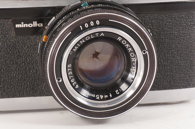

Here's a shot of the lens in question. I would have thought that the name ring would come right off but as I said, it threads out part way and is then stopped hard by something. I was then thinking the silver ring had to come off first and that I could access it by removing the outer ring. You can see the two holes where I removed screws (they came out easily and didn't feel like they'd been glued). I just don't know the proper order to be sure I'm not fighting myself. If that outer ring needs to come off then I'm thinking maybe the screws were glued in the past and some of that glue could be holding the ring. Maybe a drop of acetone in each screw hole to bleed out and dissolve what might be there?

I believe the Silver ring must be removed to unscrew the name plate ring. The name ring most likely only holds the front lens element in place.
Look closely at the front ribbed ring for small gaps that may have set screws. If there are set screws set the lens to infinity before removing anything.
