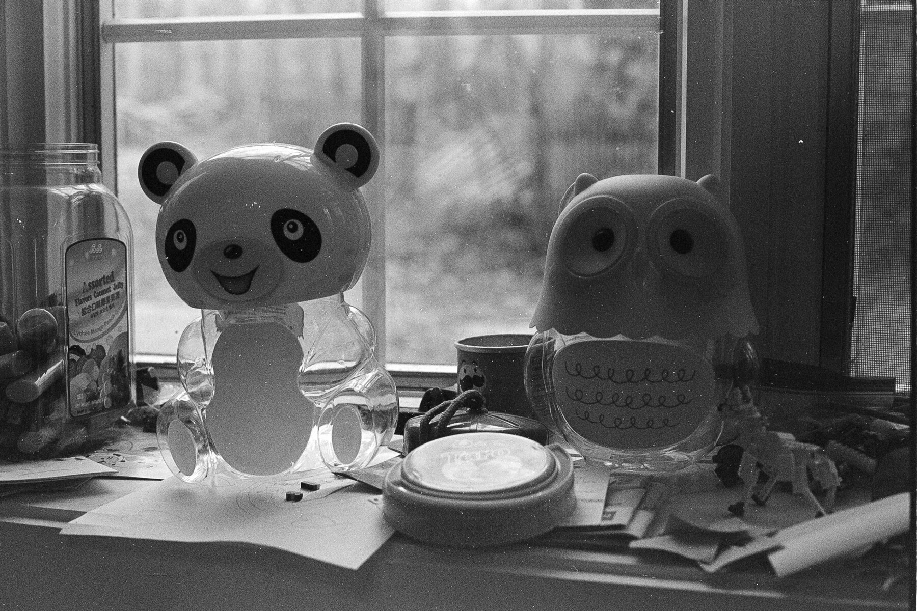

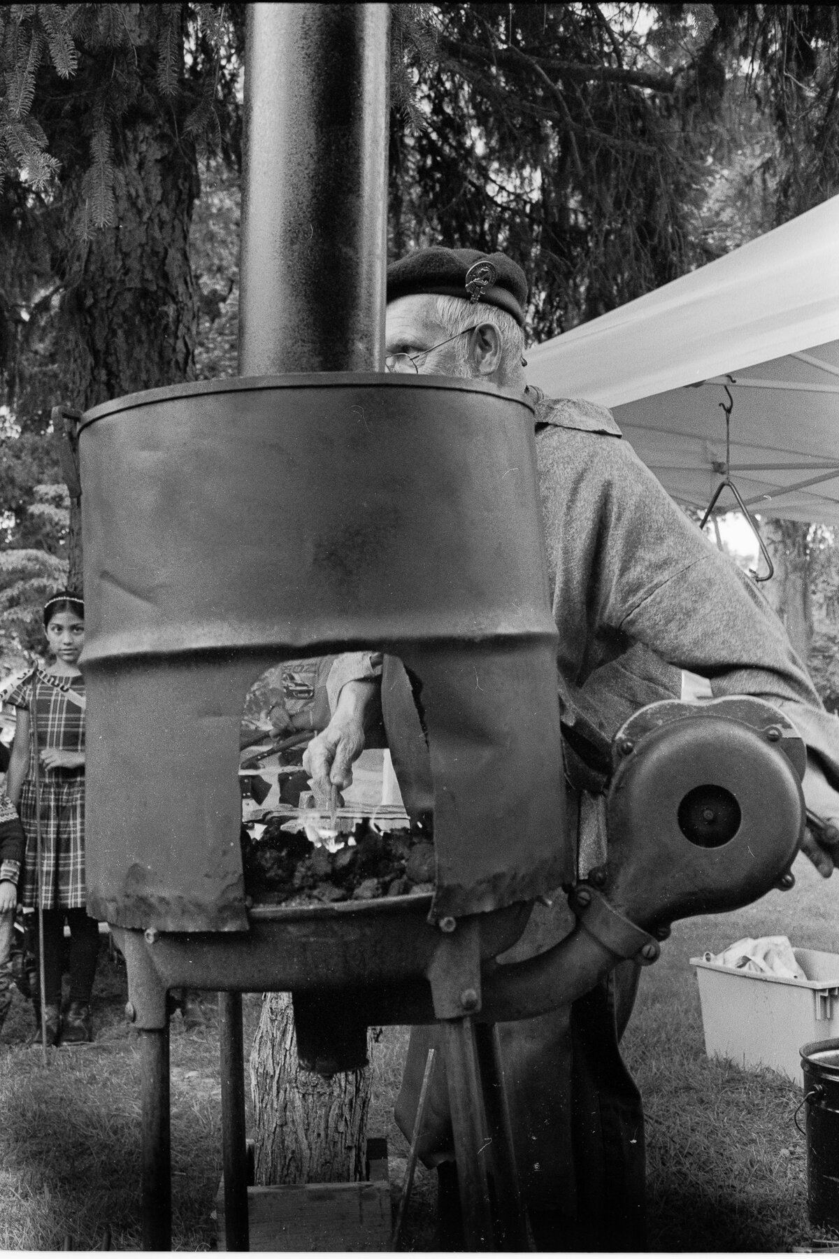

Hi folks,
Been lurking/learning for a while and joined to request some advice. I've shot and developed over 100 rolls of film, and am no stranger to the common mistakes and pitfalls, but lately have encountered an issue that I would like to run by you all before I invest more time, film, and chemicals into diagnosing and testing.
The short version of my story is that I am getting significant black specks all over my negatives. They did not stand out to me when I was shooting largely medium format last year (but they are present), however last fall I got into bulk rolling 35mm film and the enlargement of the smaller negatives revealed significant black specks all over the negative which appear as white "snow" on the inverted scans.
My development process has become about as clinical as I can make it at home. I started using distilled water for the entire process (chem mix [if powder], dilution, final rinse, and wash aid), spending almost a gallon of distilled water per roll of film (I use the ilford method, but the black specks appear with running tap water 10 minute rinses too). I rap the tank after inversions to clear bubbles. I switched to a 10 micron chemistry filter to filter both fresh and re-used chemistry. I started fixing longer, I tried hypo clear. I run the shower till the bathroom is completed fogged with steam and dry my negatives in the shower inside a zippered garment bag that was open and exposed to the steam. Although some rolls/frames were better than others nothing I did reduced the specks to a "normal" amount of dust (eg the same levels I see when I send my film off to a lab). When I inspect the negatives with an 8x loupe I can see the black specks all over. I have used over 7 different cameras, 5 different developers (Xtol, DD-X, Pyrocat-HD, Flic BW&G, Rodinal), and different brands of fixers (llford Rapid Fix, TF-4) and many film stocks (Foma, Kodak, Ilford, Lucky). I have loaded in a dark bag, a dark closet, and (for test rolls) in broad daylight. I deep clean my darkroom equipment and even ran them through the dishwasher by themselves (which had no effect--didn't make things worse or better).
I know this is a post in a B&W topic but this issue persisted (and in some cases was worse) for C-41 development. Digital ICE wasn't removing them (they're baked into the emulsion). Finally I noticed that on the home developed negatives done with plastic reels and tanks these specks are nearly completely absent. About mid-way through last year I switched from plastic to metal tanks and all of my negatives from that point onward have this issue. So I think I found the correlation but I can't determine the cause. I switched to metal to save money on developer and because the film stocks I prefer often get bunched up/creased in the "push" winding for loading it on the plastic reels. When I switched to metal reels (pull winding) I stopped ruining rolls of film during loading (particularly Svema, Foma, and Lucky which have very thin/curly bases), but have many almost unusable rolls of 35mm film due to the specks.
I have included some samples. The blacksmith is T-Max developed with DD-X 1+4. The owl and panda photo is Foma 400 developed with Eco Pro Xtol 1+1. Both were soaked in Kodak PhotoFlo 1.5:200 (which seems to leave the least amount of scum on the negatives but I have these specks whether I use PhotoFlo or not). I am also including an IR scan of a C-41 negative which exhibits the black speck issue most clearly. Out of desperation I squeegeed that roll (Fuji USA 200) and still experienced the black specks. The last image I have included is an IR scan of the last frame of a non-squeegeed roll of C-41 film (Kodak UltraMax 400) which has a ridiculous amount of gunk on it. I have noticed that the specks often (but do not always) accumulate on the lower frames of the roll (as they are hanging). For example the Fuji 200 roll's last frame is ironically nearly pristine. Re-rinsing and re-fixing does not remove the specks.
What do you think is causing this, and why is it worse for metal equipment vs plastic?

Well... it's dirt. Given what you say, it's probably the reel, the tank, or both.
Do you use more than one metal tank? Which brand and model? And are they new or used?
I wondered about the garment bag you use for drying. Could it be shedding whatever it is made of?

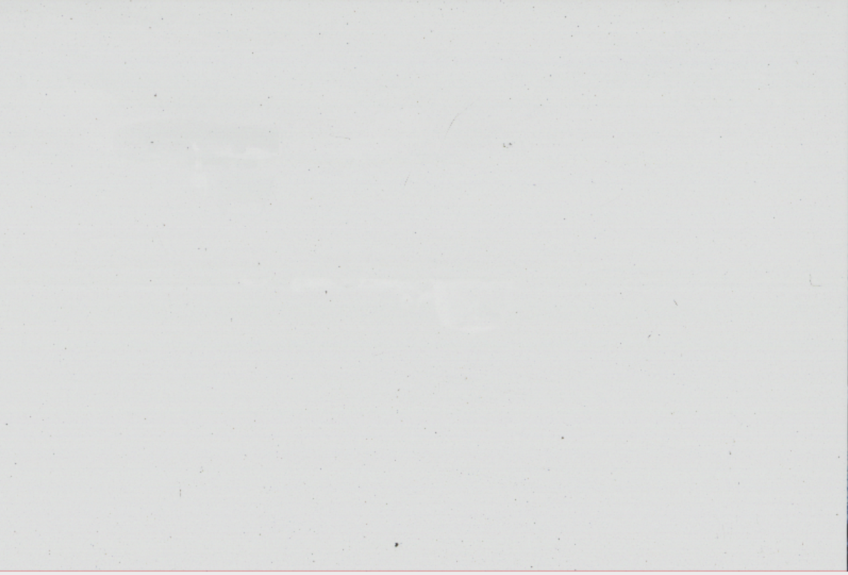

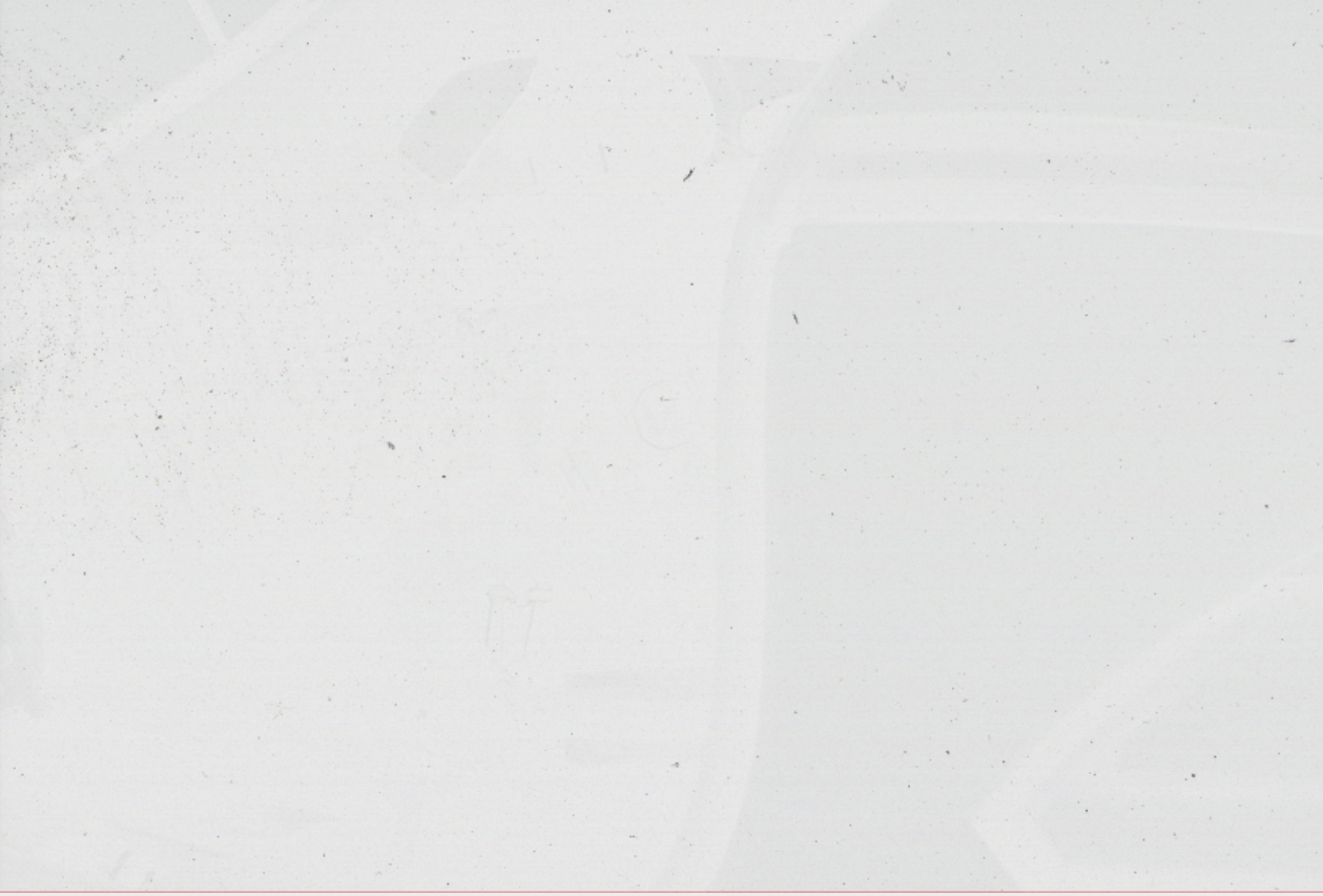

I would prefer to see a scan of a negative.... Are you able to determine which side the black specs are on?
I've attached a raw scan from VueScan and the inversion. Foma 400, Xtol 1+1 9:30 @ 20C. The specks are in the emulsion as they do not wipe off the base side with IPA. They do sometimes wipe off when I wipe the emulsion side--often at the expense of the emulsion.

Still sounds like particles of sulfur from old fixer. I'd check that again and carefully. FWIW it doesn't matter that the fixer is unused. If it has been stored too long, it can still sulfer-out.
If that's not the problem, then look for something similar in your other chemicals. Particles of undissolved chemicals in your developer, stop, hypo-clear, unfiltered tap water, etc. If that's all clear, then it's on to looking for airborne particles.
On the off-chance that it's a problem with the film, snip an unexposed piece or take an unexposed sheet and examine it carefully under magnification.
Then, there's always particles from degrading light seals, shutter curtains, etc. in the camera. Check those too.
If all that is good, I can't think of where else to look.
Good luck!
Doremus

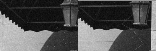

Thanks, @Doremus Scudder, @koraks and everyone else for the troubleshooting rubber ducking. Over the weekend I washed all my equipment first with 5% vinegar, followed by calcium carbonate, followed by household bleach, followed by fixer (the last two per Kodak's instructions) with a water rinse between each chemical (very important!).
I appear to have significantly reduced the particulates embedded in the emulsion on a B&W negative developed with DDX and my freshest (8-month old) fixer. The ones present here across two scans mostly wipe off with a dry antistatic cloth, and the remainder appear to just be micro dust on the surface (I can no longer see them with a loupe like I could before). I've scratched up the negative on the second image due to using the children's microscope on the base side (must be some hard plastic in that microscope! 😄). When I inspect the emulsion directly I see different specks compared to the base side. I'll now work on dust mitigation during scanning.
The next step will be to do a test roll in XTOL again and C-41 to see if there's any other contamination issues before concluding that I've identified and resolved everything, but this is the most promise I've had in weeks! I also plan to buy a finer paper filter to really comb out any sulphirization compounds in the C-41 kit (since it's reusable).
