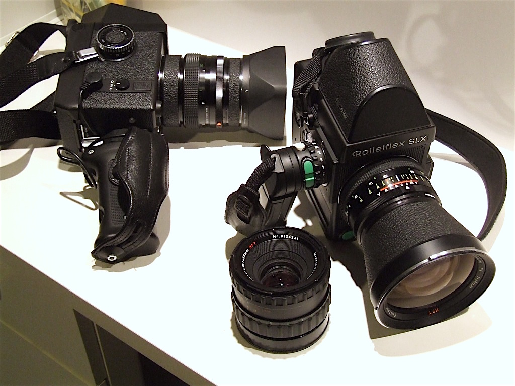

I didn't make a thread "The power of volts and milliamps" because I was sad. I really get rejuvenated and excited in medium format photography every time I rebuild battery packs. In fact, after the 2013 rebuild I was so excited I bought a 6008i. In all the years of experience with that dreaded Rolleiflex battery pack (since 1984 for me) It seems like 2/3 of the time I have all those same experiences you have in your post. This is interspersed through time with one to two year periods of fun with fresh batteries!
For example, even being experienced in these batteries, I still got 'bitten.' In 2011, it seemed my 33' extension release stopped working. It cleaned the connector with DeOxit and even took the hand piece apart and cleaned all the inner contacts. It still did not work. Like you, I was confident my battery was still good, because it still fired the camera. WRONG! The 33' cable release needs a fresh strong battery. After my 2013 battery rebuild, like magic, the 33' extension release worked again!! I'm glad I gave it a second chance, otherwise that rare cable would still be in the 'box of broken things.'
Also, to point out that batteries need to be checked under load in every day life. Just yesterday my wife's garage door opener stopped working. I'm teaching my son these things and showed him how to measure the 3V battery in the device. It measured 3V and he was stumped. Then I asked him to keep the probes on the battery and press the button on the device. The voltage plummeted to 0.5v! Now he knows dead batteries can read full nominal voltage when not under load.
