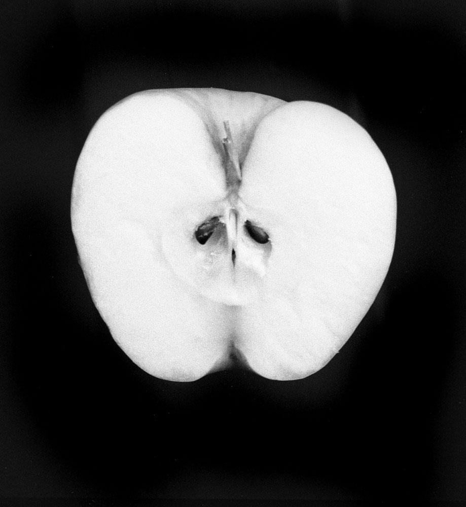

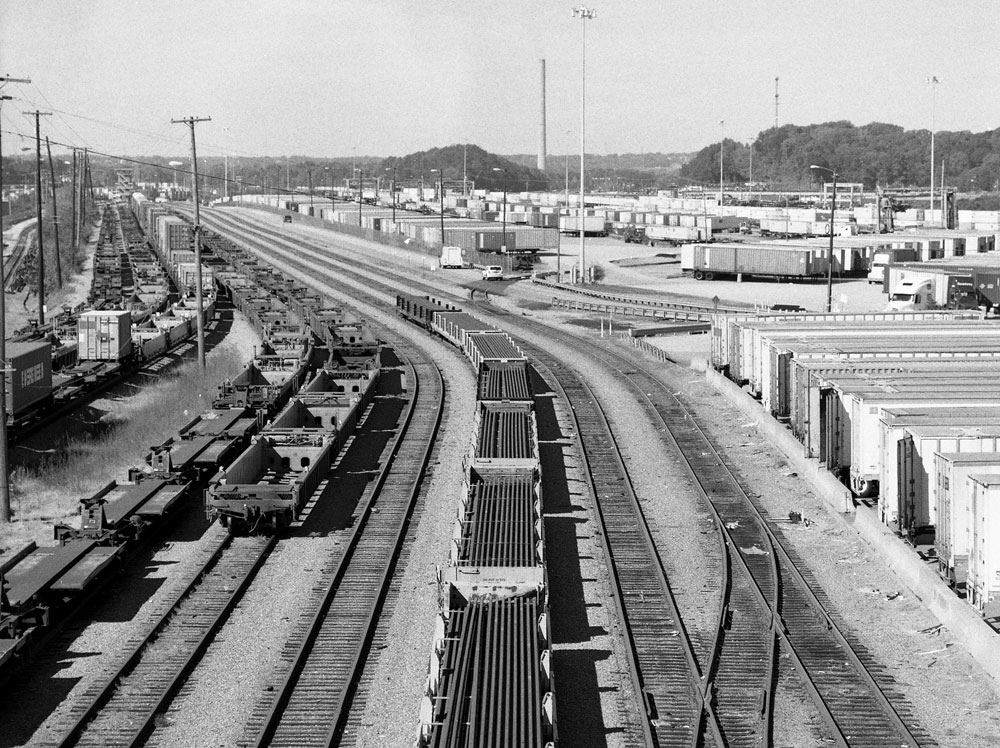

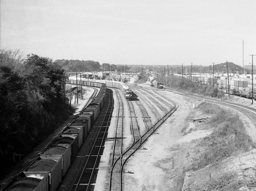

Here are three shots off the roll shot at ASA 100. I used HC110 1+50 7 min @20C.
They turned out ok???
The apple shot is different than the one I use for my avatar.

The exposure was the same. The angle of the shot was slightly different. #1 I was turned slightly further away from the sun. I used a hand held meter to set the exposure...I don't remember what the exposure was???
