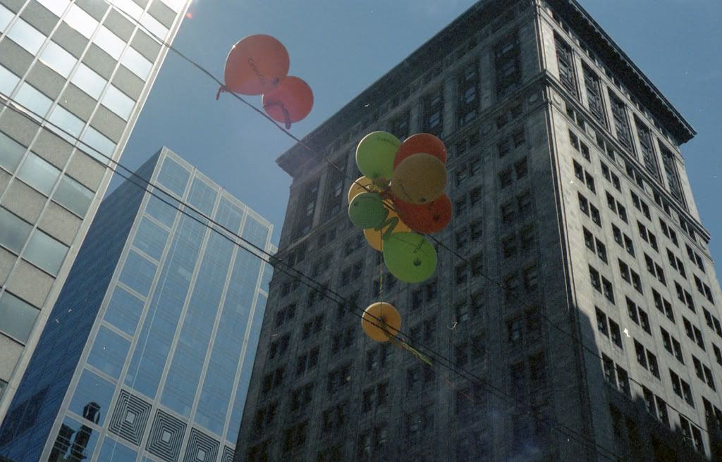

I recently bought packs of expired Portra 400 VC and 400 NC off eBay. I knew I was taking a chance, but when I shot with the film this Saturday the results I got back were truly atrocious :sad:
I've included sample images in the two posts below. I metered as if the film were ISO 320, and had the rolls were developed at a local supermarket minilab. I've used them before for consumer film (Superia X-Tra 400, supermarket-brand 400, etc.) and I've never seen results like this. The scans were done on an Epson V500 with Digital ICE on the Quality setting and Low USM. No color corrections were done.
My questions are:
  1. Is it operator error? Did I simply misjudge exposure really badly? I know I'm no human light meter, but I don't think that my exposures were so far off to cause these issues . . .
  2. Is it the film? Frankly, this is what I suspect. It was sold as "cold stored", and the eBay placing did say that the film "shoots perfect", but maybe I simply got greedy and got hosed. Is what you see below characteristic of the effects of aging on film?
  3. Is the lab? I doubt this because I've never seen anything like this with the other rolls I've had processed there.
I'd really appreciate any opinions on this. It's frustrating - I thought I'd taken some decent photos on Saturday, but looking at the scans many are writeoffs. I can live with a fair amount of grain and color speckles, but what I'm seeing below seems over the top.

400NC Images
400NC, Roll #1, Image #1, 100% Crop
400NC, Roll #1, Image #1, 1024px
The shadow detail looks really, really muddy here.
400NC, Roll #1, Image #2, 100% Crop
400NC, Roll #1, Image #2, 1024px
Apologies for the threads and other crap on the scan. Don't think it matters anyway, since this photo looks destroyed.
400NC, Roll #2, Image #1, 100% Crop
400NC, Roll #2, Image #1, 1024px

400VC Images
400VC, Roll #1, Image #1, 100% (Overexposed 2 stops)
Yes, it has camera shake and subject motion.
400VC, Roll #1, Image #1, 1024px (Overexposed 2 stops)
400VC, Roll #1, Image #2, 100% ('Correct' exposure)
400VC, Roll #1, Image #2, 1024px ('Correct' exposure)
400VC, Roll #1, Image #3, 100%
400VC, Roll #1, Image #3, 1024px
400VC, Roll #1, Image #4, 100%
400VC, Roll #1, Image #4, 1024px
This one is the worst on this roll for color grain.

Dear allen_a_gorge,
It looks like old, poorly stored film. I purchased some cheap 400UC and got similar results (I was leery about the storage but I just couldn't resist the price). Other purchases of outdated color film have been better. Save it for the right project.

It does look like very underexposed film. So it seems to have lost a lot of speed. Prehaps it needs to be metered at 200 ISO or lower to get decent results

It looks like there's more going on here than poorly stored, expired film. I just shot some 400nc that expired 4 years ago. It's been sitting in 5x7 holders in a warm apt. all summer long. Compared to fresh 400nc it's about 1/3 of a stop less fast and 10pts. more magenta. Your examples look like they suffer from both fogging and crappy processing. Unfortunately shipping film these days is a little like playing russian roulette. USPS is a very bad idea as I've been told they xray all parcels. It used to be that fedx could say they did not subject packages to xrays. Now they can not say for certain that a package won't be subjected to xrays. The graininess of the images points to problems in processing. Have you tried making a conventional cprint?
Just to be clear - fogging is a general loss of contrast right?
Oh - this could be a real problem then. I had the film shipped by USPS to Canada (since UPS absolutely hoses us with brokerage fees). But I thought that x-rays weren't necessarily a huge problem with 400-speed film. . .
No, I haven't. I'm curious why you ask though.

There's both chemical fogging and light fogging. Wikipedia has a fine entry under fogging (photography). Interestingly there is mention of the problem of silver staining - chemical fogging most commonly due to exhausted fixer. It is the bane of poorly maintained roller transport processors - the sort of thing I'd expect from grocery store processing in the year 2008.
When I have developing anomalies I like to inspect both the film and a print. There's so much image transformation going on in a scan that I feel you're oftentimes getting more than the whole story, especially when using software that cleans up the image like digital ice. But I suppose that this is just prejudice as I'm hardly ever scanning directly from negatives and when I do it's usually a lab that does it.

I have not noticed color changes or exposure issues, when using Digital ICE. Also, when I did the scans I turned the color adjustment to the 2nd lowest setting - so Epson Scan is doing almost no levels adjustment, saturation or color changes. One can only imagine what these pictures look like at the lowest setting . . .
I've decided to sacrifice a roll each of the VC and NC (something I should have done right at the beginning) for testing. I'm photographing in a variety of lighting, bracketing each shot as if it were 320, 200 and 400. I suspect the film was simply stored poorly and that it has lost a full stop of speed. But there's a lot of inconsistency - some photos are smooth while others - even those taken in bright sunshine - are extremely grainy. And it really looks like dark areas are a real problem.
While I'm sure the lab isn't the greatest, here are samples from 'fresh' 400-speed consumer film that I gave in for processing at the same time as the 400VC and 400NC:
Life 400, #1, 100% crop
Life 400, #1, 1024px
Not great, but certainly nowhere near the grain of the photos above. That said, I'll try develop my sacrificial rolls at another minilab that my local photoclub recommends. I'll get prints and scans done at the same time.

You mentioned that the problem is not consistent throughout the roll. Have you noticed any pattern to the offending frames? i.e. are they more towards the beginning of the roll or does it just seem random? What's the expiry date?

Most of your ills appear to come from underexposure.
It's been my personal experience that Portra (and the former Vericolor) did not work well at box speed. I've always rated the stuff at half the advertised speed (160 @ 80 & 400 @ 200) and never had thin negatives - Kodak calls for a .65 average density for proper exposure and doing this (halving the speed) acheived a .68 - .70 for me and my equipment. It's the only film I've ever had to do this with.
Add to that, as has been said, that film loses speed with age, and one gets rather thin negatives.
I suspect you're shooting 35mm (reference to a minilab) - the smaller negative exaggerates grain.

Yes, I'm shooting 35mm, and I'd no idea I had to shoot Portra at half box speed. I'm used to overexposing by a 1/3 of a stop. That 's what I've had success with, with Superia X-Tra 400, 400H and 400UC . . .
@frotog:
It's random. On the first roll of NC most of the frames look washed out (in various degrees) and the grain in the shadows is really speckled and ruins the detail. Then once in a while I'll get a frame (same exposure, same lighting, same brightness range in the scene) that looks worlds better. The second roll of NC is weird; once in a while I'll get a frame or two in which the grain isn't prominent, but there's extremely low contrast.
The VC is really bad in terms of grain. The second frame in the roll has a red streak running through it - I have no idea what that is. It looks like a light leak, except I've never seen anything like that on any of the rolls I've put through this camera. Then after that I'll get some frames with over-the-top speckling (especially in black areas) and others with much less (including the black areas - which appear to be just as dark).

anomalous red line in film = classic xray fogging. This is why I never use anyone but fedex to ship film.
