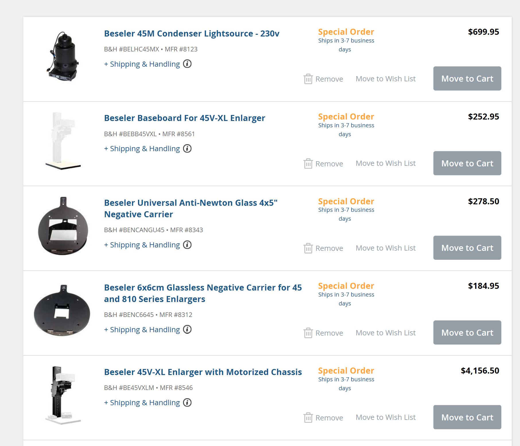

Need some help with this enlarger.
I've decided to stop $%#$#$# around and just buy the enlarger from B&H............The problem is it comes in pieces so I want to make sure I buy all the correct necessary pieces. Below is what I think I need;
There are other items like these but have no idea if I need them or not??
Thanks
Neil

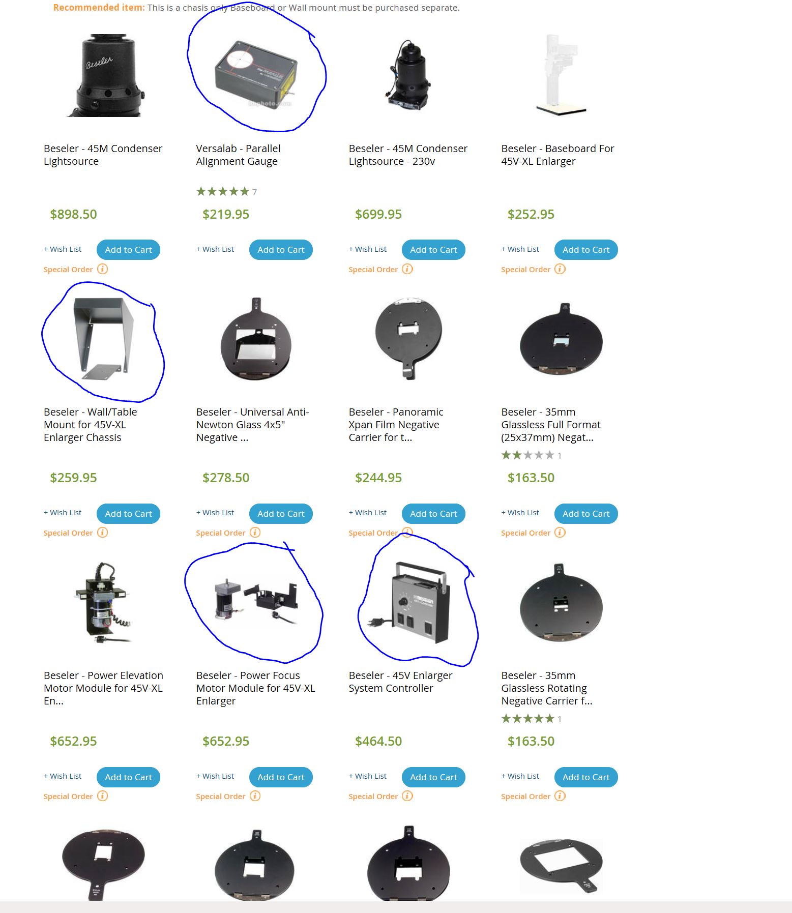

You are going to buy a new enlarger when there are so many used ones looking to be rehomed? You don't need the wall mount if you are using the baseboard.

Dear Neil,
I have a similar setup, you have spent enough on a state of the art enlarger, I would stock up on quality enlarging len glass unless you
already have it, as well as negative carriers. Since I file out some of my carriers, it is necessary to purchase 2 but I look on the used market
whenever possible.
a) Never liked the power focus modules on any enlarger, $700 saved
b) System controller, is probably a voltage stabilizer and surge protected outlets with trim pot... $500 saved
c) You are purchasing a new tight system the parallel alignment guage was a necessity when purchasing used equipment
that was riding in the back of a pickup truck over rough roads, if you intend to get the wall mount down the road
then this would be a valuable accessory.
Look at some of the master printers darkroom portraits, simplicity, devoid of black boxes and too many ace$$ories.
You have a fantastic base, girder, platform, condenser head, new flat baseboard new flat neg carriers, there might be
some (very) minor adjustments probably not many though. These units are spec'd and setup at factory, your results after
careful assembly should mimic factory true settings. Do NOT accept any damaged boxes.
Congrats on you bighting the bullet, its a lot of money these days, however that first 16x20 wow print will emphasize that
it was worth every cent!!
Harlequin.

If you have decided on a Beseler 45V-XL, if I were you I would get in touch with Beseler themselves. I am sure they would be happy to assist you in coordinating a purchase through B&H (or elsewhere).
Beseler: http://www.beselerphoto.com/
Beseler are fairly small now. A telephone call might work better than email.
LPL might be an excellent choice too. Contact the Canadian distributor KHB with help on that (and Beseler too I expect).
KHB: http://www.khbphotografix.com/
Obviously you will need to point out that you require 230V rather than 120.
bdial
Jan 2, 2005
7,514
North East U.S.
The Beseler is a fine machine, no question. But you may want to look at the LPL 7400 series, I like them more than the Beselers.
The LPL is made in Japan, which might be a little easier to source for you.
B&H does sell them however (or did, anyway). There is also KHB Photografix;
http://store.khbphotografix.com/Enlargers/?page=2
As for your original question, I agree with the above that you don't really need the accessories that are circled, with the possible exception of the wall mount if you do intend to mount it on a wall. If the chassis doesn't come supplied with a base board, then you will need it (assuming you are putting it on a counter instead of a wall).
