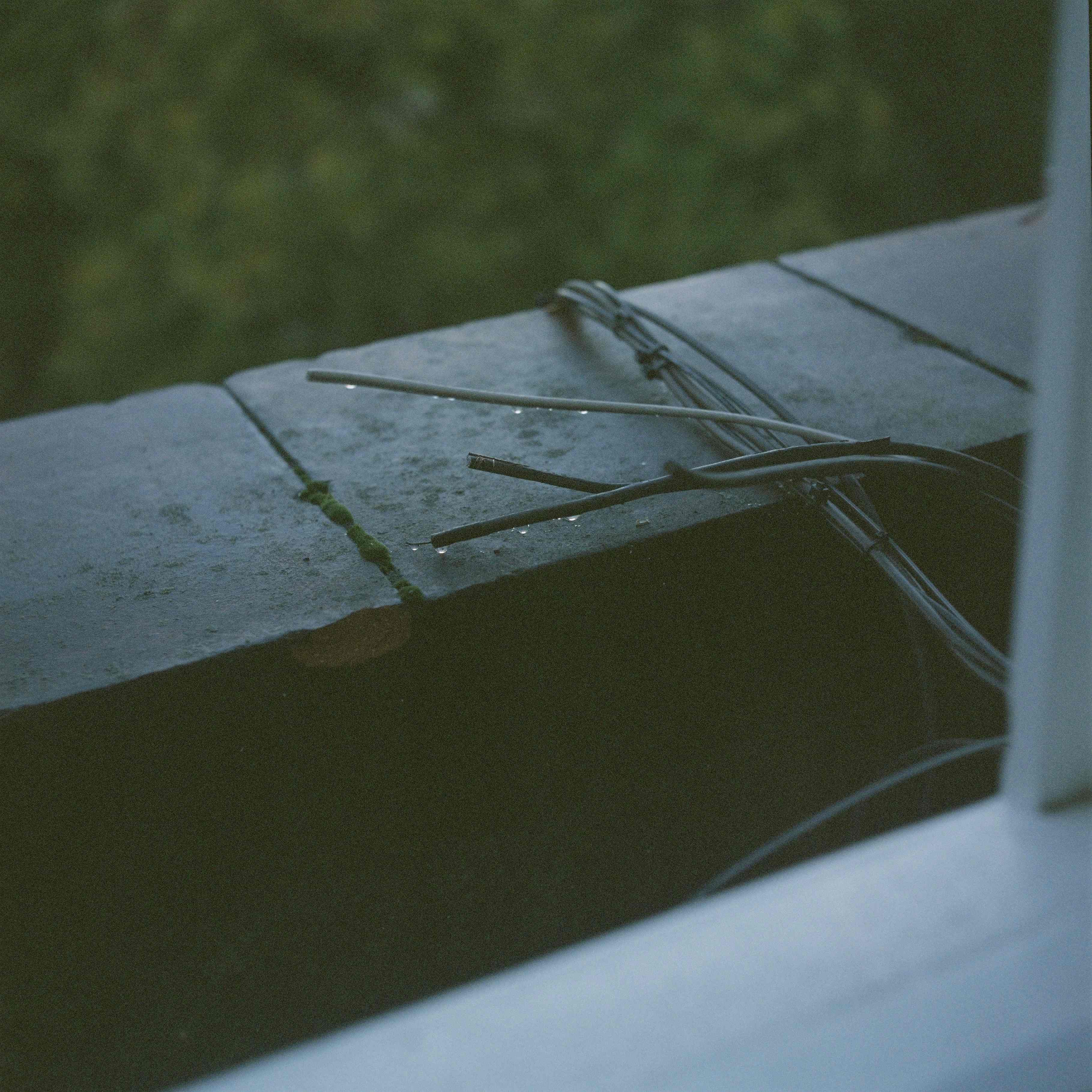

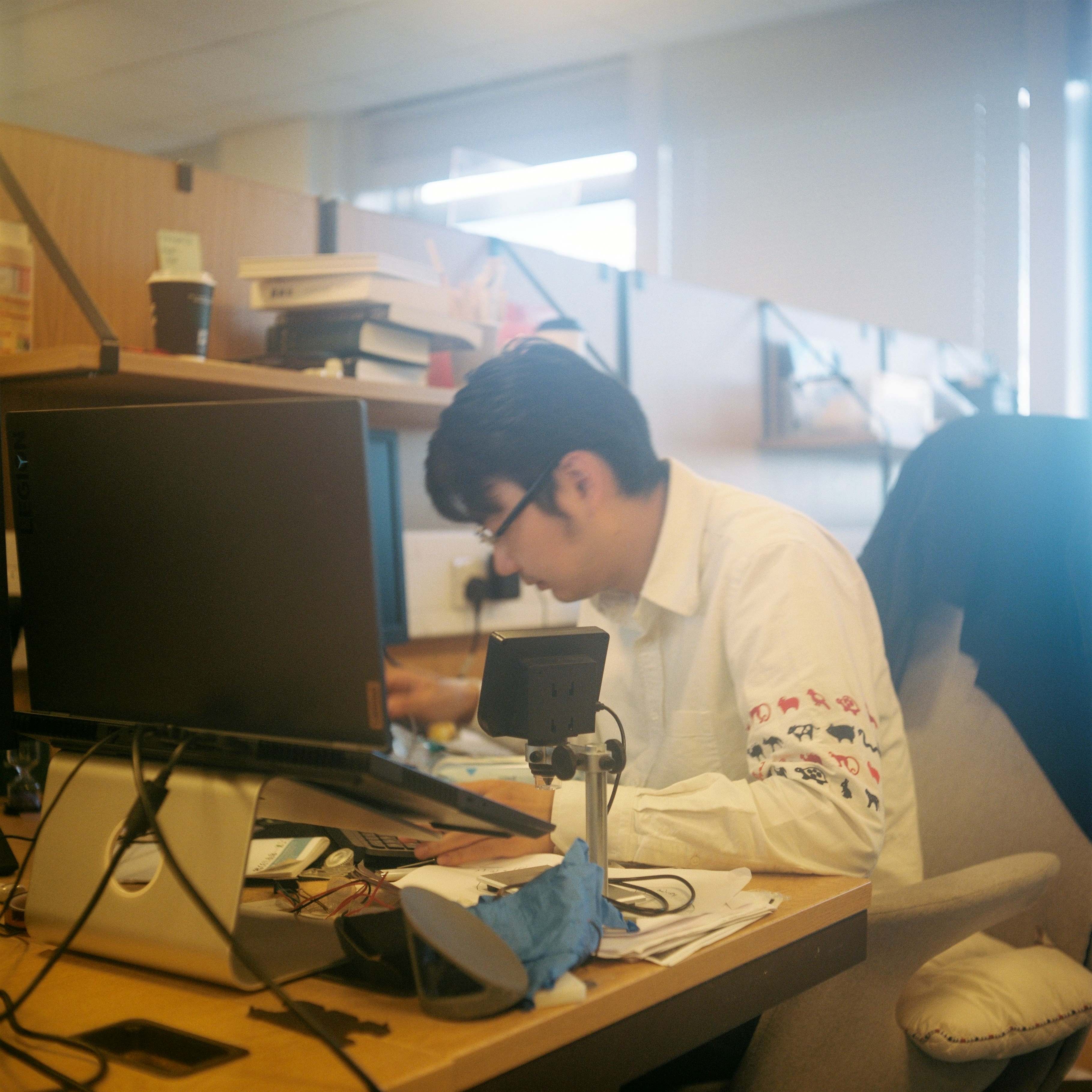

Hi everyone. I have recently acquired a Rolleiflex Automat Model K4B.
After talking a few rolls of pictures with this camera, it has come to my notice that direct SIM light or regions saturated by light spread into the darker regions. For example, in picture on the left below, the person's face is sharp, but partially affected by light from the window. However, pictures that are overall dimmer are unaffected by this phenomenon.

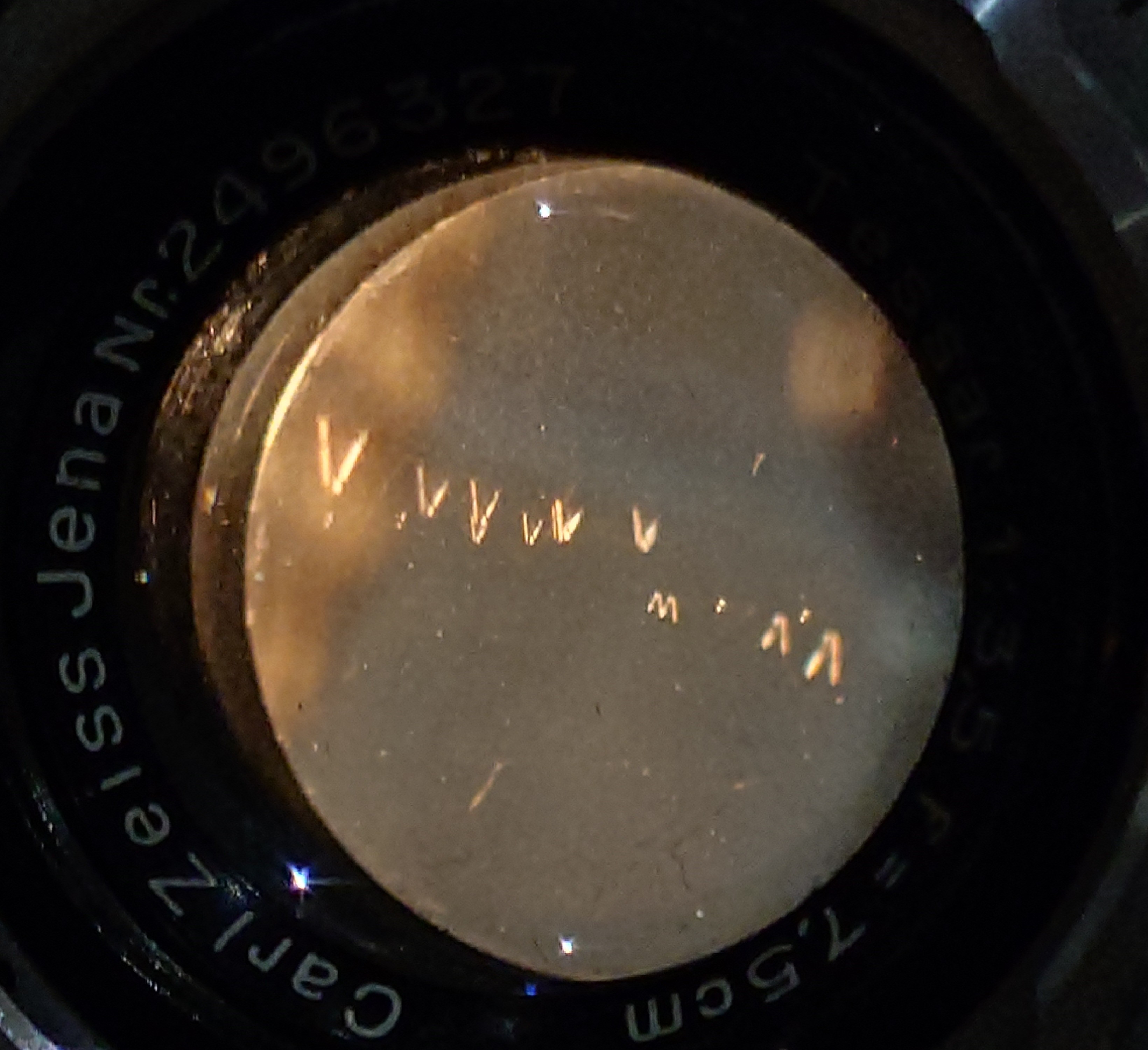

Upon inspection to the phtographic lens, some dusy was found on the lenses. Moreover, some build ups can be observed around the edge of one of the lenses.
Would anyone be able to advise me on what has caused the blurring of light in the brighter pictures? And what might be the cause of the build ups around the lens? And finally, does this camera worth servicing?
Since the mechanics of this camera is fully functional, it would be a shame if it only works in a limited (low light) environment. Hence, if someone can advise on whether it is fixable or serviceable, it would be great.
Thank you very much and wish you all a great day and be able to capture great pictures.

The 7.5cm marking on the lens makes me think that the lens is uncoated. It there a red T among the writing around the taking lens?
Most likely a good cleaning and dehazing of the lens will improve things. If the lens is uncoated, it will always be prone to flare and having shadows show some 'fog' if a light source is in or nearly in the scene coming towards the lens. The image of the man at a desk strikes me as pretty typical for an uncoated Tessar in such lighting. If it is a coated Tessar, them most likely haze is the issue.
View attachment 382981View attachment 382983

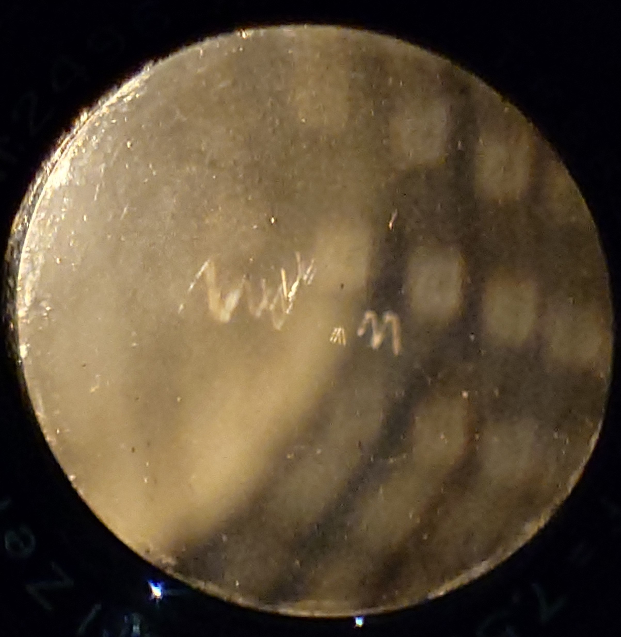

View attachment 382986View attachment 382987

Haze is produced by depositing of dust and chemicals from grease/lubricants inside the lens. It can be cleaned without a trace.

The "T" mentioned by Dan Daniel is actually reflection of the lamp and it is not scratches on the lens itself. I am sorry for not mentioning in my post.

Actually, I was referring to something not seen in your photo of the lens front. Lens coating were developed just before World War II. After the war, when they started selling cameras with coated lenses, manufacturers would add a mark or letter to the information around the lens. For Zeiss, the indicator for a coated lens was a red T. For Schneider, it was a red triangle. Kodak used an L in a circle... etc. Since I cannot see all the writing around the lens in your photo, I was simply asking if there was a T in the dark area. You'll get flaring and fogging with both coated and uncoated lenses, but the uncoated lenses are more prone to it and will show it stronger.
Generally I would consider a K4B to have coated lenses, but the '7.5cm' marking, rather than '75mm.' makes me think your lens might be an old stock uncoated lens. Maybe swapped in later.
It has a 1938 serial number too.
