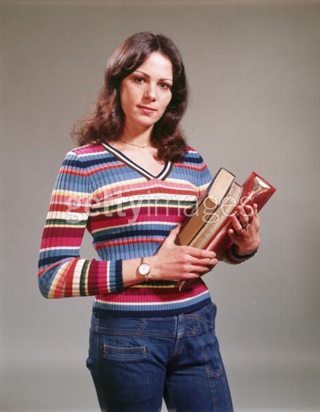

If this was shot in the 70's in London then it is highly likely it was shot with Cecil strobe, a 5000 magna flash pack and either a fish fryer rectangular soft box with 404 grade perspex or a single C head with a round light diffused with perspex, the background was lit with a 5ft strip light on the floor and pointed up , sometimes with a edge of dog toothing to soften the graduationt,he first shot looks like it was lit with something like a 2Kphotoflood with loads of fill and a flagged back light

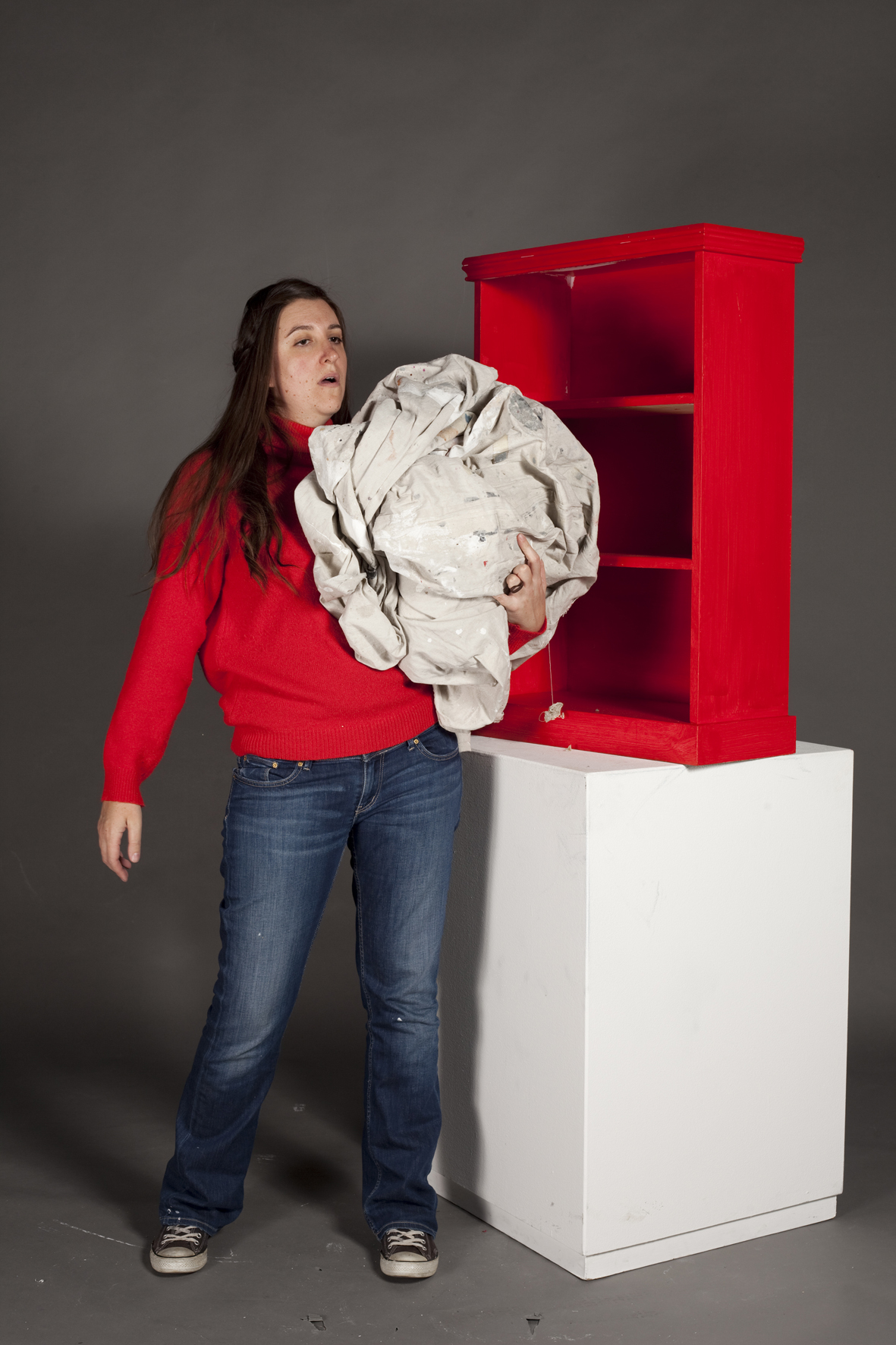

Greybeard, you're right again, I had no idea what spun aluminium meant, only that it would be a metal
reflector of some sort. Thanks for the visual! What I've been doing is square softboxes one to the right of cam,
at about 6ft height and one lower left of cam at slightly less output and angled up. I was using three lights but
the third one broke so I had to adjust my lights to crappy 2-light system. Which complicates things.
But maybe people can look at these two things and tell me what's missing from mine? (mine obviously
is the red top one, and I was only able to use the two lights, so yeah the backdrop isn't lit. )

What is your idea for the shots? The content seems really awkward and random to me without having any background or context. The lighting seems kind of brash too, especially when compared to your reference material, but, again, maybe part of the idea?

The studio that I worked for in the seventies were still using tungsten lighting. A bank of four 500watt bulbs in a continuous white reflector, plus three other spun aluminium reflectors with 500 watt bulbs in each. The bank gave an overall wash, with the others employed as a main light, extra fill and as a back light. The lighting was good, but bloody hot in summer!
The studio soon switched to flash with umbrellas, then to a combination of softboxes with umbrellas. The back light was another flash with a snoot.
Continuous lighting seems to making something of a comeback, with halogen lights giving plenty of light without too much heat. If you were setting up a studio, the continuous lights would give to look you are after, plus they are much easier to control as you can see exactly what you are getting.
Bear in mind that if you are using film, you will need to use one with a muted palette, such as Fuji NPH and Kodak Portra to give that 70's look.

2F, I'm glad you said awkward and random, you might not have meant that as a compliment but
it works for me. These are works based on my failure to recollect from memory properly, I won't spend
ages babbling on conceptually but I am trying to intentionally make the past visually clash with the
present if you like. This is a very nutshell explanation, but the lighting is meant to be as 'old' or 70s as
possible while it still being obviously shot contemporarily. So it's not meant to be a total reproduction of
a 70s shot as such. Hope that makes sense.
What do you mean by brash though?

Not a compliment or an insult. Just an honest reaction, which is the basis/point of any worthwhile critique IMO. I phrased it the way I did for a reason, hoping you would see how a viewer reacts to the work, and possibly explain your idea more.
By brash, I just meant that it is bright and bold; it calls attention to itself as being "lit," while the examples from the '70's you shared are more evenly lit, and have lighting that is less specifically noticeable to most viewers.

a trick i was shown was to "read the eyes" subject with darker eyes are better for these obvious reasons. looks like two, possibly three light-points. i think its a classic 3-pnt set up with combo of reflectors possibly a few "kickers" on her back to give proportional highlights. imho all continuous lighting (and possibly a diffused overhead flash for general fill)
if the image a mag repro the color info would be off kinda like how given her a more sunbaked appearance. heres a magnification I made of her left eye, i think there may be three distinct light points two areas A & B are pronounced which gives you a clue that it may not be using a diffusion screen on those particular lights at least.
hope this helps...

Regarding the last two images you posted: in the second image, if you look at the area under the subject's right arm, there are two distinct shadows, sharp-edged and of different densities. In the first image, this effect would have shown up where the shadow of her leg falls on the bookcase, but there you have a simple umbra/penumbra with a fairly broad edge. I suspect that this comes from your use of a softbox, where the brightness is pretty even across its width. A lamp in an aluminum reflector acts like a bright, hard light in the center, surrounded by a softer light with a very broad pattern (usually 60-90 degrees, sometimes more). The broad light gives the overall fill that keeps the shadows from going very dark, and the bright lamp in the center creates the multiple shadow lines.
Back then, it was widely understood (correctly or otherwise) that color film did not have the exposure latitude of B/W, so lighting ratios were kept very low by modern standards. Also, may of the "signature" photos were intended for reproduction, where it is easy to compensate for low contrast, but impossible to restore dead shadows or burned-out highlights. It was definitely true that film speeds were typically lower than we are used to today (High Speed Ektachrome, tungsten balanced was all of 125 ASA), so there was a strong tendency to keep the lights in fairly close and this also meant that there wasn't likely to be a large lighting ratio.
If you are good with a light meter and not too concerned with color fidelity, you can combine flash and continuous light---it would be best to light the background with a flood if you only have two working flashes, to preserve the multiple shadow edges that make up so much of "that 70s look".
If your softboxes have removable front diffusers, you might try lighting the picture with bare bulbs surrounded by the softbox shells. I tried this once, and was surprised at how much the lighting resembled the old Smith-Victor reflectors.
Finally, if your intent is to place something modern into a characteristically 70s picture, you will have to either exaggerate the image characteristics or reduce the initial impact of the modern elements (or both). The young ladies in the vintage examples have hair, clothing, and posture that is faithful to the era; make these modern, and I suspect that most viewers will have a hard time reading the picture as anything but a recent creation. If you can locate the book The Psychology of Everyday Things, by Donald Norman, you will find a very readable discussion of why human perception works this way.

Holly, what your picture is missing but the vintage one has is the rim light. It's not as obvious because the picture is not as shadowy, but you see highlights in the hair, shoulder and cheek, all on model's right side. I'd use a small head fitted with a 30 or 40-degree grid for this, but aluminium reflector with barn door would also work. If the light is too specular, you can always use light tough frost gel. Color fade, color crossover, outfit, hair styling, makeup, etc. have already been mentioned.

I'd say that the first image is a 3-light setup.
One hard light, camera left, fill on camera axis, one hair light, which is responsible for the shadows below her hands.
Looks like they are all balanced pretty equally.
Could be some reflectors going on as well on camera right, hard to tell.

In the 1970s the typical studio lighting was flash with umbrellas and —the latest craze at that moment : Peter Gowland's version of the umbrella, the "Reflectasol" system (I know first hand: I sold tons of them at Denevi's, the pro camera shop at which I worked).
However, to re-create the look in the sample photo you've attached, try using *bare photofloods —or *bare flash-heads— in their reflectors (*"bare" = no softbox or umbrellas).
