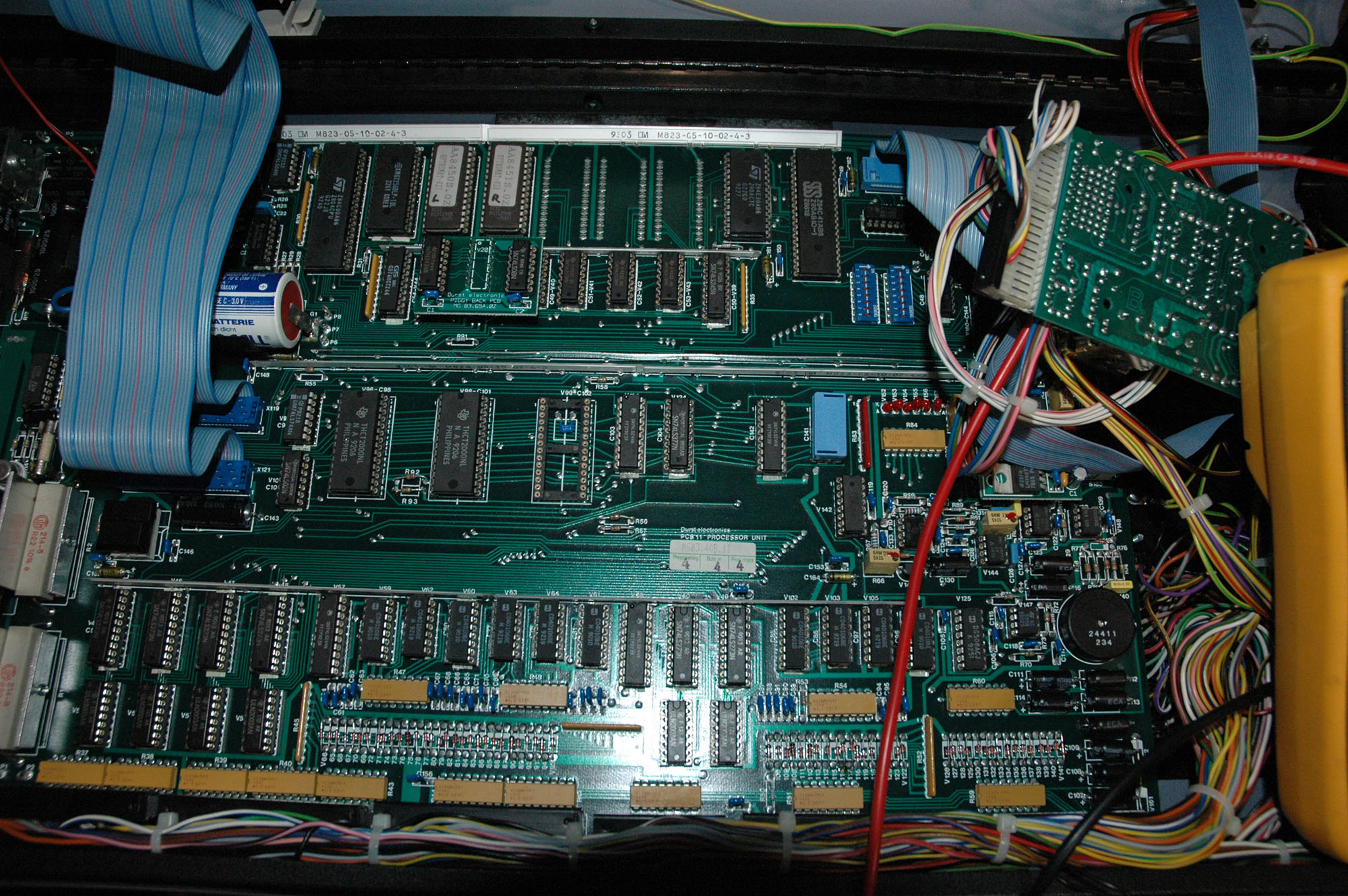

I remembered my face when I saw this first time and it just stopped working.
Sorry for off-topic. Hope you smile like me now.
(on photo enlarger)
