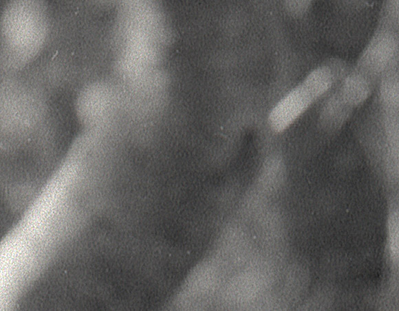

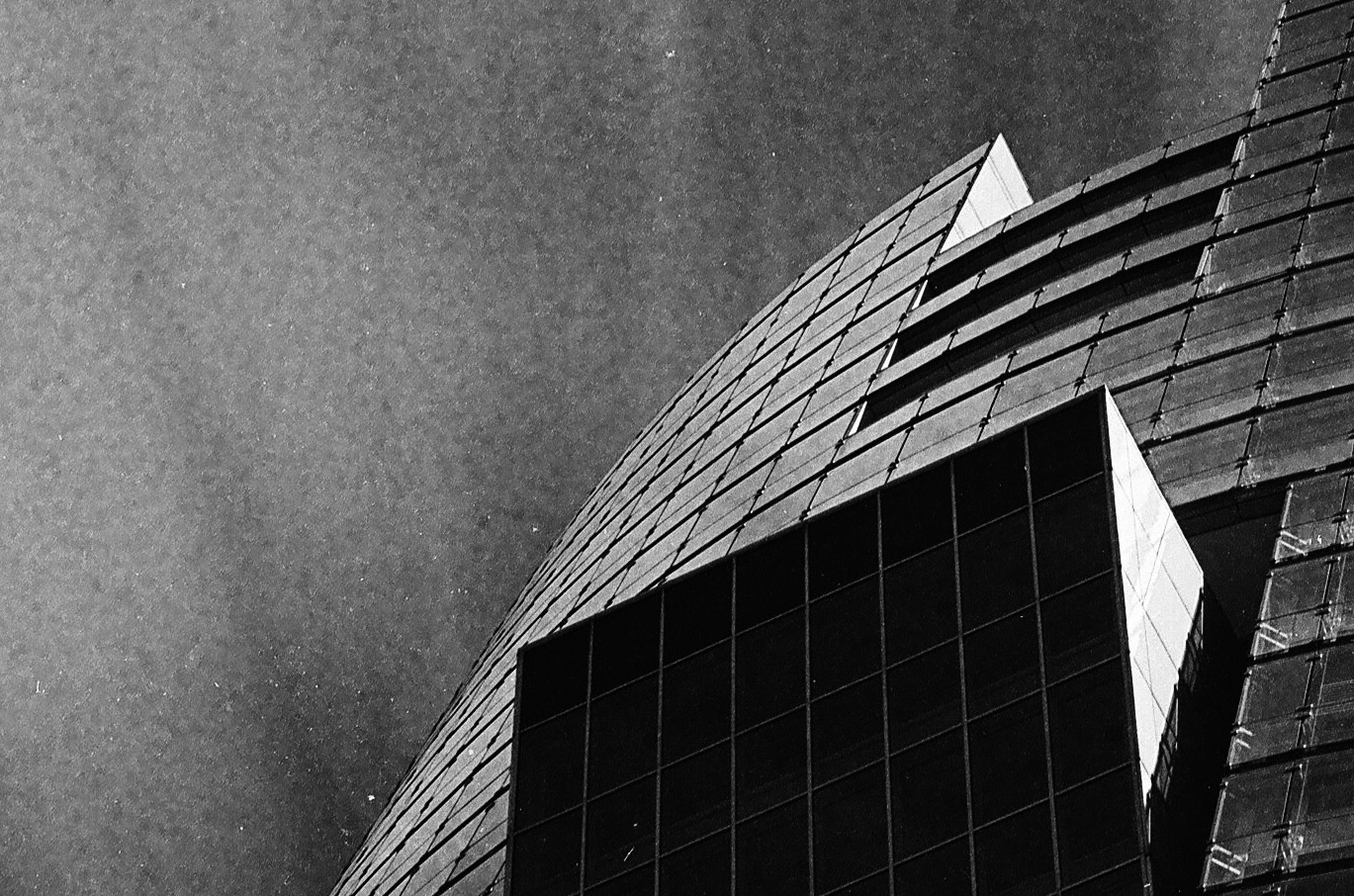

I have a problem with Ilford Pan F Plus and Perceptol 1+1. I developed Ilford Pan F Plus with Perceptol 1+1 (perceptol + destiled water, water from osmoze) 10min 30s and 20 degree of celsius, aborted with destiled water from osmoze (2x this water), fixed with Fomafix 3min, washed with drinking water 10min, at the end wraped to Fotonal with destiled water from osmoze 2min.
I got this result after scanning. This structure is also on negative. Picture is 100% crop from scan and original. Is it normal? I am a very disappointed wiht this result. This is a long expsure with Hitech 3,0 ND Pro Stop. Exposure time was 2min 30s.
Could you help me with this, please? Thank you for any advice.

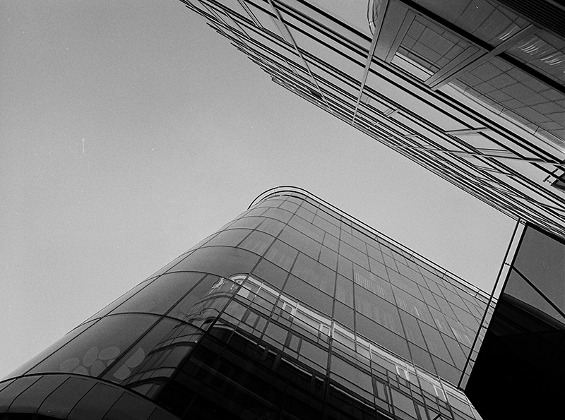

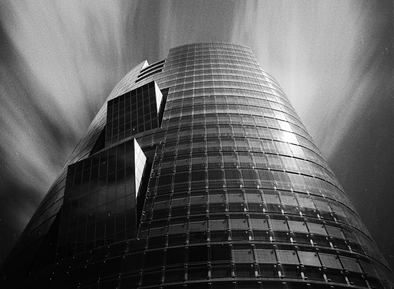

Another picture from same roll of film.
this a original picture resized to 800x600, same as in previous post original picture resized to 800x600
this is no long exposure, exposure time was 1/4 s.

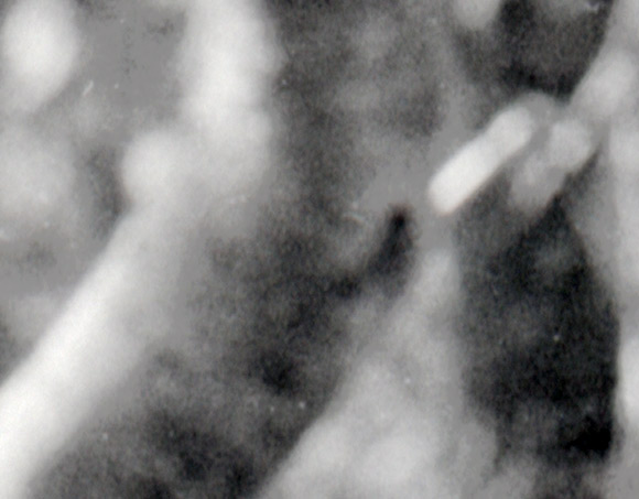

That bizarre pattern looks like a sharpening artefact to me in scanning, Try advanced mode and make sure sharp/unsharp etc is off/disabled/etc. Get out a loupe or whatever you can to magnify it and check out that sky area optically.
First image is an original, following 3 are different looks of sharpening artefacts of different levels of sharpening applied.
This pictures was scanned with Noritsu S-4 in fotolab (max scan from medium format 6x4,5).

I've had that clumping effect on Pan-F before; I think it's due to temperature shocks during processing but I don't know. It's definitely (in my case) in the negative and not a digital artifact. I think I was using D76 or LC29 at that point and haven't had the problem with Rodinal 1+50, however my improved results might be due to better temp control.
Temperature was stable 20 degrees of celsius. I measured the temperature of developer, stopper, fixer and drinking water. Large thermal schock is not possible. Only one shock is possible - pH schock. Developer pH is in range 7,0 - 8,0 (Perceptol 1 + 1 destilled water), stopper 6,0 - 7,0 (destilled water) and fixer 5,5 (Fomafix).
Is your wash also at 20C? I think my problems were due to differing wash temps but don't know for sure. I would suggest trying Rodinal or HC-110 as I've had very good uniform results with those (EI25, Rodinal 1+50 for 9:00, agitation first 30s plus 10s/minute).
Which is not to say it's definitely temp-related. My post is mainly just to confirm that it's a real thing that you're not imagining and it's not due to your scans.
Or problem is not with film or developing process, but problem is with optics. I used Hitech 3,0 ND Pro Stop Filter. This filter creates blue color cast on digital cameras. See this link Dead Link Removed
Maybe this color cast is problem for film.
I will buy Hitech standard ND filter (density 2,1 - 7 stop or 2,4 - 8 stop, no PRO STOP 10 stop) and I will test this combination. This filter blocks visible light, but infra light goes through this filter. This filter creates red or pink color cast on digital cameras, because digital sensor is very sensitive to IR light. Infra light is not problem for Ilford Pan F Plus, because spectral sensitivity of this film is only to 650nm. Is it a good idea?
Do some with/without testing of your filter on a single roll before buying another filter. I really doubt that the filter would be causing the problem but if you can show (in a single roll!) that the filtered frames have the issue and the unfiltered do not, then buying a different filter might be a good approach.
