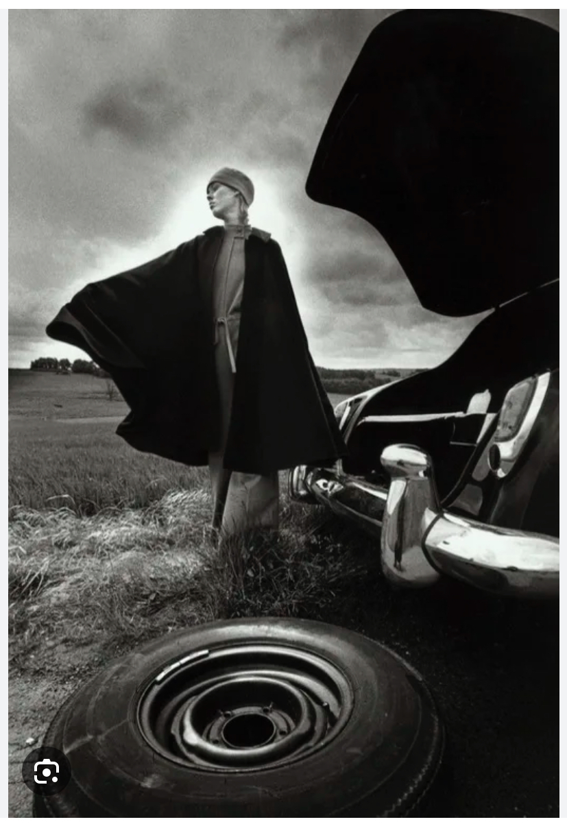

Sieff was known for very rich blacks and “auras”.
The auras are not extremely difficult to do, the blacks are.
Case in point…this photo.
What I am more or less certain about:
- he used either Leica or Hasselblad, mostly Hasselblad on assignments (maybe important or not, just stating it)
- he used only tri-x (which I think is not the tri-x of today)
- he used only d-76
- he was capable of spending a whole day at the enlarger on a single image, and I think he even said himself that his images were 90% darkroom
What I suppose:
- baryta paper. Is it enough for those blacks? I only saw such blacks in my photos with b/w reversed film.
- normal dev times and painstaking darkening of black areas under the enlarger. Faces and other details are not high contrast
- OR…high contrast dev and then take advantage of the high forgiveness of tri-x to bring back some things to normal contrast
Feel free to contradict me. I have so much to learn from people with so much more experience than me. Thanks.

I don't see anything special there. That is obviously a scan of a print. Who knows what the print looks like. Have you seen the print?
Yes have books from Sieff. It looks like that.

Agreed on the "aura"...horrible dodging, but it was the '70's, and maybe it was his 'schtick'.
Mid 1970's he used a Leica M3 with a 21mm lens, and also a Nikon F2 with15mm and 20mm lenses...and Tri-X.
(Info sourced from an October 1978 issue of Camera35 Photo World magazine.)

Mostly what I see is a really horrible burn and dodge job.
That was the first thing that came to my mind as well -- burning down the sky to bring out cloud texture without taking the care to make it less obvious. Then again, with the exposure conditions that are likely present on that negative, it would be almost impossible to burn the sky enough (at least in a wet darkroom) to matter without creating some "halo".

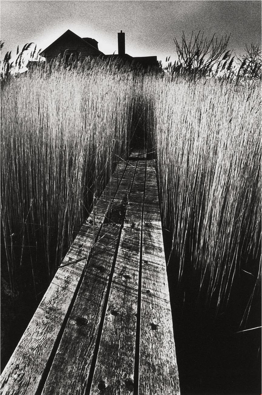

@pierods : if you understand French, you'll get your answer in this video by photographer Michel Viard, who knew Sieff well and worked with him. At the 20:26 mark, he talks about Sieff's darkroom technique with skies, which was to burn the sky but leave an edge on the lower part. He also talks about Sieff's fondness for Potassium ferricyanide and that he used it with a brush, notably to lighten skin tones.
Gives this as an example of Sieff's burning of the sky. Good chance ferri was used to lighten the wooden path and the bush.

One last question (I am not good at zone system etc).
If you look at the original image, the tire is in a way lower zone than the face of the woman.
So I imagine he must have proceded like that:
- meter for detail on the tire (the darkest part where you want to have detail etc)
- make sure that the face of the woman is within the acceptable range for his lens/film/dev combo, and within that range, determine whether he had to shorten development to compress highlights (the image looks like it was taken in overcast conditions so not necessary)
- take the photo
- develop according to above
- do bleaching
Correct?

If you're going to reverse-engineer Sieff, leave the zone system out of the equation. If you know how to meter, you don't need it to get the details you want where you want them. If this was really an overcast, low-contrast day, metering would have been pretty simple.
I remember seeing somewhere that he used Tri-X in D-76 (1:3), but I can't find the reference, so take it with a grain of potassium ferricyanide.

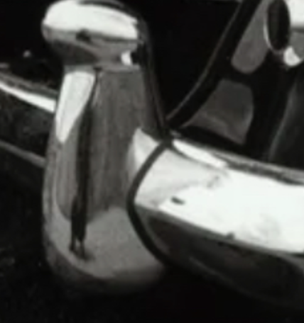

Now if you want to go all the way with the reverse-engineering stuff, make sure you get the reflection of either the photographer or someone else on the car's fender 🧐.
Possibly, but given the fairly hard edge across the path around the bottom of the reeds, I think part of what you're seeing is also just a difference in print exposure.
Ferricyanide in this particular case would have had the disadvantage of bleeding out in the black area next to the boards, lightening the dmax and turning its color somewhat. In practice that tends to look rather yuck.
If I would want to create a print like that, I'd dial in grade 5 regardless of the negative, determine a base exposure for the darkest part I want any differentiation in and then start burning all the rest with a simple piece of card. It's pretty straightforward.
