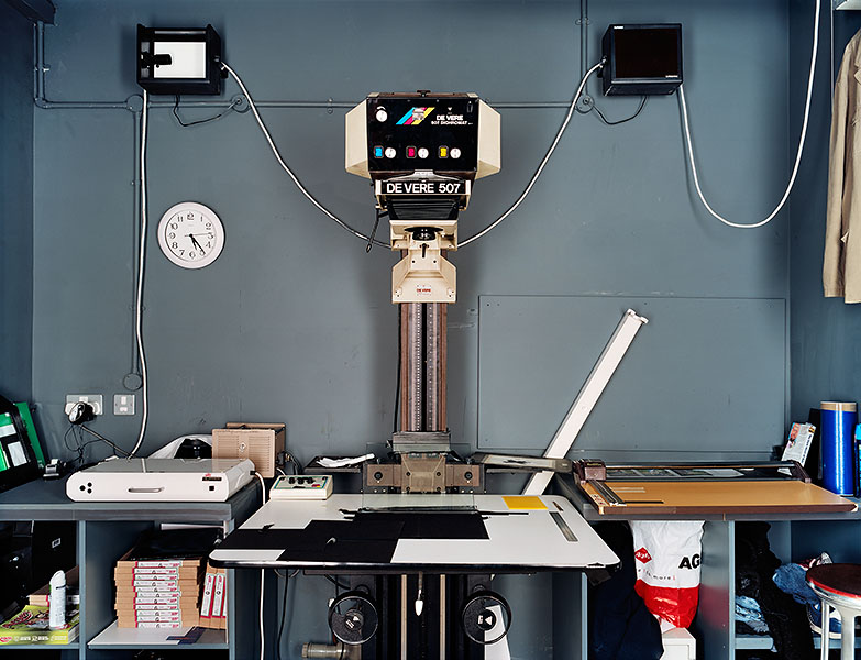

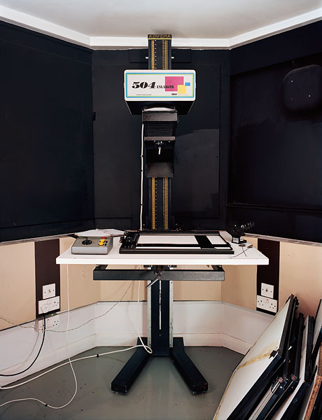

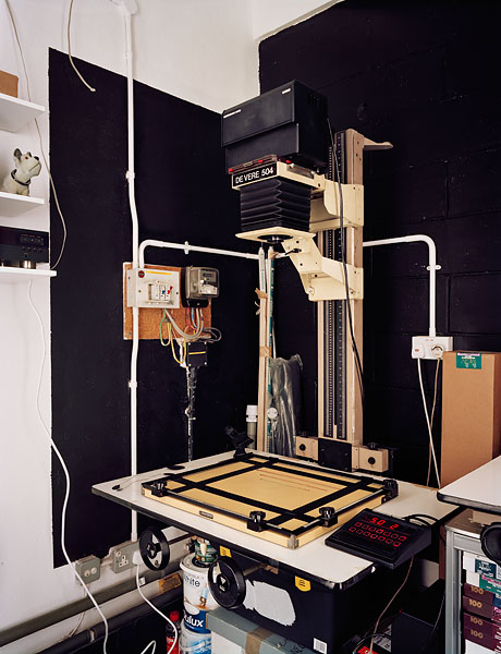

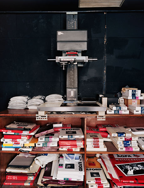

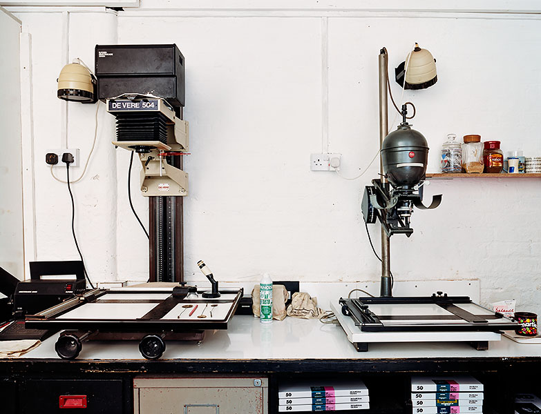

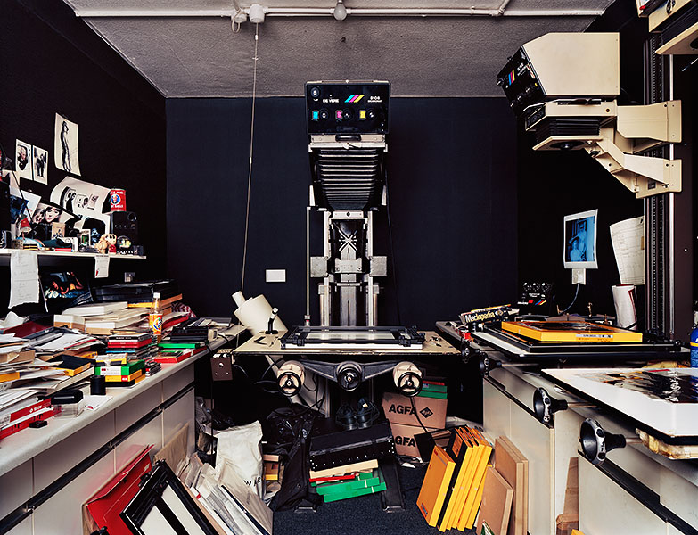

Don’t guess you mind dust either. Every professional printer worth his salt uses a dichroic head. Look at the photos of professional darkrooms nearly all have DeVere 504’s with dichroic heads. Wonder why?
Sirius Glass
Jan 18, 2007
50,814
Southern California
Using the same enlarger for black & white and color is yet another reason.
The pros I know use both. I have no problem with dust, I take some time to clean my negs. I don't shoot color film and I process my B&W in Rodinal and use a condenser head. I value sharpness and have no problem with grain. The great majority of my work is MF and I don't have to do much spotting on my prints. Also, most pros use glass carriers that have even more surfaces for dust to collect on.

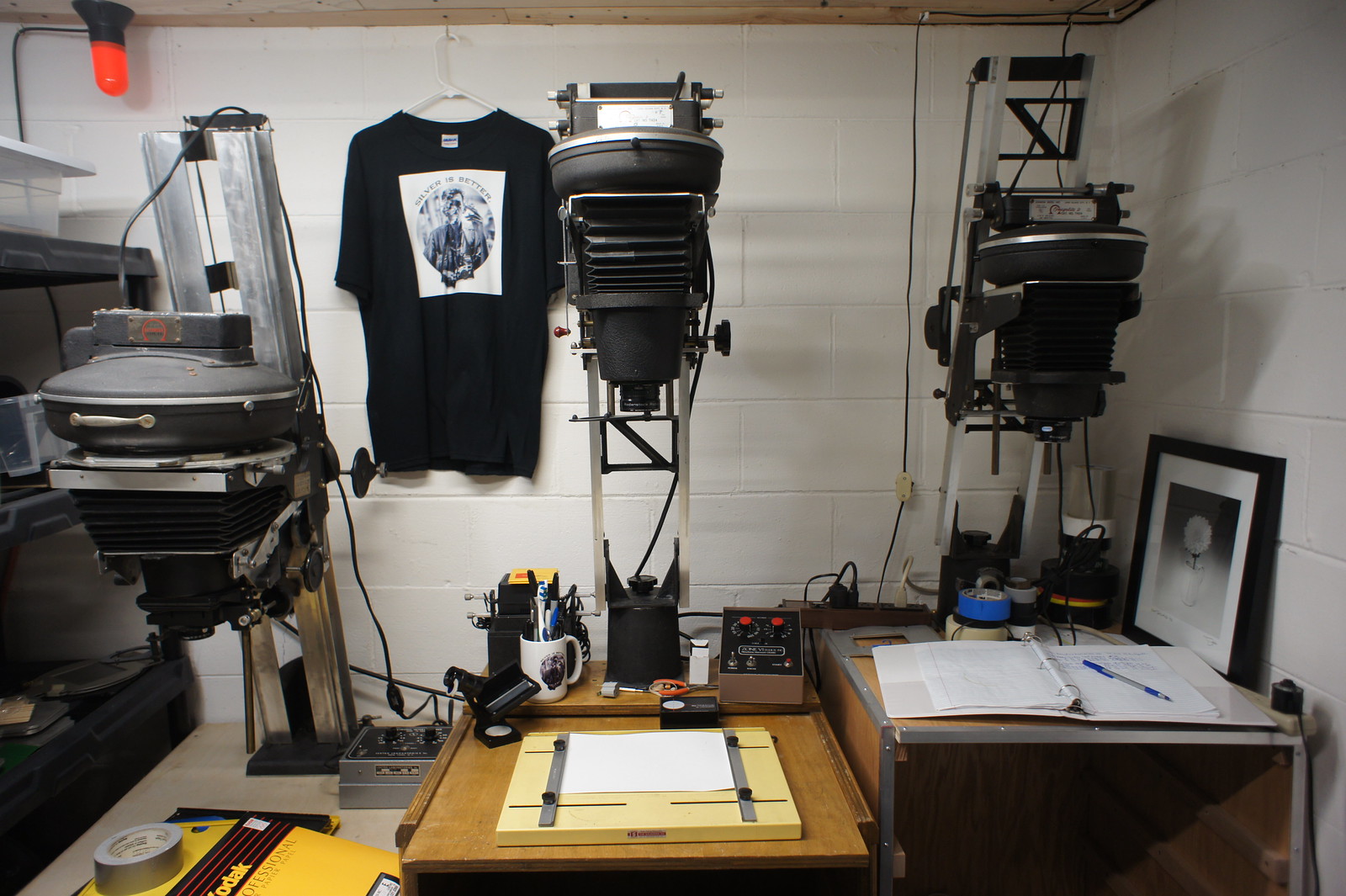

Nokton48
Oct 8, 2006
3,097
Darkroom Reno II No 2 by Nokton48, on Flickr
I have two DII's one for 4x5 one set up for 35mm. Use everything in between, too. Like the Omegalite Diffusion Head as you can see. I use Laser-Align every time always sharp prints, black Rodagon lenses and many others too. I built the two drop tables I need only go up to 16x20, all B&W.
The 5x7 E3 came along and I have yet to get going with it. Still needs a bit of work but it's all there. Have a lot of original carriers, too. I had a carpenter come in and build the E3 table, similar to the original I have seen in photos. Even have a homemade LED head and a 4x5 Condenser E-3 head.
I have LED heads and Chromega heads, right now I am favoring the Omegalites.
