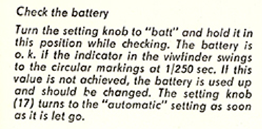

Hello, I've recently found an old Praktica B100 electronic and I really wanted to try it out. Bought some batteries to check it before loading film. There the troubles begin!
The manual says that upon turning the knob to the 'batt' area - the dial should point to 1/250. Mine points towards 1/1000.

It does not.
It says 1/250 is the lower limit.
the screenshot below is from the manual. what I understood was that the dial has to show 1/250, but if you're saying that it's okay then I think I'll trust you

I see.
The german manual calls 1/250 the lower limit for the battery indication. And such is typical with most or many SLRs, there is a lower limit stated.
The manual says that the meter needle should swing to 1/250 and that this value should be achieved. The implication is not that only 1/250 is good but any figure BELOW 1/250 is bad.

Do ensure that the lens and body contacts are clean. That can cause issues with shutter speed selection. Note what @Peltigera says about smart phones. The apps can be used as a way to assist you in choosing the correct shutter speed and aperture but are no match for a SLR meter. Depending on all the variable factors the phone app could easily be two stops out either way. I do use one but more to confirm my own guestimates with totally manual cameras rather than to assist with a camera that has a meter.
I think the thing with the battery check is a translation issue. What the manual is saying is that 1/250 must be achieved, probably a direct translation from the original German. As others have said it's saying that 1/250 is the minimum for good performance of the metering system. 1/1000 for a new battery is normal.
