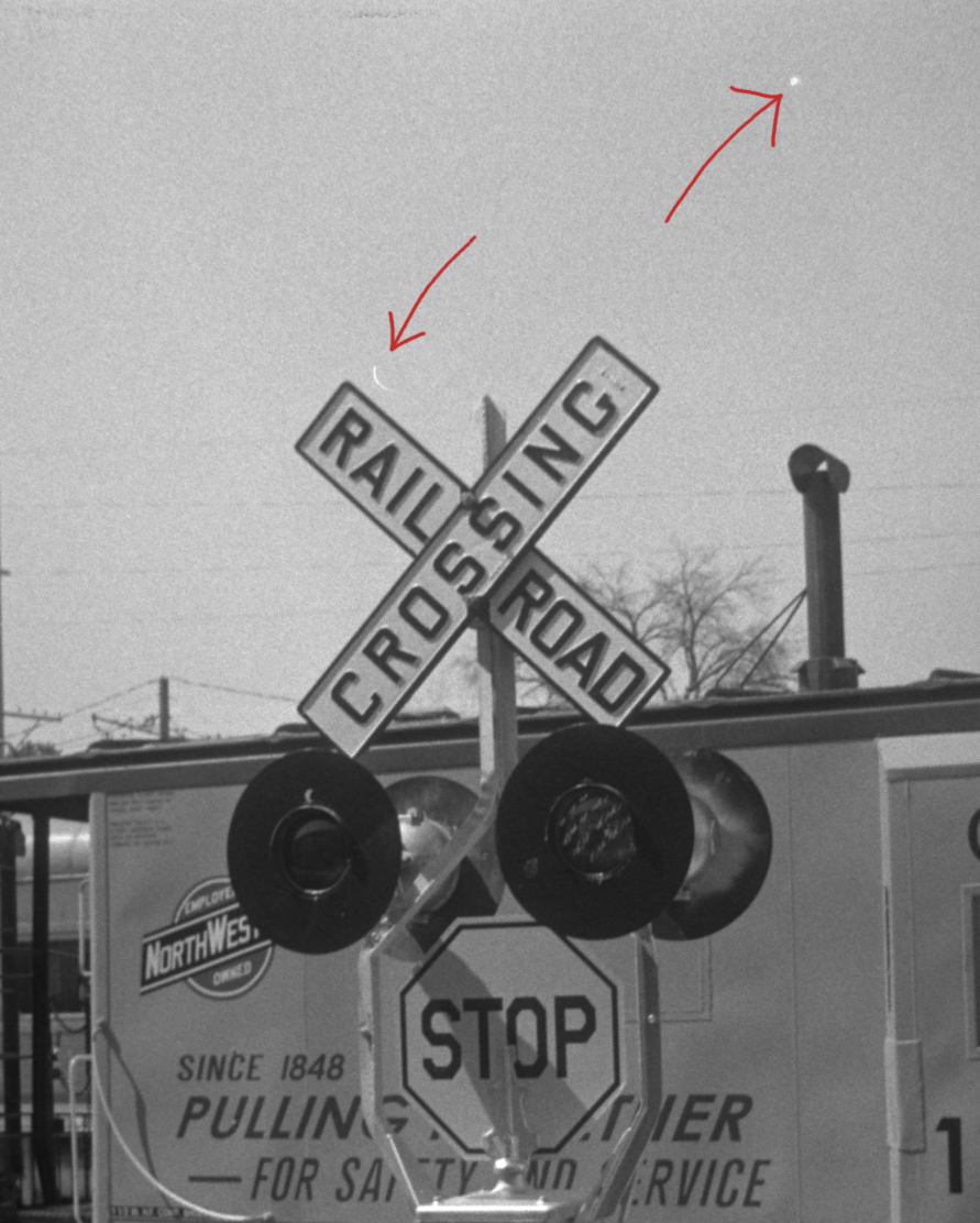

Ha ha. Now that you guys trained me to think about these things, I've just noticed dust spots in one of the prints I posted at the start of this thread. 🙂
D, the crescent shaped irregularity would not be dust, but likely damage on the negative.

With my 7x loupe I cannot get close enough to the negative to see either the dust speck or the crescent. I need to get a stronger loupe.

Can it be lint or hair?
I'd have to see it to know....if you're not carefully loading/unloading film, you can put little kinks in it & they show up like that. If it's lint or hair ...I always brush my negatives with an anti-static photo brush before printing....
It's too small for a kinking crescent; those are bigger and tend to fade & fan out on both ends. This looks like a short hair; maybe part of an eyelash, bit of beard etc.
K, are you profiling because dcy's image of him w a beard? 😉
If both are dust, they may be gone now. Whether scanning/digitizing or printing, any debris on the negative may either be stuck there, or just resting there temporarily.
