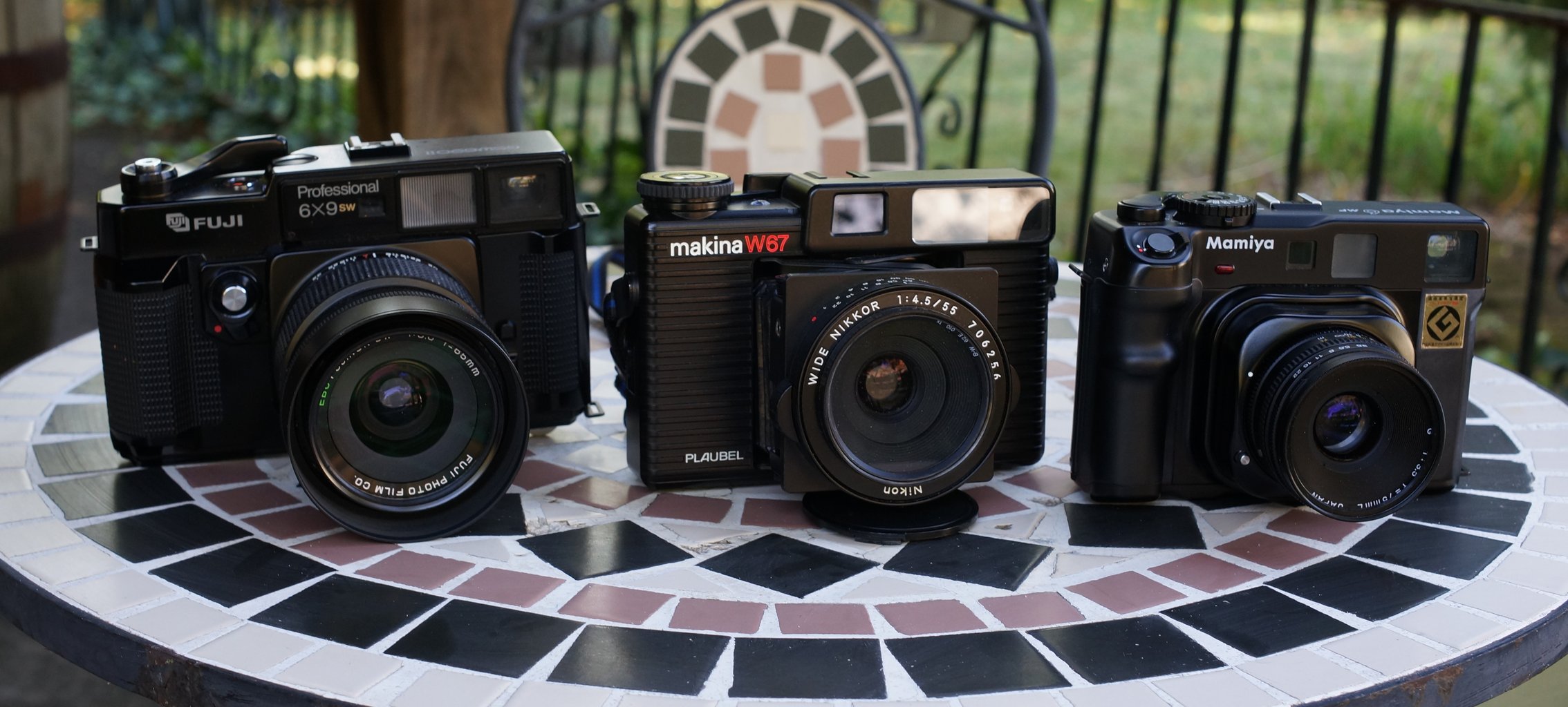

I have the Plaubel Makina 67 and the W670, as well as the FujiFilm GWS690ii. I don't have the GW690 and at one time was looking at the G690 with lenses, but never went there.
I also owned the Mamiya-7 with 3 lenses (which I regrettably sold).
Of these, I probably put the most film through the Mamiya.
I like the Plaubels more than the FujiFilm, they are more compact, have a nicer feel, and don't have that annoying "ping".
Lens wise, the Mamiya's were probably the best. In practice I'm the limiting factor in image quality.

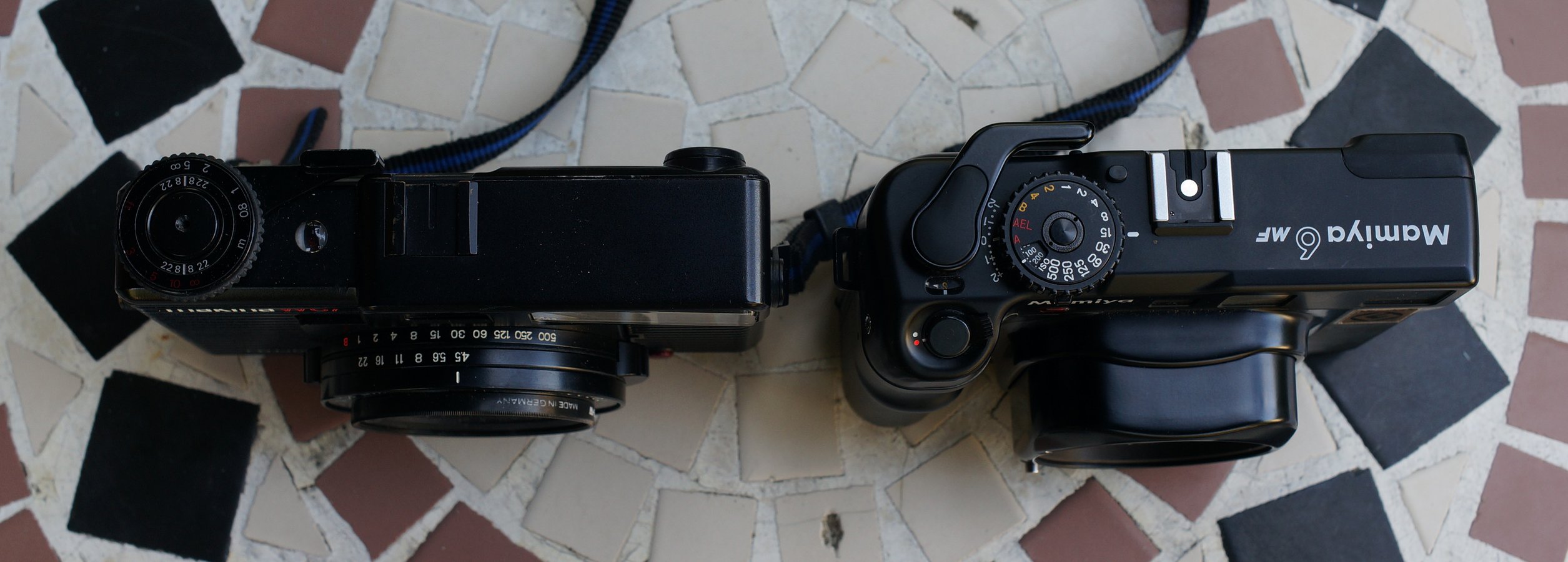

I don't have the Mamiya-7 anymore, and don't have an archived comparison photo (I thought I did), but here they are with a Mamiya-6, the "7" is about 1cm wider, and does not collapse. The FujiFilm GW690 series is definitely big.
