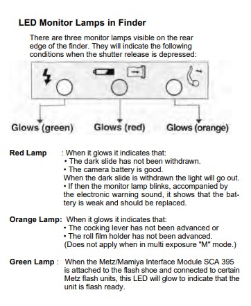

Your body is cocked, but the mirror is not releasing. Hence the little resistance when winding, as it's only trying to cock the shutter.
Since the red LED is on both with the back attached and detached, I think there is something wrong with your body. These interlocks depend on the signal through the electrical contacts on the back of the body. Without the back, the orange LED should light indicating the film is not ready. Putting it into multiple exposure mode should let you trigger. Same with the back on. The Red LED lights when the dark slide is in, only when the back is attached. But the body should release once you put it into Multiple Exposure mode.

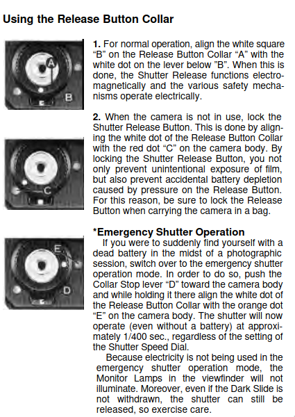

Dose the body release when you set it to full mechanical mode?
Turning the collar to the Orange dot (emergency release mode) will bypass all the electrical interlocks and let you release the body. You can use the camera this way with RB lenses with no battery.

Now the led is show only orange color. I turn camera to multiple exposure mode but led show only orange light is good? or I should put film in to camera to test it.

I should have noticed on your original video that there was a "click: when you pressed the release in mechanical mode. When the interlocks are active in normal mode, there is no sound when the shutter button is pressed.
Since the mirror does not go up, and the lens cocking mechanism does not rotate back (in mechanical mode), something appears stuck inside the body. You can try giving the mirror a gentle nudge when you press the button to see if it's stuck down because of old grease, but don't force anything. I'm guessing it may need a CLA.
