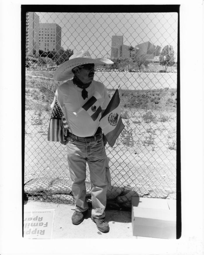

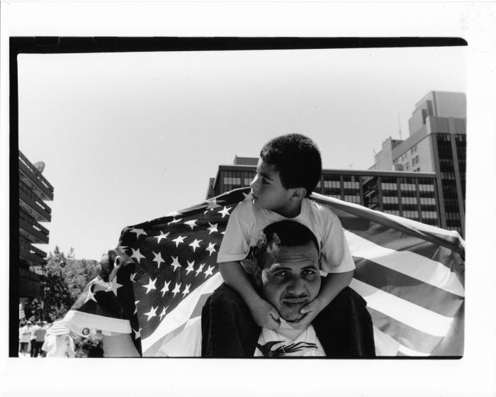

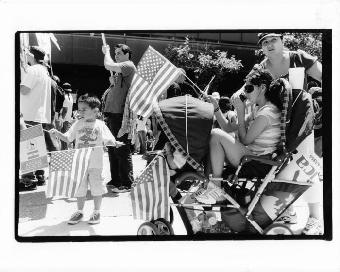

Hi Everyone,
Today I spent a great day printing some recent work in the college darkroom I use. However, I seem to be getting some odd results that I'm trying to pin point. Please look at the examples below. I've been developing my own film for over five years now but is seems lately I've been getting density build up along the edges of both my 135 and 120 films. At first glance it would seem this issue is simply over-agitation. However, if this was the case, wouldn't the entire roll have the same effect? In the first picture one can see how the center part of sky is gray compared to the edges of the print. The second picture is a couple frames from that picture so it's the same roll but does not have this effect. These are straight prints by the way. The third image is a different roll but same location and it's even more obvious. The last image is a different roll taken on a different (overcast) day but it too has a very obvious build up along the bottom.
Here's the technical part: These are Legacy Pro 100 films (re-branded Fuji Acros 100?) that I rate at 50. These were all souped in Rodinal 1+100 for 14 minutes. I put the reel with the film on the bottom and an empty reel on top in a 16oz tank. On the top reel I wedge a piece of a plastic pen cap into the center to keep the reels from moving during agitation. I pour in the developer almost to the top and agitate 4 very gentle inversions for the first 30 seconds. Then a minute after and every minute thereafter, I do two very gentle and slow inversions until I pour out the developer. This method seems to work wonderfully for Ilford films at least in 120 size.
Now the instructor in todays lab said it was an over-agitation issue but he also couldn't figure out why this only affects some images and not others on the same roll. He suggested I start with two changes for future rolls. One is to pre-soak the roll. The other is to shoot some Fuji Acros 100 and develop the same way to compare. His thought is that re-branded films may not be identical to the films that we may think they are. He said that Legacy Pro may be made on different coating machines, it may be shipped somewhere else to be cut etc. and anywhere along they way, QC may suffer. So it could be an issue with the film itself hence his suggestion to shoot some Fuji Acros branded film which I'll do this week.
I have about 25 more exposed rolls that I'll wait on developing until I can figure out what's happening. In the meantime I appreciate any feedback any of you can give.
PS -
I also mentioned I'm getting the same issue with 120 film. I've recently started shooting Adox/Efke film again. I guess the lesson here when it comes to agitation there is no "one size fits all".

Firstly, it's not going to be over-agitation. Too much agitation just builds up contrast and grain to the point where the negative starts blocking up. But you won't find parts of the film showing underdevelopment.
Second, I think it's much more likely to be underdevelopment. Two probably causes judging from what you wrote. You are overfilling the tank and there isn't sufficient surge and movement in the developer fluid - especially with the development method you're using. So exhausted developer is still hanging around the edges of the film and not being fully replaced with fresh developer. You only need to fill to just cover the reel containing the film. Everything above that has no value and if your dilution is high (which it is) then you're further starving the film of active developer ingredients.
Third, and coupled to the above, film manufacturers are not in the business of giving advice that produces uneven or second rate results from their films. Hence if they say to agitate for the first 30 seconds and then twice again every 30 secs or four times every minute, involving full inversion and twist methods, then they have a reason for saying that. If dilutions of 1:100 and stand development gave the best results they'd certainly recommend that way - but they don't!
So go back to standard recommended dilutions (say, Rodinal 1+50) and standard development times and agitation methods - don't overfill the tank - and see what you get from that.

Agreed, that looks like under-agitation, not over. With the reels locked into place and the tank full, there isn't any significant flow of developer across the face of the film. The only real flow happens right along the edges, so the edges get more developed.
I'd say that the differences between film on different parts of the reel is from simple wave patterns. You aren't agitating enough to create random turbulence, only a wave or two in the tank. Do you rotate the tank between inversions so that the wave of agitation isn't always traveling across the film in the same place?
When I had similar looking negatives in 120, I stopped filling the tank all the way, and I went to a harder tank motion- rapid flip and jolt with a bit of a twist. This gets fresh developer across the whole of the film, and the problem went away.

You have a classic case of insufficient agitation. What is happening is the developer gets replenished along the edges, but not in the center. So you get high density edges, under developed centers.
Do not control contrast with "gentle agitation schemes" or this is typically the result. Control contrast with time, not by reducing agitation until you are an expert.
You need the empty space at the top of the tank so the liquid has a place to move, so only use enough to cover the film, no more. Assess in daylight without the cover using water and an empty reel.
Fix is just as sensitive as developer. If you get uncleared areas in the center between frames, there is insufficient agitation. Refix will cure this.
Agitation needs to be vigorous enough to replace all the developer across the film on every agitation cycle and of a random nature to as not to leave underdeveloped areas which get misinterpreted as "surge marks"
People try to reduce agitation to gain uniformity, and the opposite occures.

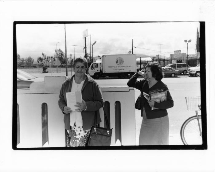

Thanks for the replies. I guess the reason why this doesn't appear on all the pictures on the rolls is that it's more apparent when there is some sky area or other similar tone to make it more apparent. I cannot imagine such under agitation would only affect some frames on the roll and not others. I'll do as Leigh suggested and fill the tank with water to a 1/4 inch over the reel and use that measurement. 120 reels almost reach the top of the tank, so with these, as long as the reel is covered there will still be enough room for the developer to get sufficient movement correct? Thanks again.

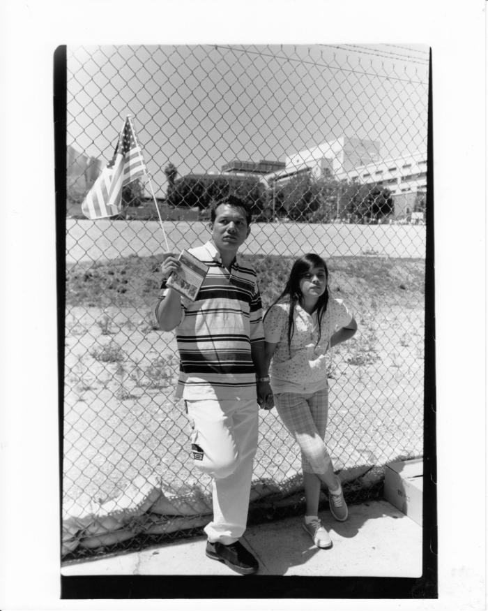

I made two contact sheets but it's hard to tell. It doesn't appear that these edges are constant. That's why I posted the second picture (of the lady in the buggy). It's the same roll but there isn't any sign of this in the print. I guess it depends on how much time I give the paper will determine if it appears. Here is another print from the same roll as the first two pictures. There is a slight difference in tone along the top but on the contact sheet there does appears greater. The sky density is probably built up more then in my other examples. Of course this could also be just the fold lock sleeves I keep my negs in now. The top folds over so this may prevent jus I'm off to work now so I won't be able to comment anymore until this Even. Thanks.
