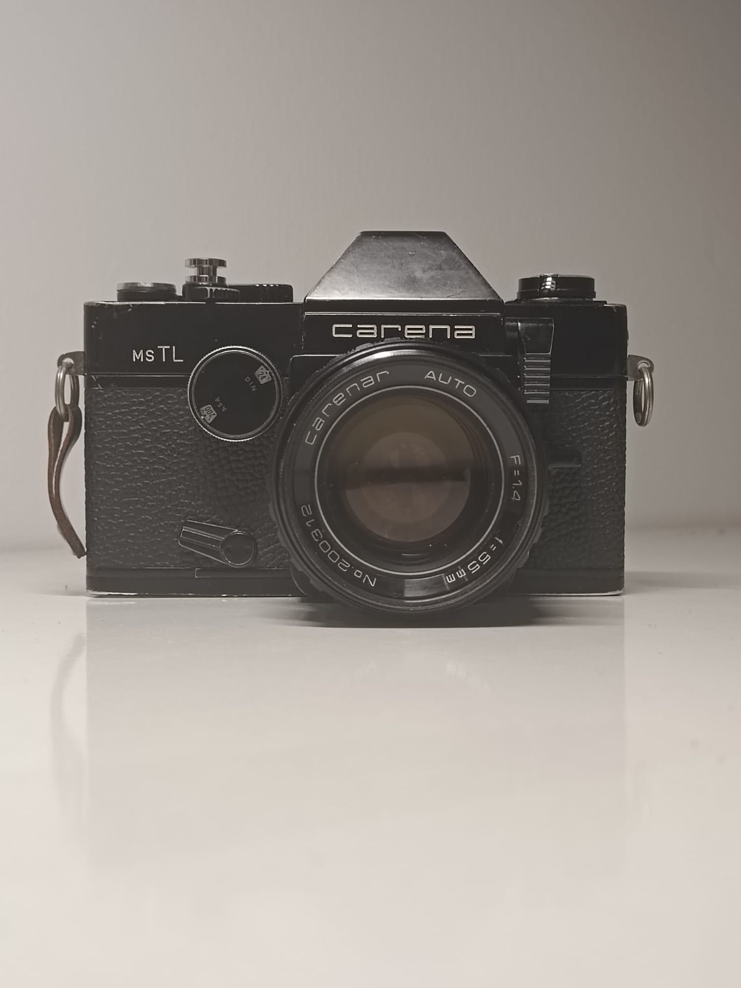

Hi everyone,
I recently found a Carena MS TL at a local flea market. I've tried to research it online, but there’s very little information available beyond some basic Google results and the user manual I managed to find. From what I’ve gathered, it shares the same body and mechanism as the Exakta Twin TL, but I haven’t found any listings or recent sales on second-hand platforms to get an idea of its value.
Currently, the camera is not in the best condition:
  • The lens is stuck and won’t come off.
  • The film advance lever is frozen.
That said, even though I’m relatively new to film camera repair, I’ve managed to fix a few basic models before and I’d love to restore this one if it’s worth the effort.
I’m not planning to sell it — I just want to know if this is a rare or special piece, and if it’s worth investing time and resources into repairing it properly.
Any help from someone more experienced would be really appreciated. Thanks in advance!

It certainly looks like a derivative of the Chinon CE series (Memotron) which took M42 screw mount lenses, but the dial on the face of the camera has me thinking GAF for some reason.
I think Carena was a brand that re-badged various manufacturer's cameras and didn't have any manufacturing facilities of their own.
Given that it's a Carena, it was undoubtedly sold under other labels -- as has been mentioned. Carena never sold a valuable camera -- as has been suggested. Doesn't "Carena" mean "bargain" in Scottish?
The lens, if you can get it off -- and it works -- is probably worth more than the camera!
As to repairs, your best hope is to figure out what camera it really is, for example a Chinon XYZ, and find a service manual for that camera -- but that could prove next to impossible. You could try some general camera repair books, but you'll need the tools, patience -- and skills might help. But what have you got to lose? You might learn a lot.

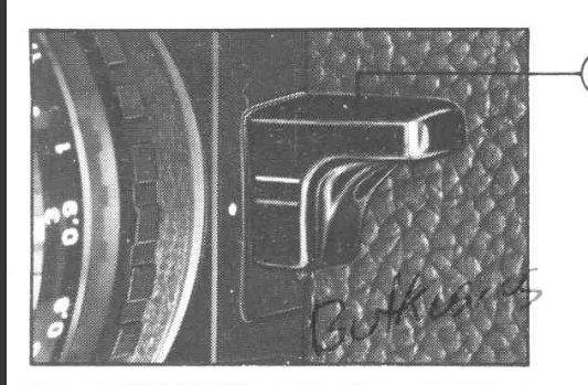

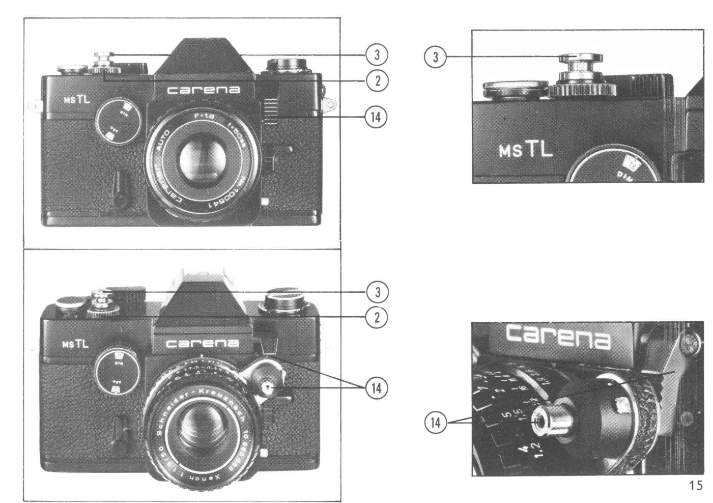

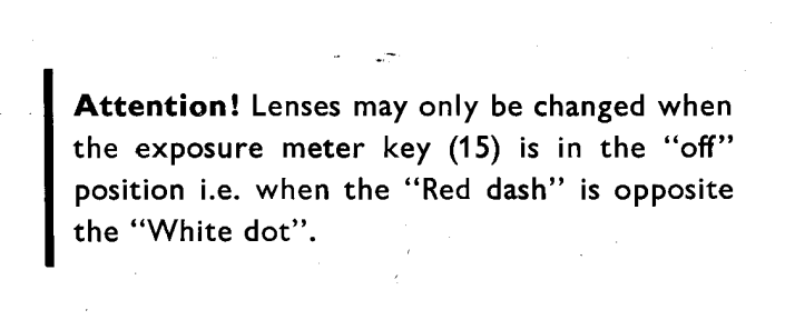

Looking at the manual, did you see this?
Also, the camera can take Exacta Bayonet Mount lenses, which definitely points it toward Praktica manufacture in MHO.

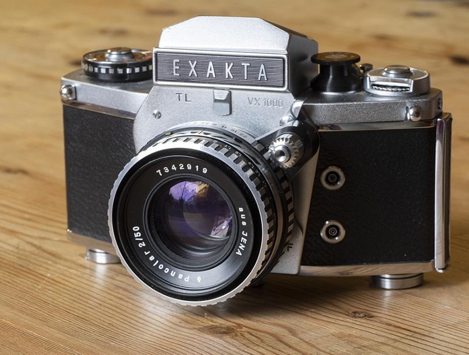

Search around in here and you might find it:
Yeah, I noticed that too. I think it could be one of the reasons why the lens is stuck. That switch feels a bit loose, so it might not be working properly. In fact, it has a small screw and can be taken apart, but once opened, there’s not much to see.
Thanks for the help! If I manage to make any progress fixing it, I’ll post an update here.
Is that an Exakta lens mount???
I'm not very experienced with this, so I might be wrong, but from what I’ve seen, I don’t think it’s an Exakta mount. It looks more like a Cosina/Chinon-type proprietary bayonet.
Looks like an Exakta mount lens to me -- and if it is, that should work in your favor, depending on what it is, and if you can get it off intact.
Hmm. I checked the manual, which can be found here: https://www.cameramanuals.org/pdf_files/carena_ms_tl.pdf
The body accepts lenses in Exakta mount and in M42x1 mount. The photo in post #1 above shows it with an M42x1 mount lens, probably made in Japan. An "E-type" ring must be used between body and a lens in Exakta mount. A "P-type" ring must be used between body and a lens in M42x1 mount. In other words, it has interchangeable lens mounts. Apparently made by Cosina, not, as suggested in post #7 above, made in the DDR.
