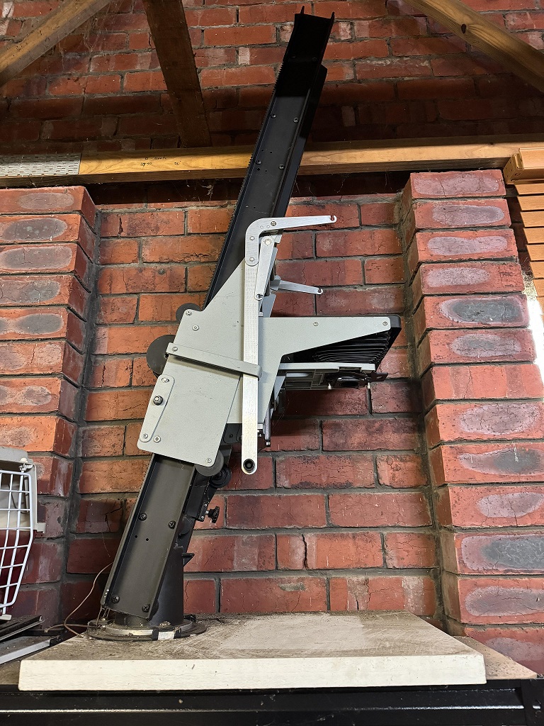

Hi Photrio!
I'm getting my first 4x5 enlarger ever on Xmas day this year! I purchased a lot for $100 AUD.
All I know is that it is an Omega enlarger and have these photos I've attached. I was wondering if anyone would be able to help me identify the rough model number of this unit before I can get it in my hands?
I'm also on the look out for a 4x5 film negative carrier and a 4x5" glass plate carrier for this system. If anyone has one available please reach out!
Thank you, Ryan.

The chassis in the first photo looks to be an Omega D5XL.

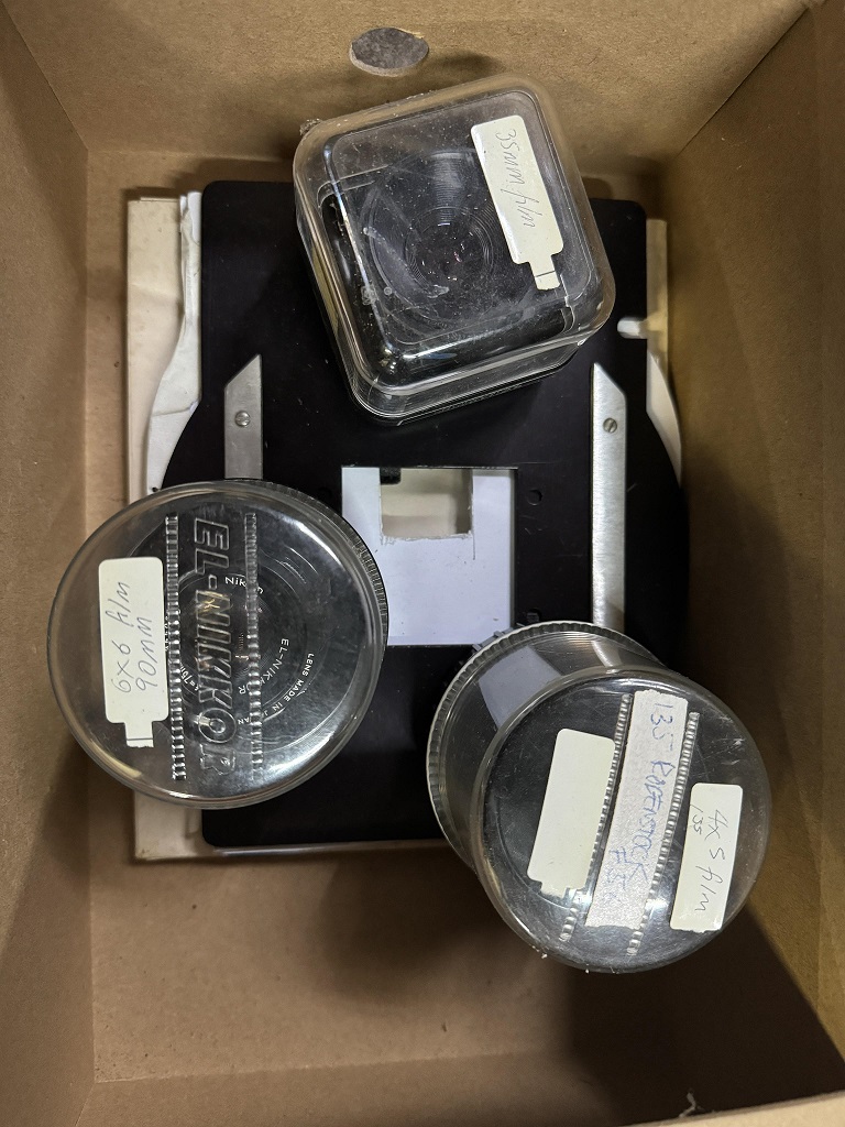

The black negative carrier appears to be modified or possibly homemade...for a D-series.
Nikon 75mm lens is for 6x6cm negatives.
The 35mm negative carrier appears to be made of cardboard.
Not much info to be seen about the lamp housing...sorry.
The go-to person for Omega parts and info is KHB Photographix in Canada.
Hope this helps!

looks like aÎ2 to me. yhis was also my first 4x5 enlarrger before I went to a Durst L1200.

The enlarger shown in post #1 is the Omega D5XL.
The model designation on the lamphouse refers to the lamphouse only.
The lamphouse shown in the lower photo is a condenser lamphouse. This contains an opal photo lamp and condensers. Depending on the model of condenser assembly you have, you might have to adjust the configuration of the condensers to provide proper light coverage when changing lenses to cover different formats.

The enlarger shown in post #1 is the Omega D5XL. The model identification is on the chassis—not on the lamp house. New users often confuse the head designation with that of the chassis.

Hmm.... I own a D5 and there's no ID on the chassis, only on the lamp housing on mine.

Check the back of the column - some if them are identified there.
But yes, it is a D5XL.
I miss my D6, and I enjoy using the D5XLs in my Darkroom Group's darkroom.

I've owned it for many years, the only marking on the chassis is the word OMEGA at the top of the column. I don't doubt some are marked, mine isn't.
As pointed out the ID label is usually at the rear of the column near the base. Oftentimes the label falls off, mine was sitting in the base mount; I guess someone put it there for safe keeping.
Definitely looks like a D5 Pro, probably the XL version judging the height.

That doesn't sound like a reference to a D5XL - which:
1) does not offer auto-focus; and
2) does not use lens cones.
I think you may be thinking of the D4.
Omega did indeed place a model label on at least one of its D5XL enlargers. I checked mine on 12-12-25. On the rear there is a formed-steel box-shaped reinforcement of 0.138” thickness that joins the left and right column rails together. It’s fastened to the side rails with 8 Phillips-drive machine screws. They appear to be 5/16” – 18 UNC. They are threaded into the reinforcement.
On the back of the reinforcement is a thin aluminum, adhesively attached 1.25” x 2.5” label. It’s about 0.013” thick. It reads:
“D5XL UNIVERSAL
CHASSIS
BERKEY OMEGA
SR. NO. 032593
BERKEY OMEGA
WOODSIDE, NY 11277 U.S.A.”
The serial number is lightly stamped with 1/8” tall numerals. I bought this new from Calumet Photographic in September 1988.

Hey Matt, do you know if it is it at all possible to file out a 4x5" negative carrier on a D5XL to get at least partial rebate?

I wouldn’t file the carrier. The 4x5 neg is big and would be very susceptible to bowing under the heat of the enlarger lamp. Not sure if a heat absorbing glass would help. I would recommend a glass carrier.
You can make negative carriers yourself from pieces of mat board. To be able to print the rebates on 4x5 negatives i made one and included a sheet of glass, onto which the negative is put: gravity keeps it in place. You have to be careful not to move the negative when using a self constructed negative carrier like this, but otherwise it works just fine. Also: when printing rebates on a 4x5 you are at the maximum negative size of the enlarger takes and you have to be careful not to clip any of the corners.
A second remark is about printing smaller size negative. I am not sure about the D5, but my D2V forces me to use a 75mm lens (or longer) when printing 35mm negatives on 13x18 and smaller paper, the crunching of the bellows not allowing the use of a 50mm lens, which would be the preferred focal length.
