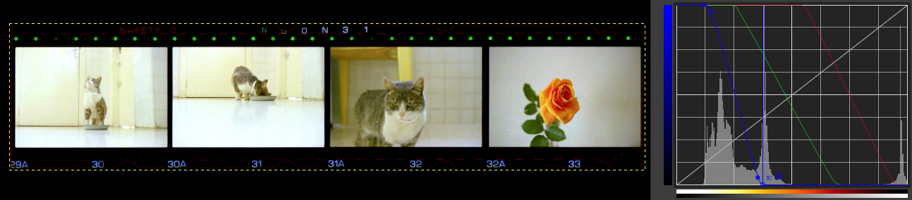

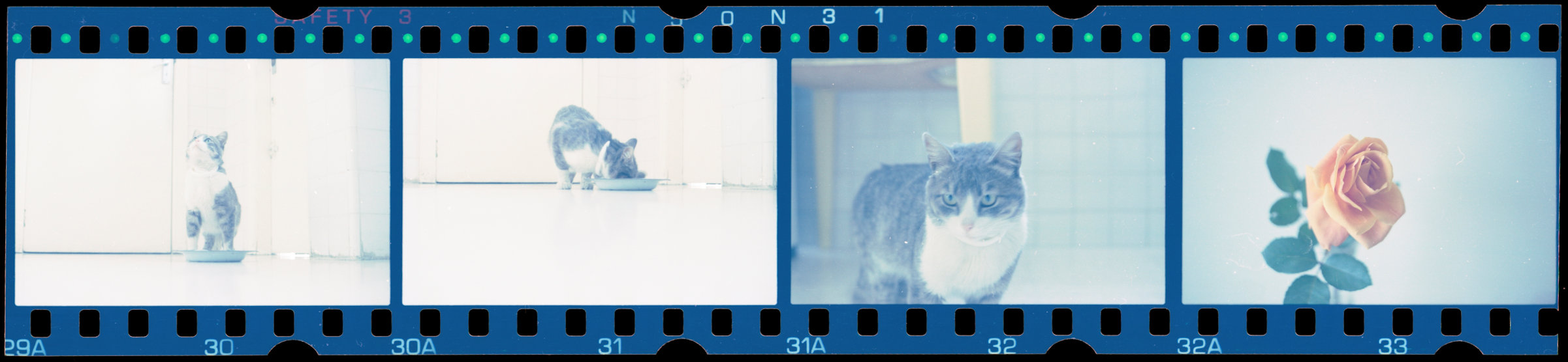

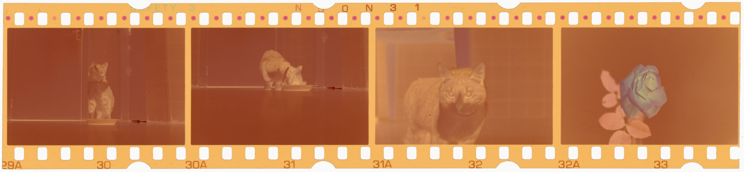

Here's an example of the same strip, one processed using the Silverfast Kodachrome mode, and as a generic (i.e. no film profile) negative. One thing that did pop up in the scan, but was not visible to the naked eye is the "SAFETY 3" legend on the top edge. Also, I did try to find a strip in which no blur was necessary in order to provide something with high fidelity. This is the strip best suited for that, although the curved notch overlaps the 5.

That looks to me like a "house brand" film, packaged for drug stores/supermarkets, etc.
In the '80's, a lot of that type of generic 35mm color negative film was produced by 3M/Ferrania.

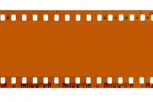

Ferrania made film had edge markings of either green or purple or orange dots. They also had edge markings of dots and plus sign in the same colour combinations.

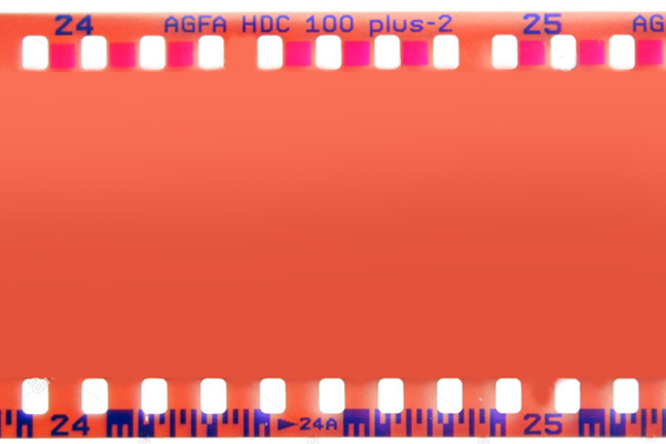

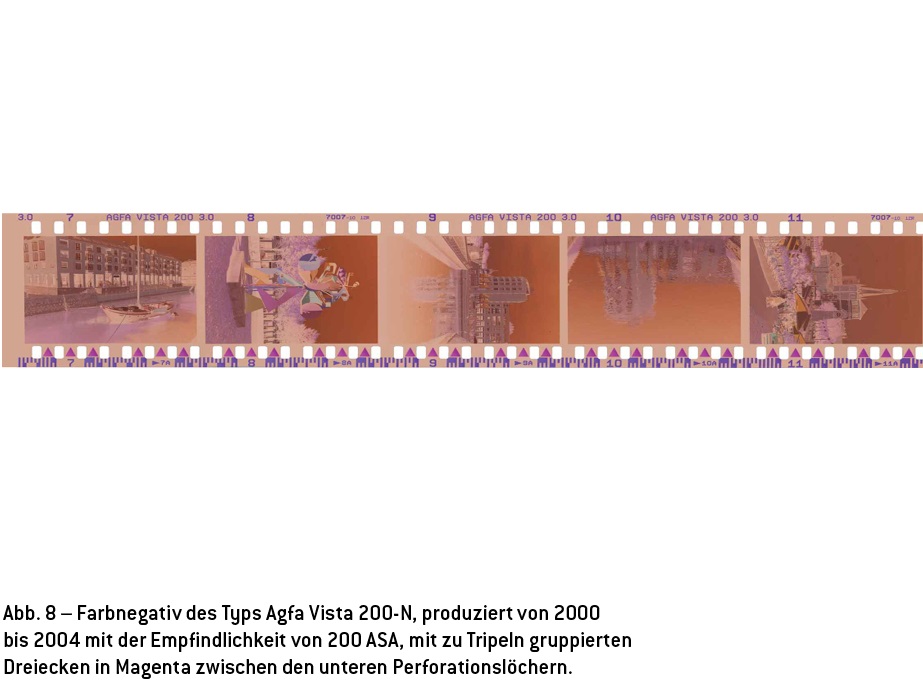

Agfa film, both branded and private label, had purple squares or triangles in the edge markings.

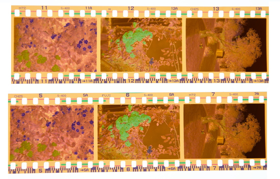

Fuji private label had the same markings as branded but with the Fuji name removed.
Konica private label edge markings looked very similar to Kodak negatives.
I hope this helps.
