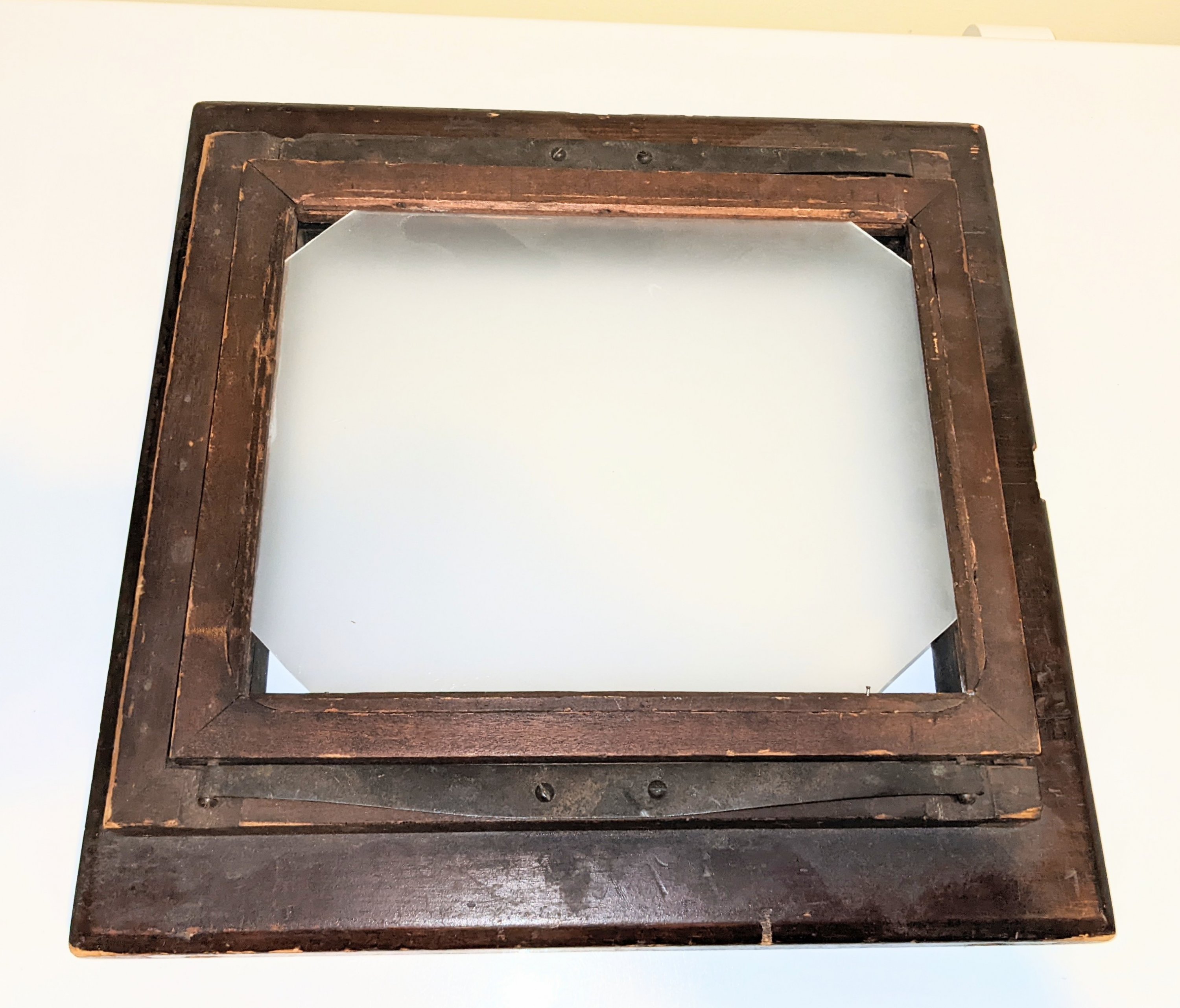

This is another back I got years ago, about 13-3/4" x 13-3/4" back.
It'll probably be easier to adapt the Rochester back to sheet film than think this 2nd back is a candidate.
Much thicker lumber like pine or poplar. I think trying a film holder is a the best place to start. It looks to be a bit less than 8" x 9-7/8"...maybe 7-5/8" x 9-7/8". Roughly 2" thick.
Two good size holes on two sides...my guess another form of rotating back for portrait/landscape changeover, that seats on a pair of pins on one side. Look at all familiar? Haven't found and markings yet.

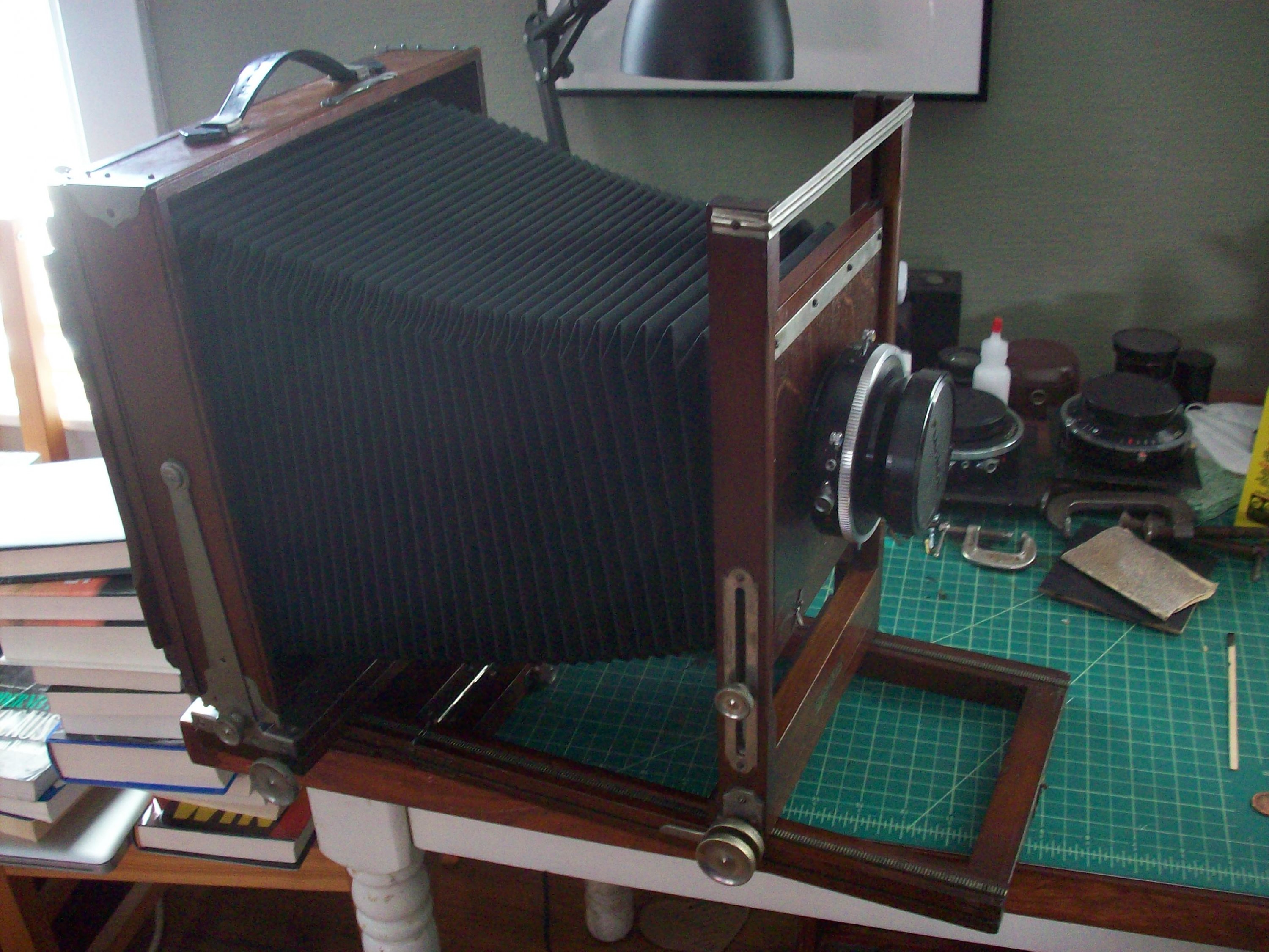

It's a British style field camera design but made in the US, these usually have a British name. This one is a Rochester Optical Co, "King Camera".

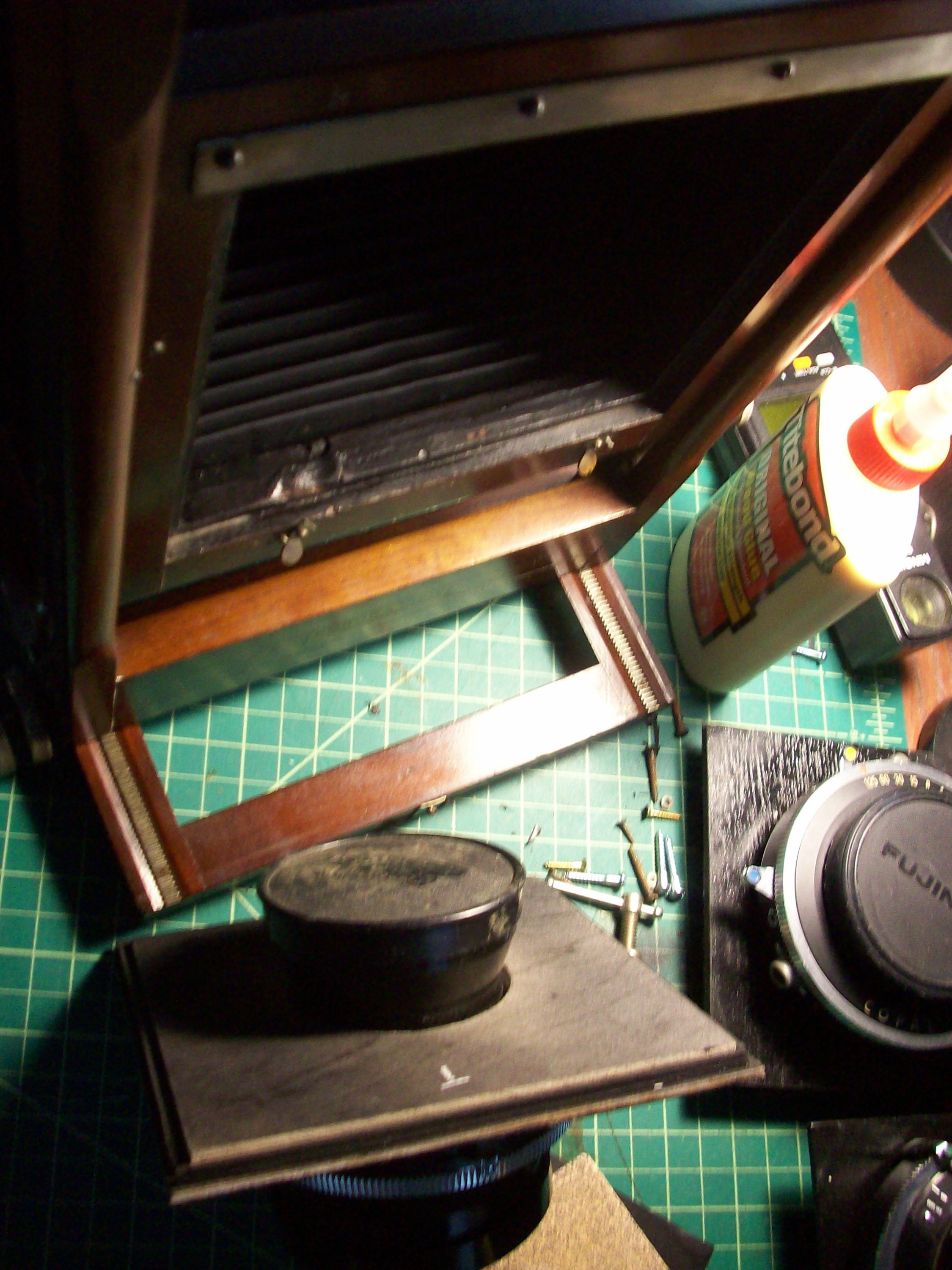

Hello: a couple topics separated by 1) & 2) headers

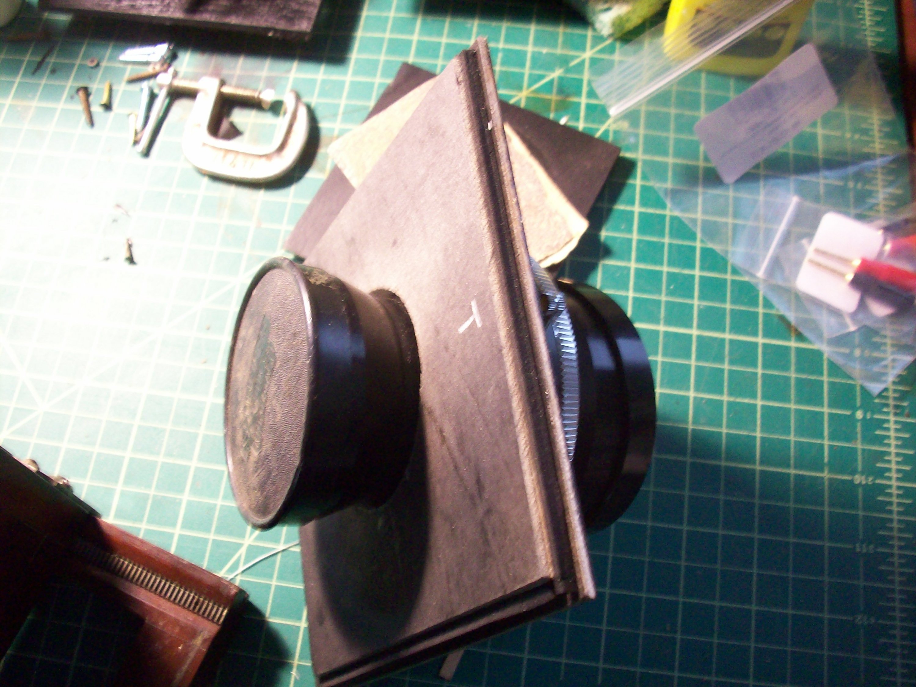

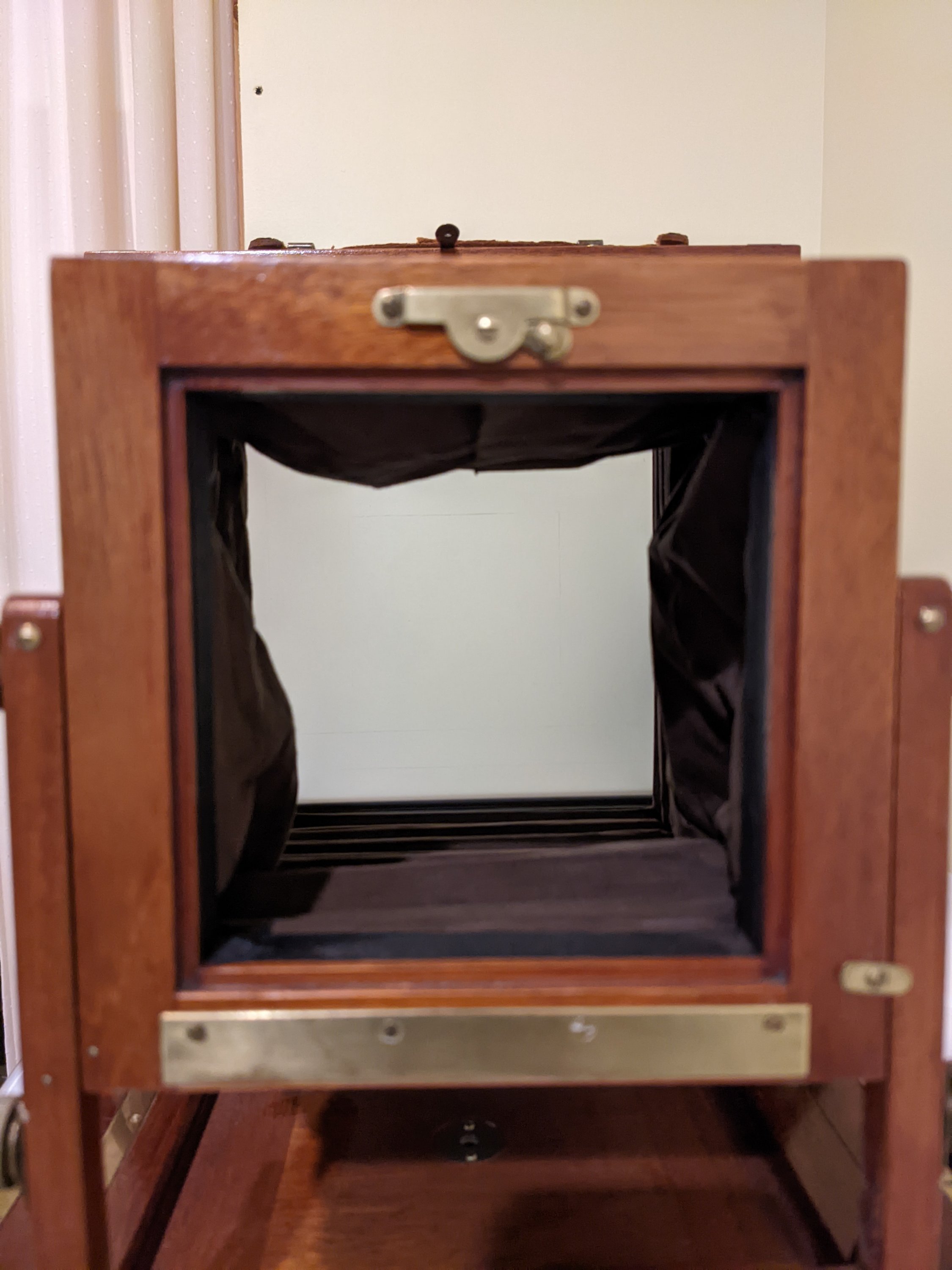

1) I have seen mentioned that the lensboards for this Rochester 'King' camera are '3-part', but have only seen the front of one in online camera pics, or other cameras missing a lensboard, like mine.
My front standard has a single 'step'. The widest opening is 4-1/4" square (4.24) and the next smallest opening is the same as the outside of the bellows frame, 4" square (3.97).
The depth of the 4-1/4" to 4" 'step' is a little less than 1/8" (0.112").
Plenty of lensboards have two square profiles. Might the third part be a little less than 4" square so there is a 'block' that goes against the front bellows frame, forming a minimum of two corners for light leaks to be blocked by?
Or, does anyone have a picture of the lens board typical of Rochester Camera (Supply or Company) view cameras? If my photo of the front standard is small enough I'll upload it. Oh, 2nd question, Topic 1...it look like someone removed and reinstalled the brass plate the edge of a lensboard would drop into...because there is no edge and the screws are offset from the horizontal center line of the brass plate. I think I need to reverse that plate.

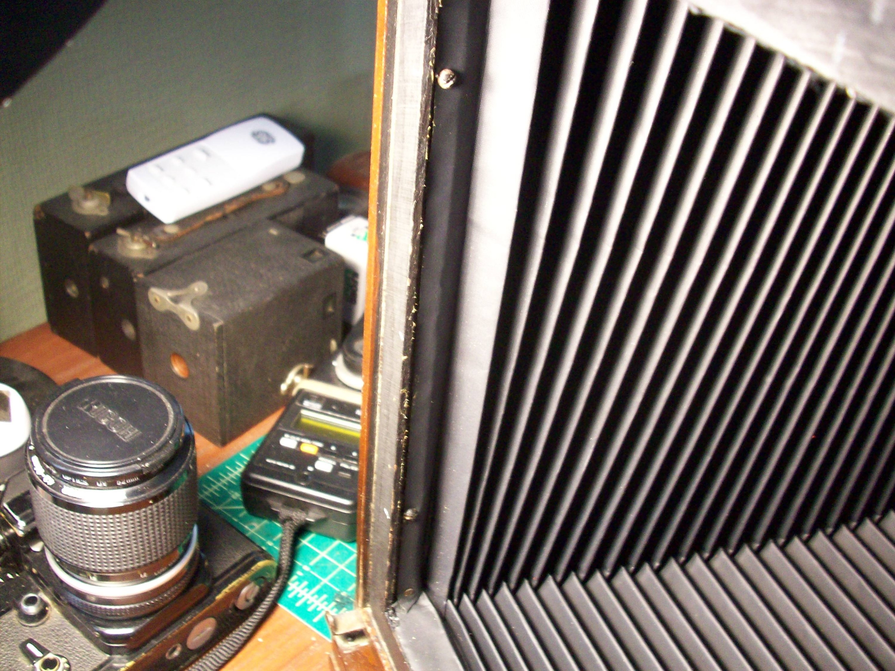

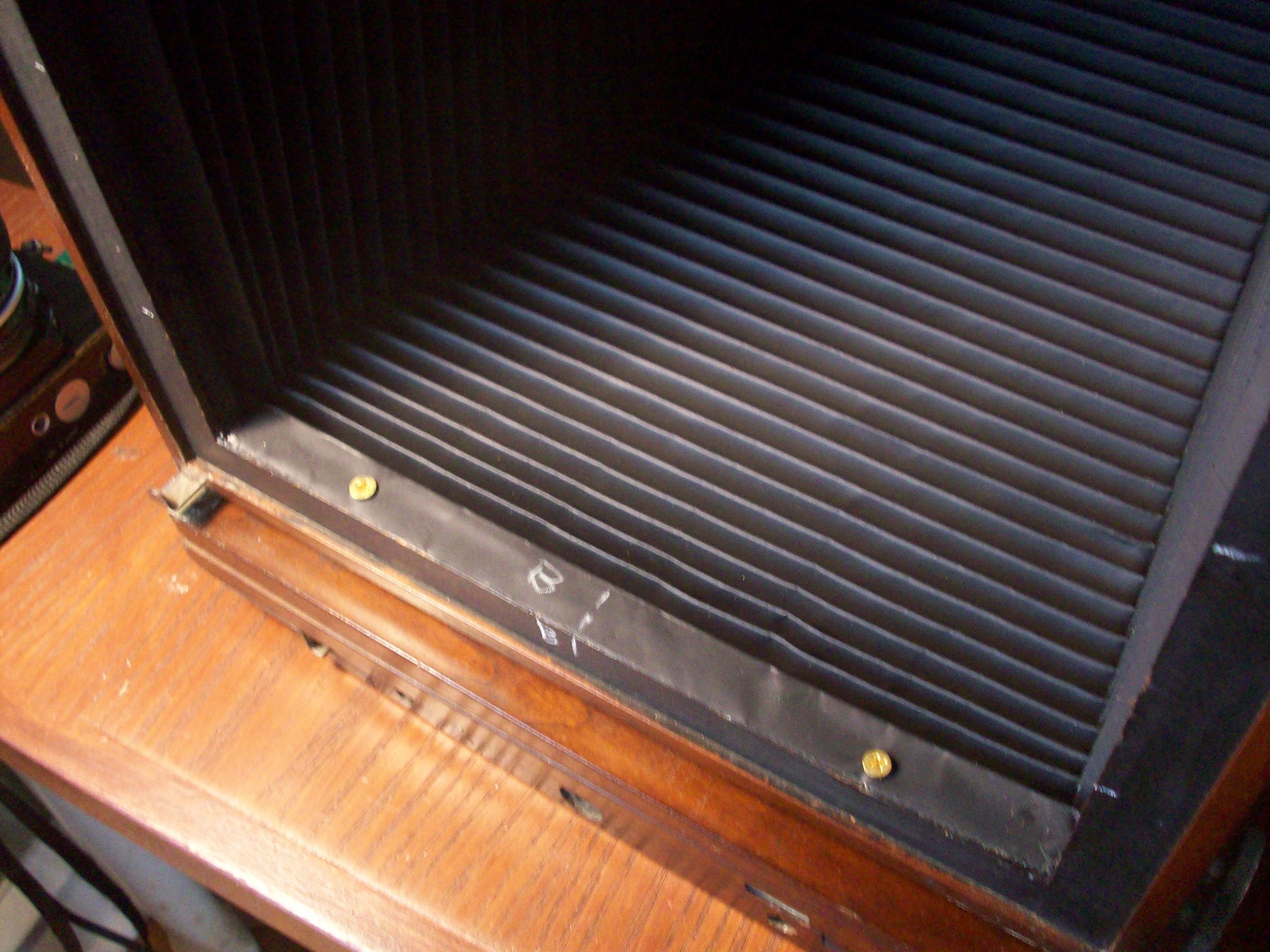

2) I tried measuring the bellows parameters for replacement last night. There is only one screw left holding the rear bellows frame...lost to the ages. It looks like the bellows was installed thru the back of the camera and the wood screws held the black bellows frame inside the thin outer profile of the camera 'body'. There appear to be small tacks or brads attaching the bellows to the frame.
The front bellows frame I haven't figured out how to (gently) access yet. Can't see the back of the front bellows frame, possibly due to deformation of the front pleats (sagging). It appears to fit into the front standard from the back, and similar wood screws would hold the bellows frame inside the front standard.
The bellows is square/symmetrical so the top and side pleats seem to be aligned. I am accustomed to rectangular bellows that creat confusion (for a beginner bellows analyst) about what counts as a pleat. On some rectangular bellows, a peak on one side aligns with a 'valley' on the adjacent side.
The only pleat counting confusion I'm having with this is that the front and rear seem to have distinct end 'flanges' that look like truncated pleats...they mount right against the bellows 'frames' which are really more like couplings...the bellows do not wrap around the frames...the ends are more 'finished' and mate against the wooden end 'frames' I am reluctant to call frames any more.

The "tack the bellows into a wood frame" mounting method is standard for these old wooden view cameras. New bellows are typically supplied with extra fabric on both ends to allow for mounting onto the wooden frames. My method is a combination of Pliobond and tacks to attach the bellows fabric to those frames. On the front, I usually wrap the fabric around the frame (going around the side and lapping over onto the front surface) then screwing the frame from the back into the front standard. Carefully done, this usually gives a good light seal. The back frame often mounts with screws from the inside and presents a wood surface to the ground glass frame where it snaps into the rear standard. I'm not sure what your "King" has, but I've just finished mounting new bellows on a Gundlach Korona , which has the fabric mounted to the inside of the frame, and screws going through the fabric and into the standard.
This sort of bellows mounting often requires a bit of woodworker's and/or upholsterer's finesse. In my Korona I had to cut some filler strips to make a better mounting surface on the top and bottom of the rear frame. And you may need a sharp knife to cut away excess fabric after the bellows are mounted. Take it slowly and plan carefully and it'll be fine. Your primary objective is to make a light-tight seal.
I agree about that brass plate on the front standard--it needs to be the other way up so it makes a pocket into which your lens board slips. Then the latch on top will hold it in place. I wouldn't worry about how many "steps" you need: two should be plenty. You need one up front the full width of the outer opening and another layer behind that to fit the inner opening. In theory that should give you a good seal, but I usually sneak a bit of felt or foam rubber behind the first step for insurance. I usually use 1/8-inch birch plywood for my lens boards, doubling up on the second stage to make it thicker and rotating the pieces when I glue them together to discourage any tendency to warp.

The best way to work on the frames is to remove them from the rails/bed. Take out the rear ground glass frame and unscrew the rear bellows frame from the standard and you may be able to access the screws in the front frame. Worst case scenario you might need to cut the bellows (but I doubt it). As far as counting the pleats, I've always just counted the top row. One pleat more or less never troubled me too much.
As far as the distance from the lens to the sheet of film, what you really want to do is make sure that the distance from the back edge of the rear standard (or front edge of the ground glass frame) to the film surface is the same as the distance from that edge to the front surface of the GG. Sometimes this is most easily accomplished by shimming the ground glass. Essentially, you're making certain that the image you see in the ground glass is the exact same distance from the lens as the film surface is. I take the back off the camera with the GG in it, lay a square metal rod across the (forward) opening and measure the distance from the front (frosted) surface of the GG to the metal rod. Then I do the same with a film holder (load it with scrap film to be precise) in the back and make whatever adjustments I need to make those distances the same.
