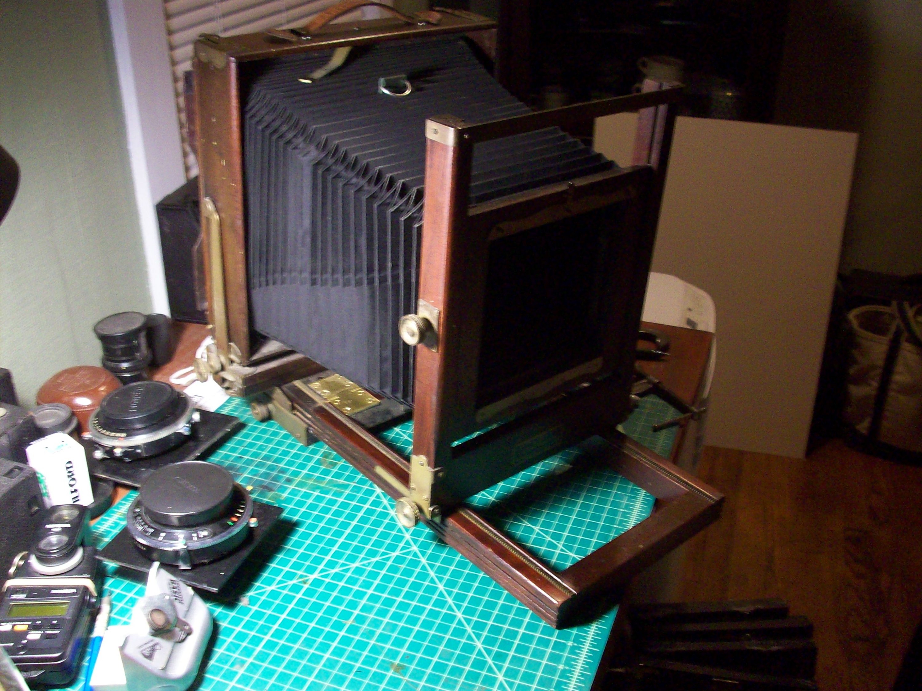

Hello-
I assumed Kodak/Eastman 2-D but just started looking more closely today. Part of a 4-generation family collection I got from a retired commercial photographer a few years ago.
Weighs just under 6# with no lens board, which might rule out 2-D, looking at other statements people have made about the weight of their 2-D kit (might include lensboard & lens).
I'll post one photo of the side view of the camera with the bellows extended rather than spamming the forum with many. Has six-digit number stamped in wood that seems consistent with Graflex family tree.
I just had a Betax 5 repaired for this and was surprised the lensboard space in the front standard is only about 4"x4"..I was inspecting the bellows to tell whether it's salvageable or I should look at replacements...and realized I may be wrong about it being a 2-D. There is no nameplate. I thought I previously found holes where the nameplate had been, but didn't find that today.

Nice camera and 5.15 lbs is 2.34 kg, which is quite a light camera for the negative size one would get. A lens board and lens, along with a film holder loaded with film, would probably weigh more than the base camera.

Most definitely not a Kodak 2-D. I have 2 of them--they are not of the folding bed design. They have double-track rails front and rear. This looks like a British or European design; in any case it's one I'm not familiar with. I expect someone else on the forum can place it.
Here's a quick grab-shot of my 8x10 2-D. You can see how it's different.

Took a quick cruise through Piercevaubel and got some ideas. It looks a bit like some early E. T. Anthony cameras but VERY much like a Rochester Optical King No. 2 (c. 1899):
http://piercevaubel.com/cam/roc/king.htm
Further checking in the ROC catalog shows that the King was made in 8x10 versions.
Edit: the similarity of the brass fittings is dead on. The little lens board top latch, the springs on the back, and the brass hinges that connect the bed to the rear standard seem to be a perfect match.

Going by the rear standard, I'm guessing it's a Folmer Graflex since that part (the rear standard) resembles a Century Universal even though the front standard does not

119115 is dated to a 8x10 2D Eastman View in 1922. Nothing else matches a 2D. The D on a Eastman/Kodak #2 view camera is for Dark finish.
I also see why there is no way to clamp the rack when the bellows is extended...there are two brass knobs missing.
Rail lock on cameras of this vintage is one of the knobs on the rail pinion screw in and clamp the pinion, loosen the knob to move the rail position.
I looked at the photos more closely and saw the stud next to the rail, likely standard SAE thread.

I have and regularly use a Kodak 2D 8x10. This is matching up. It's missing the little gravity plumb bob on the right rear standard.

But the Pierce Vaubel site (thanks for finding that, Tel) says Rochester Camera Co. King View was manufactured between 1895 and 1903, and is an English compact style. "Reversible by removable back"...whatever that means.
Well, that's interesting...I appreciate the help.
Would double dark-slide holders from decades later be compatible, or might this possibly have used glass plate holders or potentially different dimensions?
The Betax 5 en route back from Alphax-Betax Shutter Services hopefully fits the relatively small lens board. Gundlach Radar Anastigmat in that shutter was my assumed candidate...if it fits. Probably...the threads are smaller in diameter than the body. The shutter is so large, there's kind of a train wreck effect on the mind making one forget smaller subtle details..

The "Reversible by removableback" mean you can take pictures in either portrait (vertical) or landscape (horizontal) format by taking the back off, rotating it and putting it back on board.
