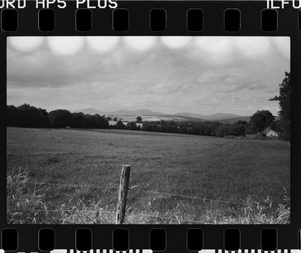

What camera? It could be the result of a defect in a vertical travel shutter. The phenomena is only occurring within the image frame. The edge markings are not impacted.
The camera was a Konica Hexar AF
O HanraHanrahan
Jul 19, 2011
22
ireland
Med. Format RF
In my experience, light getting onto tightly wound spools of film does produce marks that line up with the sprocket holes, but soft-edged streaks, not discrete round blobs. My money is on something preventing development, like air bubbles.
I'm thinking it could be along the lines of air bubbles. I just poured in the developer and didn't invert the tank.

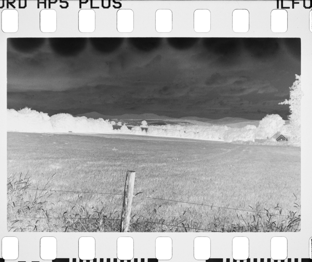

Your example is pretty unnusual. Frequently sprocket-hole turbulence causess a more subtle effect with less defined edges and alternating light/dark bands (see example of horizontal rotary processing with exhausted developer).

Except that the agitation was in a longitudinal direction from the film's perspective, so surge marks would never have ended up this way. So no, that's not it.
A light leak problem seems most likely to me given the extent of the defect.
A light leak would affect the area outside the frame edge. Thus, it cannot be that. Surge would increase density in the exposed area, without necessarily affecting the unexposed area. Thus, it is surge and cannot be anything else.
Certainly not. Those would show up as minus density. You've got excess density, and a whole lot of it, too. It's not impeded development - it's the opposite.

Apart from the order in which the 3 rolls were stacked in the tank, we also don’t know which way each one was facing: ie whether rotation would force chemical through the spiral, or spin it past. Either way, I’m puzzled how the dark blobs line up vertically behind the bits of film between the sprocket holes. With such vigorous rotation one might expect the marks to be slanted.
Please let us know what happens if you re-fix a strip as @koraks suggests.

Given the camera has a leaf shutter, there's nothing that could make that a result of the camera.
This doesn't look like air bubbles - it looks like bubbles of concentrated developer. Any chance some developer got on the reel?

I'm 100% certain that it's the mechanical agitation used here. Like many others I've used Paterson tanks for decades, in my case over 5, and processed many thousands of films, B&W, as well as colour.
There was a similar thread with a virtually identical example last year. It has nothing to do with fixing or bromide drag, which is caused by insufficient agitation, clearly not the case here.

I have a bit of an update.
I developed another three rolls using the same method with the "automatic agitaor/ pot stirrer" but changed the process slightly and the negatives came out perfect.
  • So this time I made sure the all three reels were facing the same way ( See photo below )
  • I poured in the developer and agitated the tank by hand inverting it for 1 minute and tapping the tank.
  • Then I put on the "automatic agitaor/ pot stirrer" and set it to the slower speed and let it stir for 6mins 40 secs. (It rotates clockwise)
  • I did the same for stop and fix.
  • The negatives came out perfectly developed.
So the first time I developed the film using the "automatic agitaor/ pot stirrer" I do not know what way the reels were facing.
I attached the "automatic agitaor/ pot stirrer", turned it on and then poured in the developer while the reels were being rotated / agitated.
I did not invert the tank or tap it.
So I'm thinking it had something to do with the direction the reels were facing.
Also the fact that I did not invert the tank.

Hello everyone,
I have recently developed 3 rolls of Ilford HP5 35mm film and on two of rolls have these black marks running across the top of 35mm negatives.
The marks only show on around 10 frames from one roll and around 13 frames on the other roll. The 3rd roll is perfect, no marks.
All 3 films were shot in the same camera.
I would greatly appreciate if anyone can identify what the issue is? Please see attached photos of the negatives.
Some information on my development process:
Developer Ilfotec DD-X 1:4
1000ml
9min @ 20° (-15% for continuous agitation)
7:39 min (Actual Development time)
Processed in a Paterson Multi-Reel 3 Tanks with Paterson Reels using continuous agitation in just one direction. (See attached video for the agitation process)
This was my first time experimenting with continuous agitation in just one rotation.
Kind regards,
Tadhg.
The Paterson System 4 tank is not meant to be agitated by twisting motion only.
The twisting motion is to be used only just after having poured the chemicals in.
Then you have to manually agitate the tank, by inverting it energically.
Please don't waste any more films on agitating unproperly.
