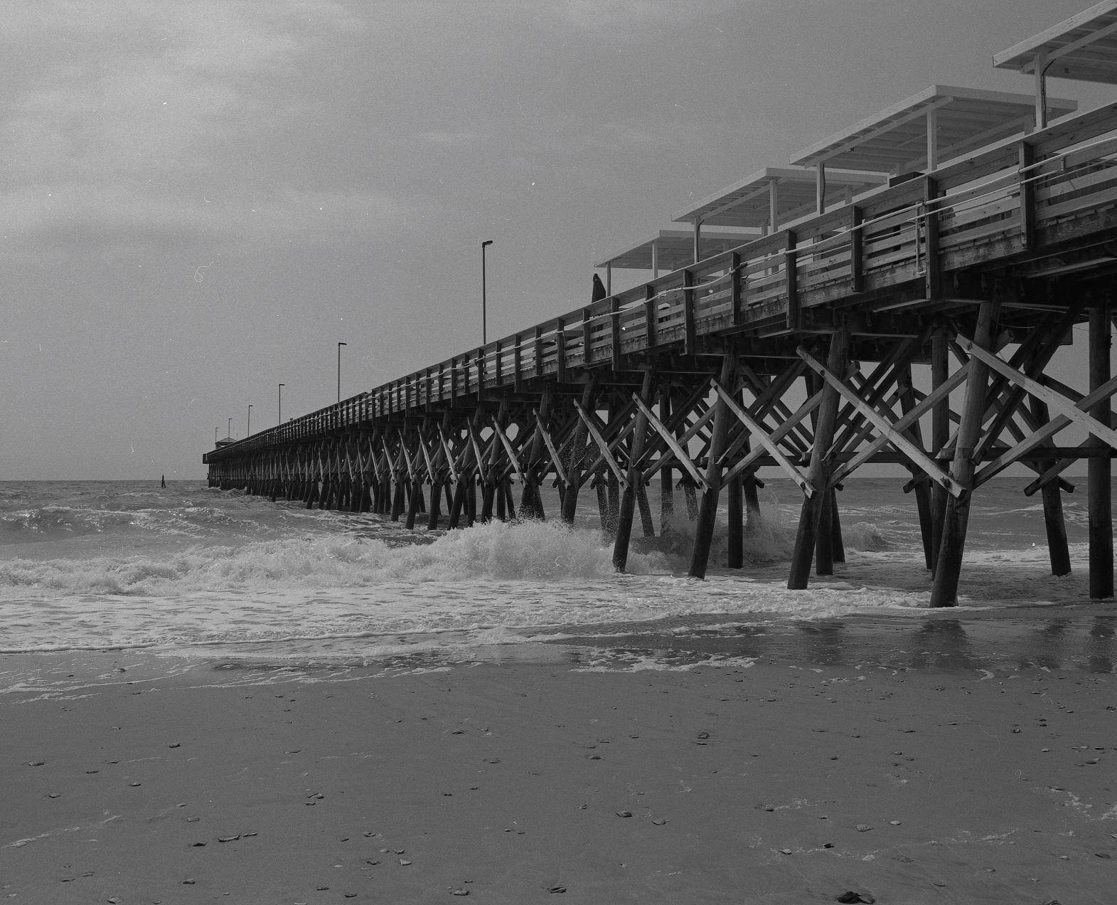

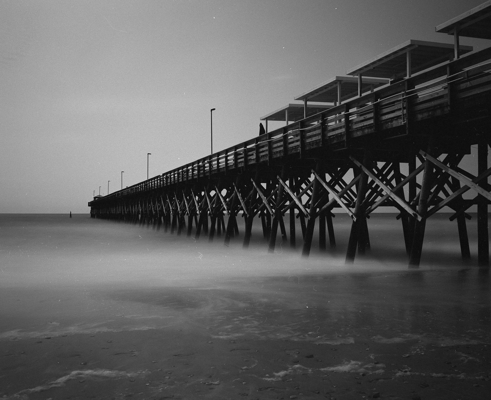

First, here is the cliche pier shot - long exposure then normal exposure. The long exposure was at around 1:30, I think. I did lose a some shadow detail (the morning sun was hitting that side of the pier pretty strongly), but I actually don't mind the look:

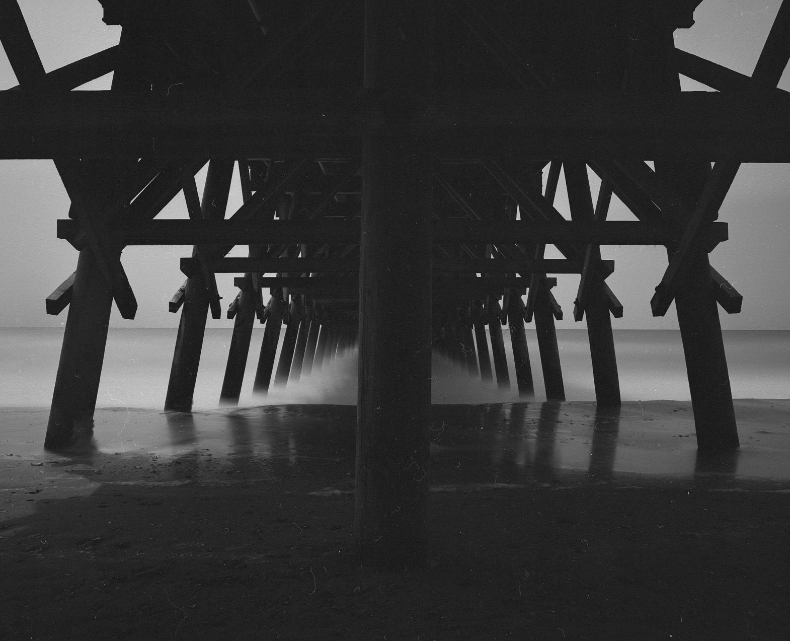

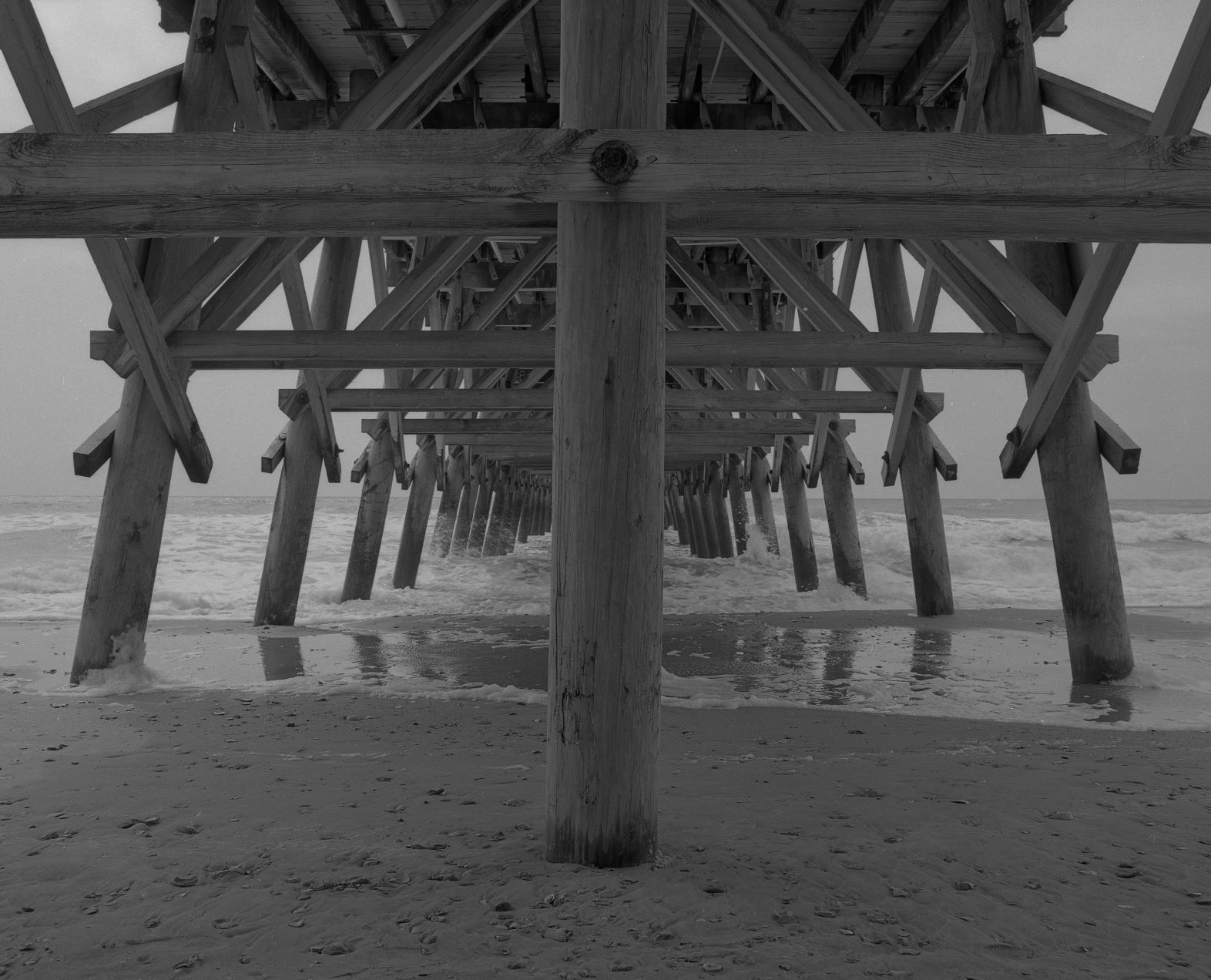

Next, I have a shot under the pier. I have lost all shadow information on the long exposure on this one. It was longer, at about three minutes, so the reciprocity adjustment would have been much more. I wanted to be one post closer, but I didn't have anything with me to keep the tripod from sinking as the waves hit:

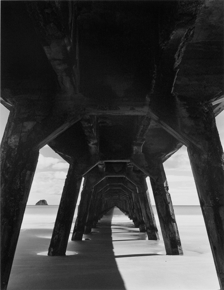

This wharf/jetty was taken on Kodak Royal Pan back in 1986, developed normally in HC-110 (16x20 silver gelatin print). I used a red filter and the exposure was at f64 for 10 seconds. My Pentax Digital spot meter gave me reading of 16 for the sky, 15 for the sunlit sand and 10 under the jetty. I exposed at 7 (3 stops for the red filter) -- putting the underside of the jetty on Zone V, basically -- or Zone III with two extra stops for RF, but I was not thinking that way back then.
The tide was receding and I moved the camera up once to keep my composition...but hurrying to keep the shadow line semi-centered under the jetty. The negatives is not particularily dense and printed easily. I burned the underside of the jetty a little as there was too much info there and I wanted a different 'mood'.
I used a red filter because I wanted to reduce the blue light that surrounded the underside of the jetty relative to the underside. That is what I remember thinking, and right or not, it worked. The print takes a couple hours of spotting -- I had high humidity static discharges happening during the next 3 months the exposed film rattled around in a film box as I rode my bicycle in lots of New Zealand rain. Still one of my favorite images from that 6 month trip.

That’s a great image. I don’t understand how you got any detail in the sky if it was six stops over Zone V. Did you burn it during printing a lot, or am I misunderstanding?
As I revisit mine, I am happy with the moodiness and am going to keep notes about how I did it (as suggested above) in case I want to recreate the look.
I think I understand... you are saying the red filter brought the sky down to VII, and the underside down to III...
What helped was the red filter, which brought down the sky's values relative to the underside of the jetty (and the values of the sun-lit sand relative to the shaded sand) -- so on the negative itself there is a smaller range of values than found in the scene. I only did a little burning of the sky values on the right-hand side to match them with the sky values on the left.
Also, I generally do not like overly dark and contrasty skies -- so the sky is printed lighter than what one often sees when other photographers use a red filter.

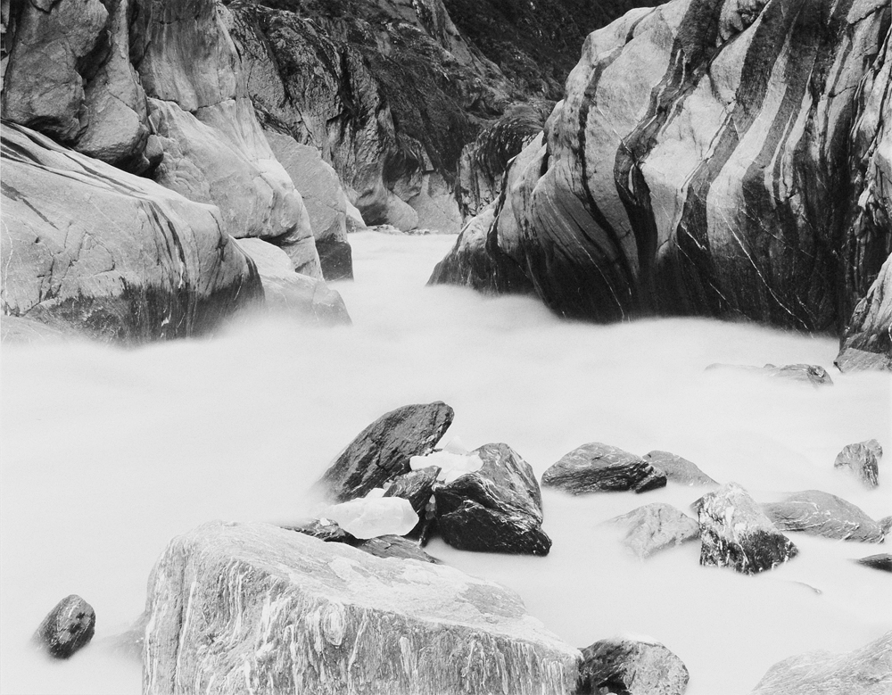

This image was made on the same trip with Super XX (200 ASA), using the red filter only as a nuetral density filter (overcast day and not much color anywhere in the scene). f64 at 4 seconds (9 -- 12 plus 3 stops for filter) -- water read 15, rocks 13 to 14 and the wet rocks 12, with the darkest areas at 11. Looking at my notes again -- I selenium toned this negative to bump up the contrast.
A little more contrast in the digital reproduction on-screen than in the actual print.

Another nice image! I recently got a 4x5 camera to dip my toes into large format and enjoyed it a lot. I have yet to have a chance to take it out for a real (deliberate) photo, though. I wanted to make sure I could load, expose and develop properly, which I was able to pull off. Hopefully I can get out with it again soon.
I've used Cokin mounts and screw on filters for medium format and 35mm. How do you mount filters for your large format? Or do you just hold the filter up to the lense manually?
Modern lenses have filter threads, so I use the normal screw-on filters. The second image was taken with a Caltar IIN 150/5.6 that takes a 49mm filter, while the first image used the Computar 210/6.3 and takes a 72mm lens.
