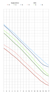

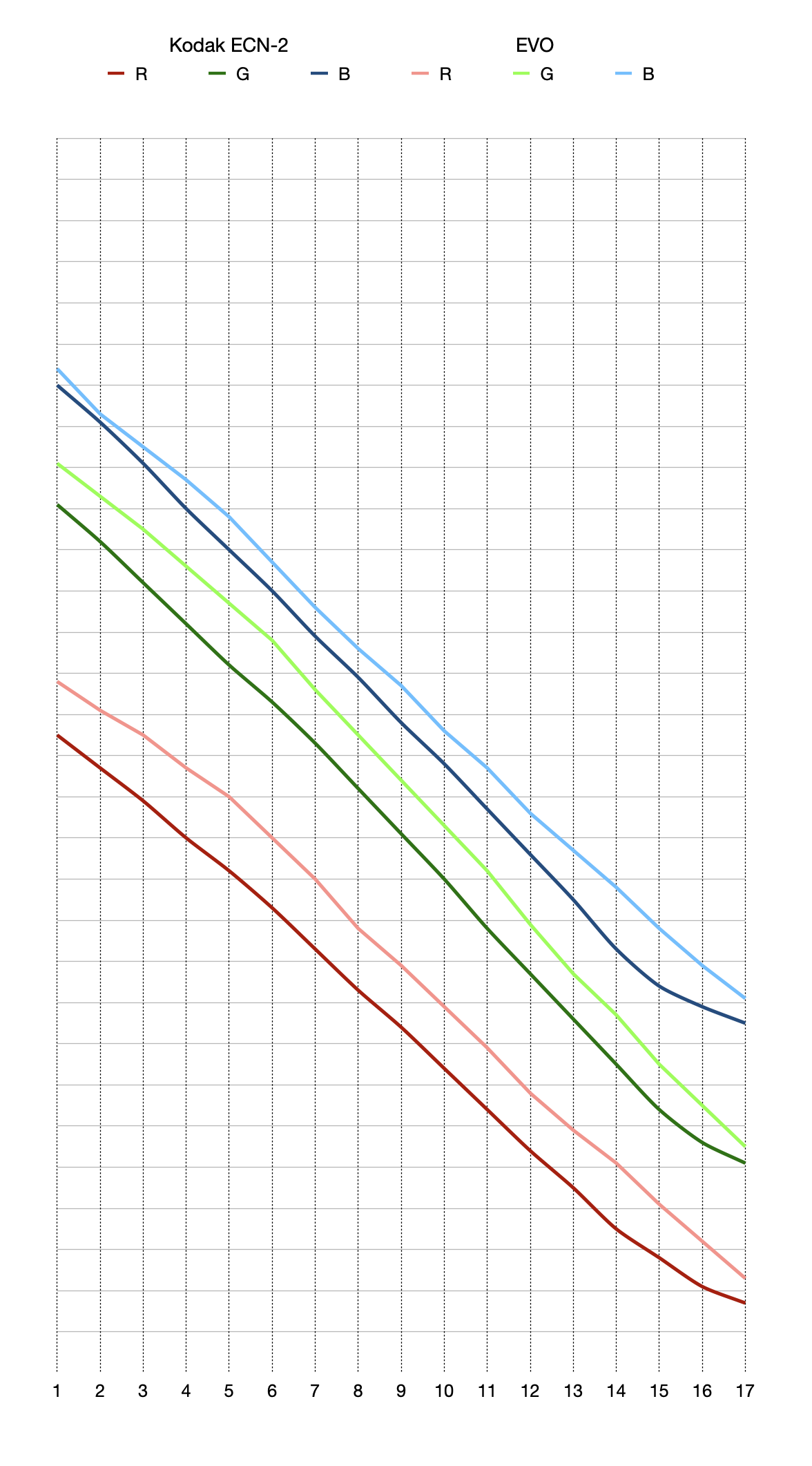

Also, I once learned about a photochemical called "EVO". Out of curiosity, I tested it using KODAK VISION3 Color Negative Control Strips and graphed the 17 density blocks. Compare it to the Control Strips reference strip (darker line)
It is important to note that I generally do not recommend changing potions or processes to achieve a certain purpose.
I believe Kodak's engineers must know film and photochemicals better than we do, and following a standardized process can take us further. Even if the color is made better by changing the formula or process, it is not necessarily universally applicable to all film, and maybe disadvantages on the other problem.
