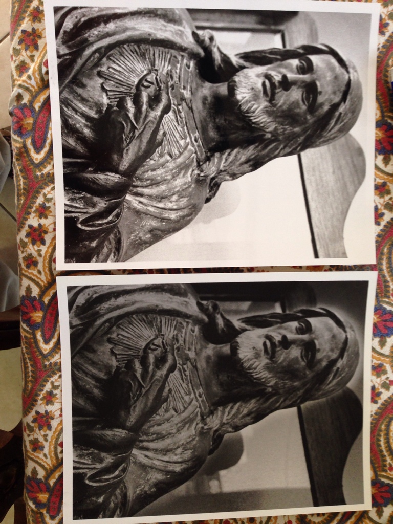

Hello everyone, I have a stupid question. I am pretty new at enlarging and I am still confused about some of the mechanics. The picture above on one side is a straight print with what I thought was the best exposure for the statue and on the second I tried to burn the background significantly.mmI took my test strip print and cut out the silhouette do the statue, espoused my basic exposure and then did another exposure while holding the cut out slightly above the paper and slightly shaking the cutout while the enlarger was on. my question is if this is the correct way of burning the area and how do you avoid the halo that I ended up with.
Second question is if you know of a book that explains this basic technics.m I just got a book on printing technic he's filled with really cool prints and printing diagrams but no illustrations of how to actually hold your hands to dodge etc, etc. the duck bill and duck's ass reference were not very helpful.

Doing the silhouette thing does work but after about 2/3 stop of burning, you will start to see a halo. You obviously gained some exposure on the statue as well so maybe try adding some cardboard to the cutout.
You could start with a half stop of burning just the edges. Take a card, cut a sawtooth pattern in one side, and use that to burn. Then try the cut out.
Or, learn lighting and get it all right in camera. Then the negs print themselves. :cool:

In this case, what you're actually doing is called dodging, since you're using the cutout to hold back light from reaching part of the image. As Parker noted, try using an opaque material like cardboard as it appears some additional light did spill thru to darken the statue. Don't let the shadow of the cutout go outside the edge of the statue - that's why you ended up with such a severe halo effect
There are tons of good books out there on darkroom printing technique - I could recommend Ansel Adams' "The Print", David Vestal's books, or Bruce Barnbaum's "The Art of Photography".

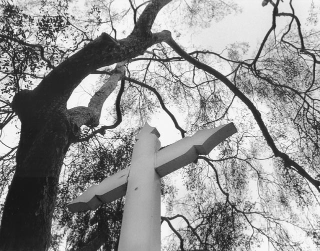

It does take practice, but you'll get better with time and develop your own technique. I also use a sawtooth pattern along the edges of many of the masks I cut out. I hold it a few inches or more above the easel, slowly moving during the exposure. Here's one image where I dodged the cross. It was much darker in the straight print and I wanted it to stand out more.

What jimjm said and get Tim Rudman's book The Photographer's Master Printing Course. One of the best, if not the best books on printing I have come across.
To dodge and burn competently, be prepared to use a lot of time and paper.

It sounds like the silhouette you cut out was near the size of the image. I'd think making it smaller may help. You could see the area better while you worked, and it would be easier to keep the mask within the boundaries of the statue.

Yep - like Truzi mentioned, the cutout needs to be smaller than the corresponding area on your print. The smaller the cutout, the higher above the easel you can hold it, thus allowing you to watch the shadow it casts on your paper. Also, the edge of the shadow will be more diffuse and allow you to blend in your dodging/burning easier.

+1 on what Parker Smith said. The paper you used for holding back the statue must have been partly translucent: in the second image, the statue is darker and lower contrast. I buy at an arts & crafts store some medium weight paper that is black on one side (to block the light) and white on the other (to see the projected image and help me position the cutout). Also, a sheet of photo paper, exposed to light, and developed, can be used for cutouts.

I rather like the first print more and so I take it and edge burn a bit.
I don't think the Statue will stand out if background is dark, but you have done a great job by printing the negative.

One thing not emphasized enough above is blending the edges when dodging or burning. I like dodging tools with sawtooth edges and I hold them high so there is a large penumbra (half-shadow where a bit of enlarger light gets through) and move them up and down when dodging to create a smooth transition from the dodged to the undodged area.
Still, it really helps to recognize conflicts between your visualization of the photograph and the actual reflectances in the scene before you expose the negative. This is what the Zone System is all about and will help you to decide how to expose/filter/develop the negative or maybe not to take the shot at all (or at least be prepared for a tough time in the darkroom...).
Dodging, burning, bleaching, etc. are all good tools, but usually using any of them to an extreme results in obvious manipulations and distracts from the expressiveness of the print. Sometimes it's better to accept the picture for what it is... If you don't like it, then move on to something else. Life is much to short to waste time on really impossible negatives, especially when there are so many great photos waiting to be made!
