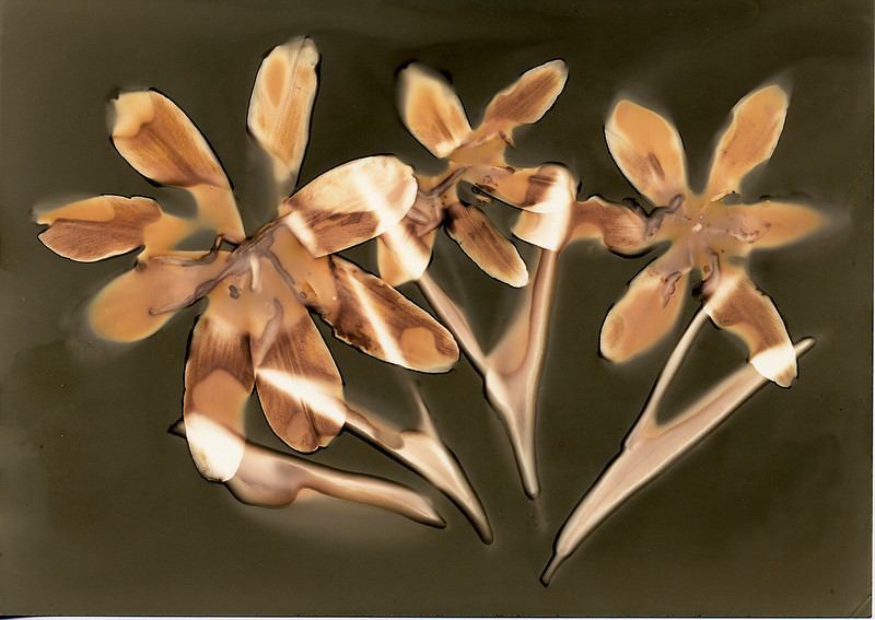

Hi @bsdunek, hope you'll see this post. Your suggestion for unfixed Lumen print is interesting and I'll give it a try. Thanks.
Which sepia toner did you use for unfixed Lumen prints and at what strength? Does toning this way result in fog and is there a way to deal with it?
BTW your Lumen prints are very beautiful! Was this one toned in Sepia by any chance?
